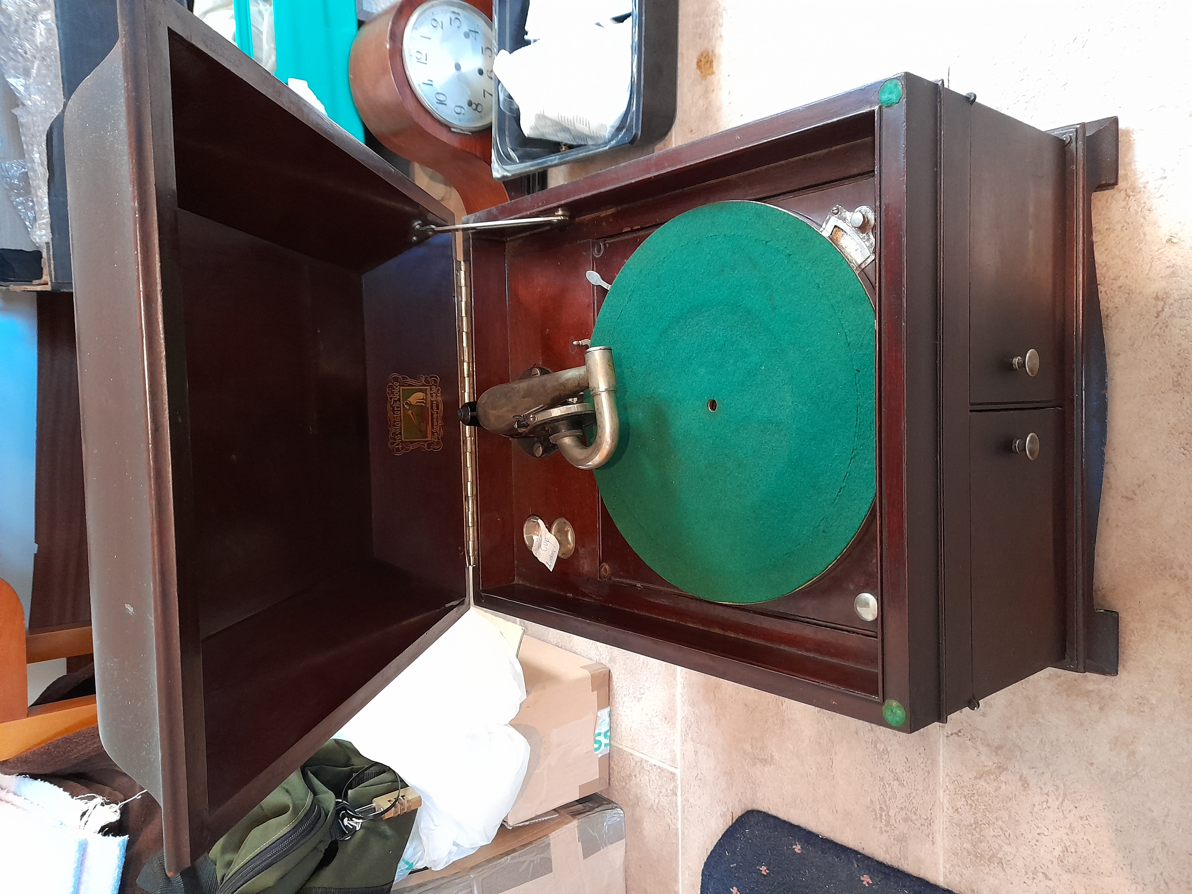

I am working on a HMV model 126 at the moment with a no.32 motor. Unfortunately while testing the the motor got VERY noisy.

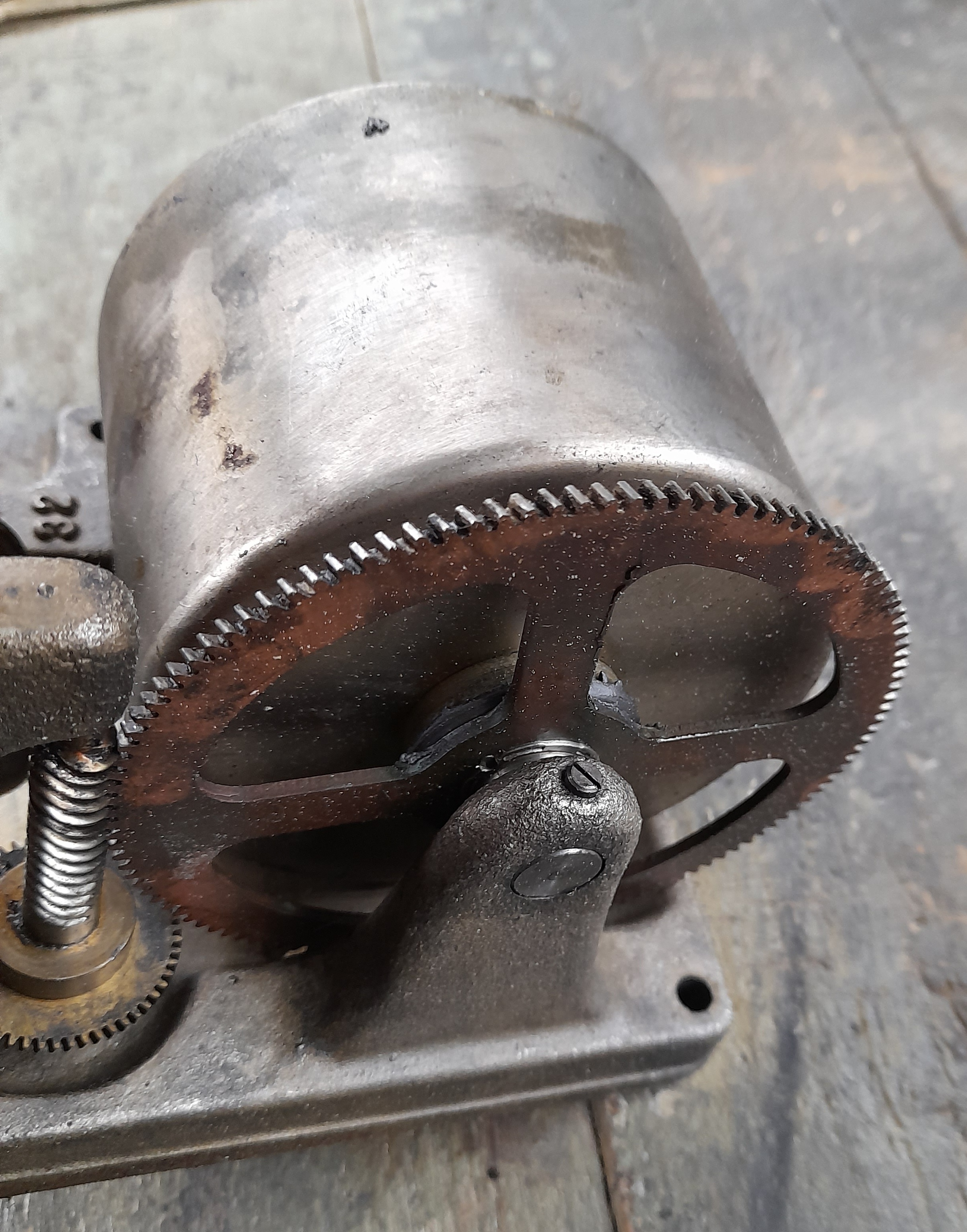

I had been sparing with grease on the large drive gear on the mainspring drum and on the spindle worm gear that meets it and the noise appears to coming from this side of the motor.
I took the motor apart again and took the steel bar that acts as a axil going through the motor case and mainspring drum, re cleaned and put a little grease in there to replace what i had removed on cleaning. Then I went heavy (relatively) on the grease for the drum gear and spindle worm gear.
This seemed to have the desired effect and all was nice and smooth and quiet again for testing.

Prior to greasing, did you do anything to clean the gears? Maybe it's just the photo playing tricks, but it all looks filthy. Also, the governor worm gear looks dry, (as does the spindle shaft). Use oil there or a very light grease. Did you oil the ends of the governor shaft? The governor friction leather can squeak also, due to dried, sticky oil on it and on the governor friction disc. Clean the friction disc & leather with solvent. Lightly sand the face of the leather to remove the glaze of dried oil, then lubricate it with light oil.

I should have explained that the pictures are PRIOR to cleaning.
Unfortunately it is none of the above mentioned, spindle ball bearing in place doing its job.The noise is very much a metallic noise and typically it has not come back again despite a lot of testing since it s last appearance
The long bar that act s as a kind of axil going going through the cast case sides and drum had a little scoring on one side that I smoothed off and greesed before reassembly. Possibly the inside of the large drum gear was a little rough, I m not 100 % sure as I only cleaned and greesed it, I don't know !!!

Hopefully, the noise won't come back. If it does, look more closely at the fast spinning components. The spring barrel shaft, (axle), will not be the source of a metallic squeak due to its very slow turning nature.
