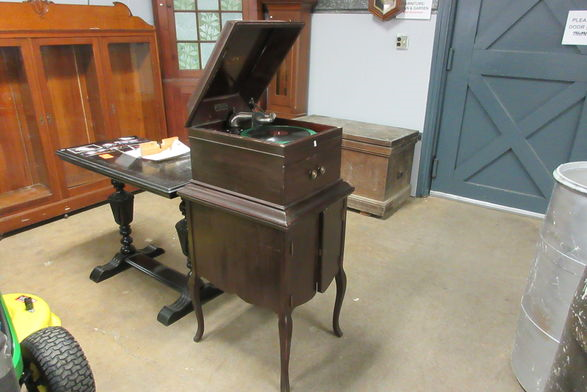

Picked up this Victor VV IX last night at auction for $85. Pretty nice shape with the base cabinet and it sounds great. Looks to have been used very little. It also came with the original sales receipt which is nice.
However after about 15 winds of the handle it feel like a spring is slipping. I disassembled the spring barrel and it was loaded with hard clumpy grease. Sound like the slippage problem?

If you wind and do not reach the end of the spring you have a broken spring somewhere in the middle of the spring. If you can give it a full wind and it thumps you have hard grease. Regardless, it was a good buy for $85 and the original receipt is a special bonus.

Looks like you have a late-model IX with the "fat tone arm" and no. 2 sound box. Nice find, especially with the base cabinet. Happy listening!
