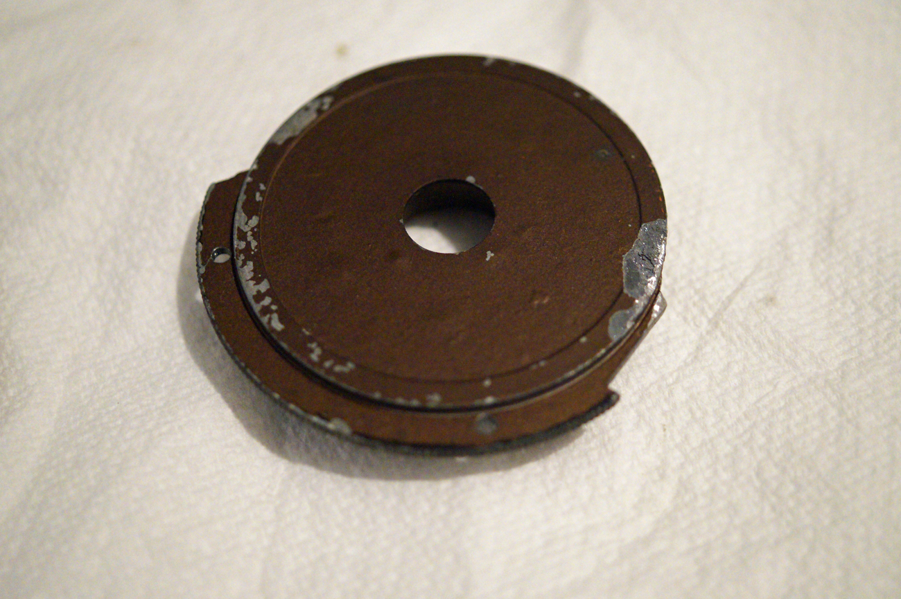

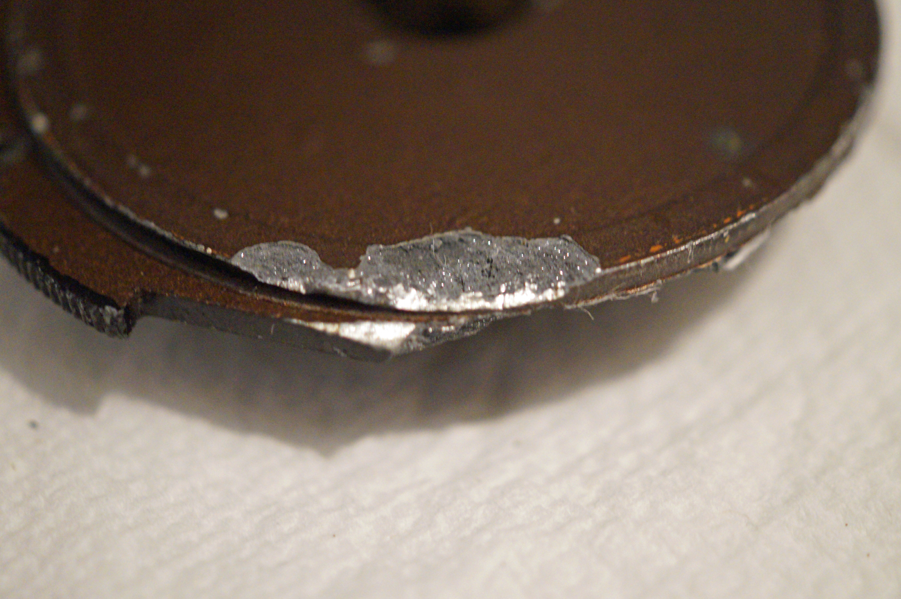

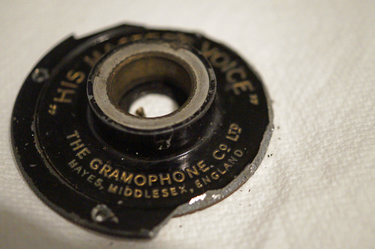

Please see the three photographs 'below'.
I thought the one which was broken and I destroyed
However, once opened it seems to have a very thin 'coating' of brass and the rest of it appears to be pot-metal ?
I thought it would be solid brass ?
What are your thought please ?
- epigramophone
- Posts: 5815
Re: HMV No:4 Soundbox question.
That is indeed pot metal. Clearly the "guide" I read about is not infallible.
