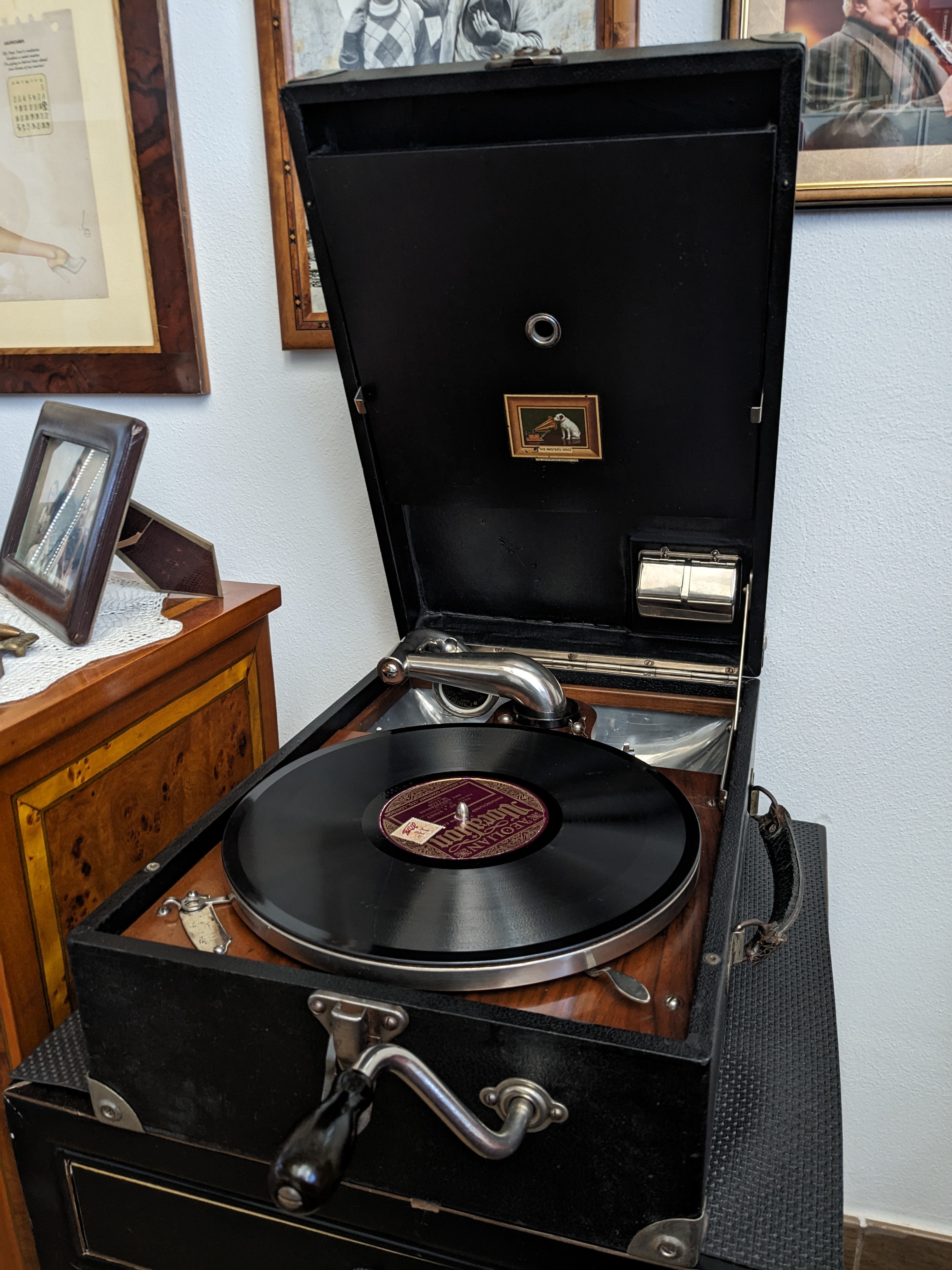

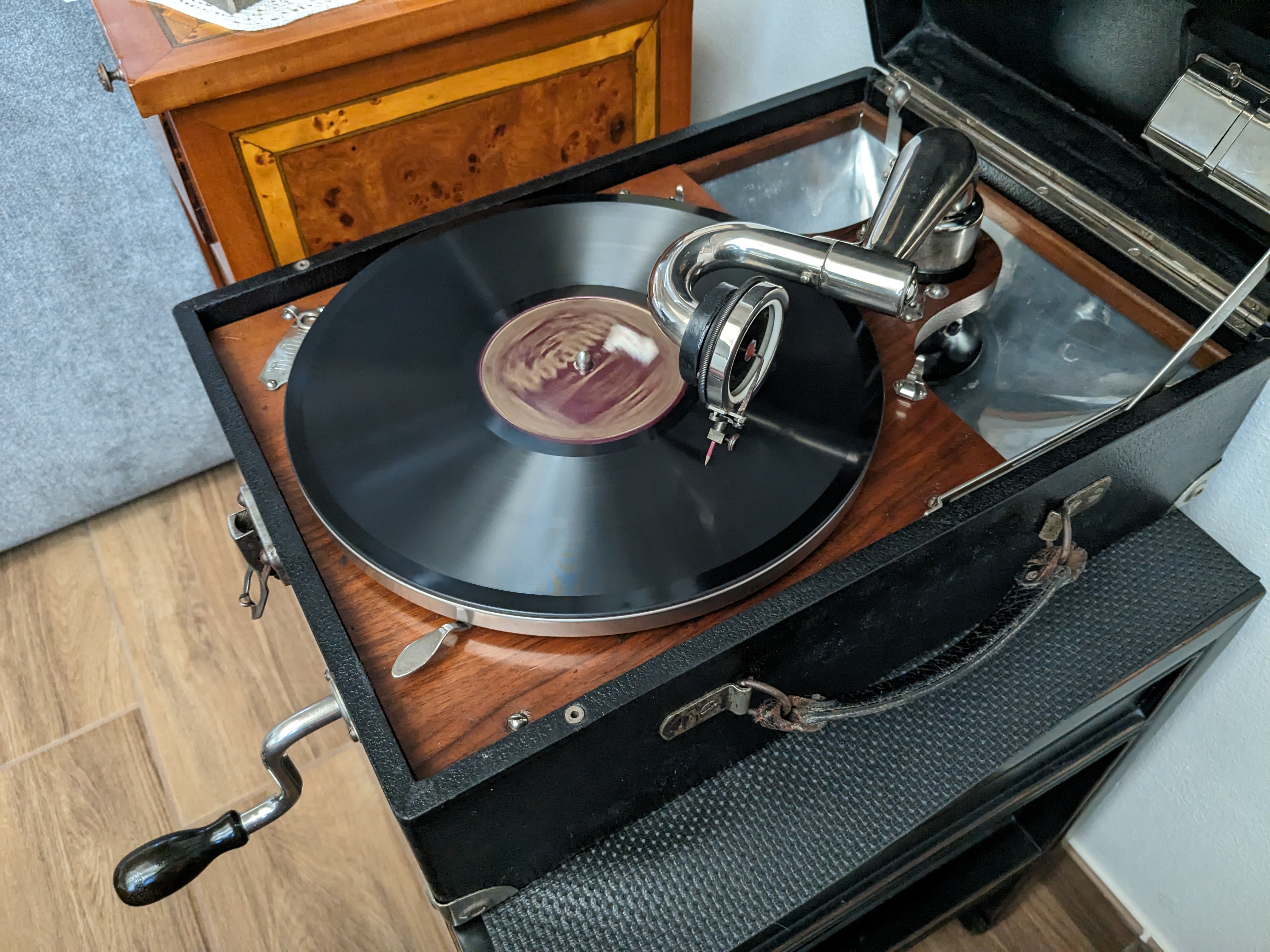

Good evening,
pardon me for crashing into this thread after a long and unjustifiable absence, but I thought that adding a few photos of the model 100 I purchased last spring could be useful for the sake of additional information and comparison.

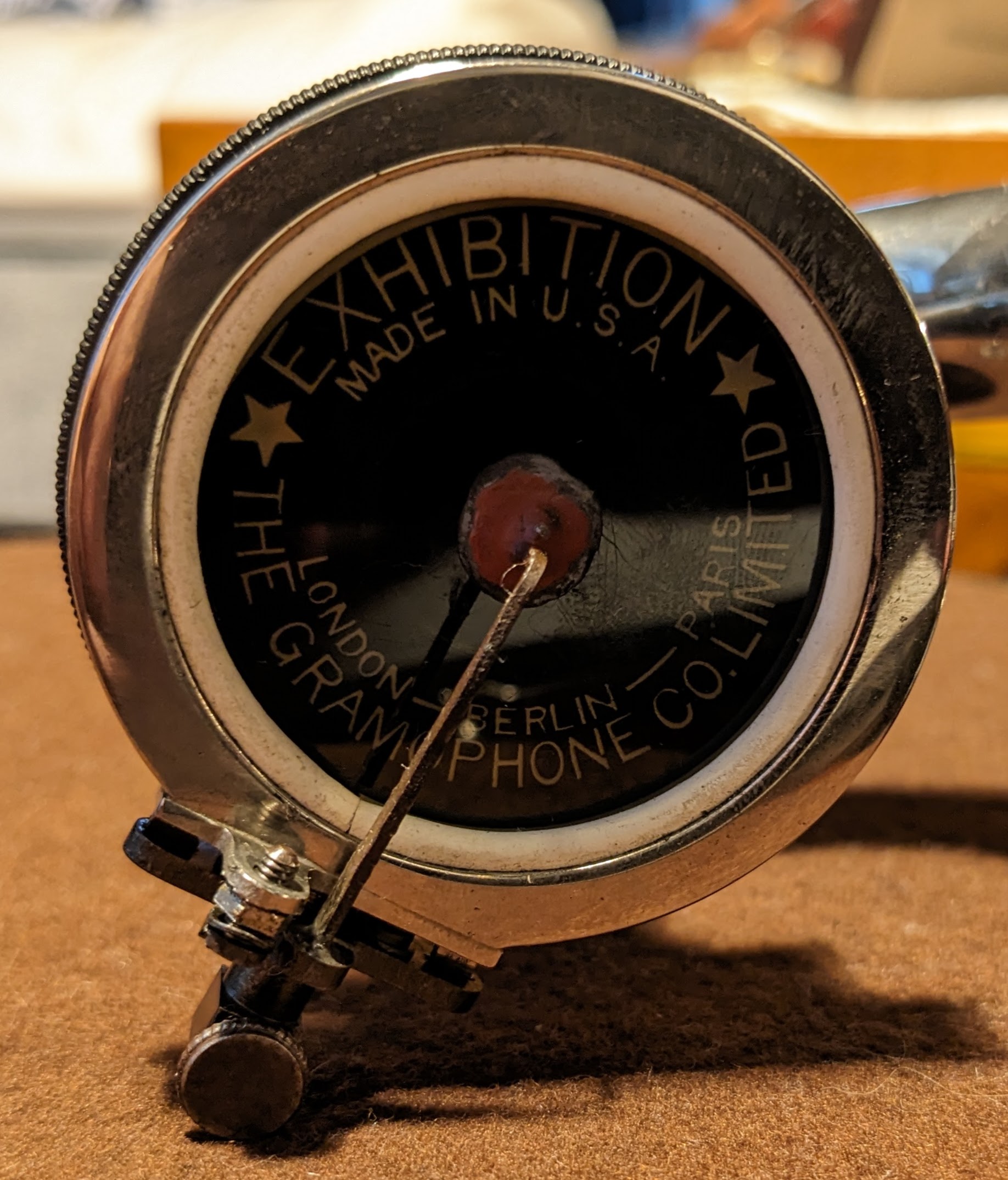

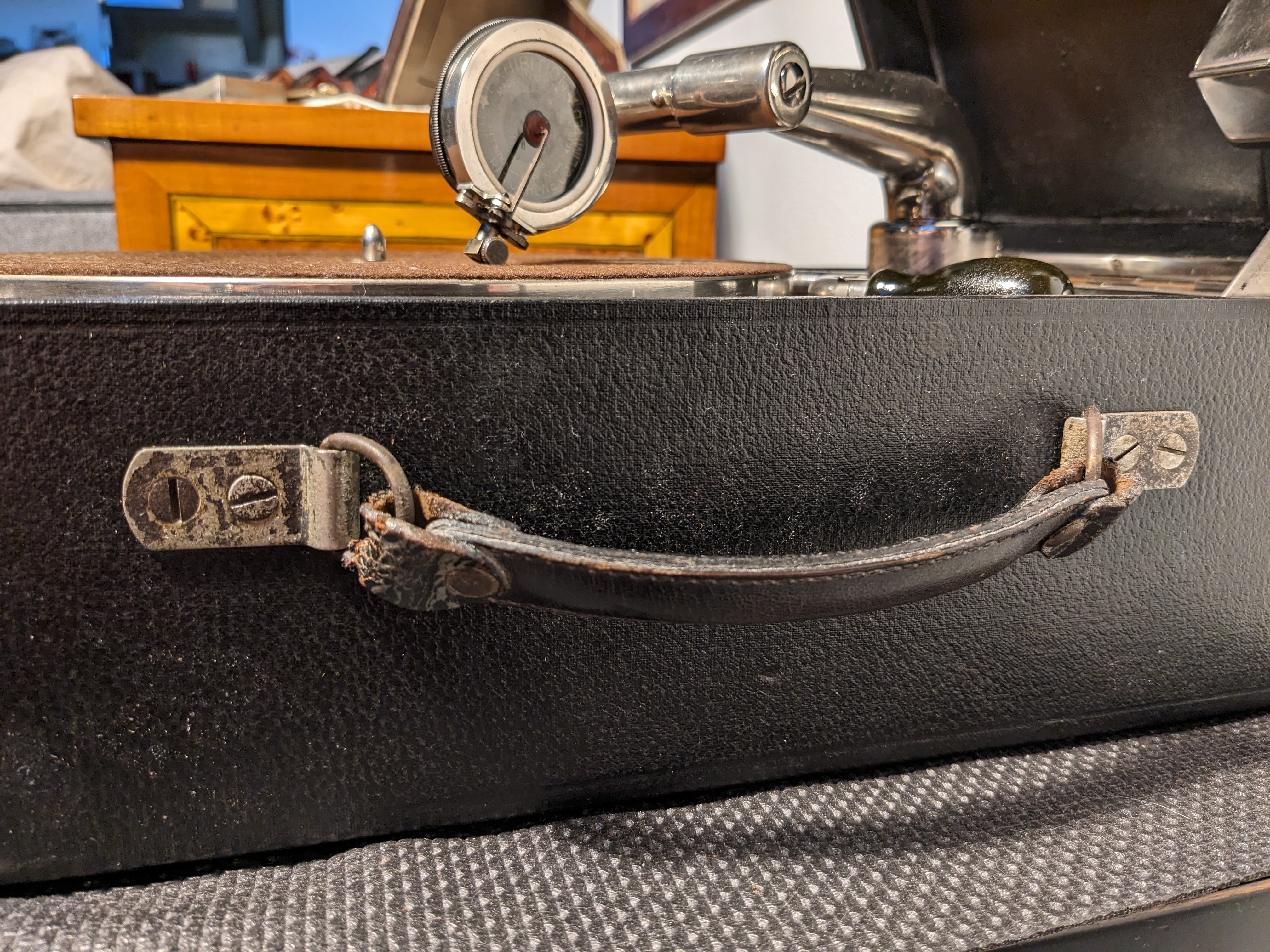

I read the preceding discussion and I'm inclined to think that this should be an early machine due to the presence of the metal ring around the hole in the record tray, and the pattern of the front lid catch. Not sure about the originality of the leather handle, which in any case has suffered from age (I would not dare to lift and carry the gramophone using the handle!). Another thing that puzzles me is the USA made soundbox. When searching for an HMV 100 on the web I found (and missed) some specimens with the UK manufactured Exhibition soundbox, and at least one with a n°4 soundbox. Despite my scarce experience and lack of reference books the number 4 soundbox looked incorrect to me for this machine so I asked the seller for a clarification and got no answer, and in the end passed on it. Could it be possible that Hayes factory was not ready to manufacture soundboxes in-house, and sourced them from the mother company in the USA at an early stage?
In any case I'm extremely happy with this machine, and to my greatest delight and surprise I discovered that using the BCN thorn (never-ending praise to that site!) instead of the standard steel needles greatly improves the overall sound quality. I would not say that the end result is on the same level of the 101/102 serie, but to my ear the thorn gives a richer and mellower tone reducing somewhat the harshness and metallic tone of the model 100.
Any comment welcome, kind regards.

Paolo,
The Made In The USA "Gramophone Company - London Berlin Paris etc" soundbox pre-dates this machine by almost a decade. It is inconceivable that an Exhibition of this age would have found its way onto a Model 100 in the Hayes factory by the mid 1920s. The in-house Hayes manufactured Exhibitions would have been used on all machines after the Great War period.
I would suggest that a collector or previous owner has put an earlier soundbox on it by accident thinking it is correct and probably to replace a non-HMV budget "after market" off-branded soundbox with aluminium diaphragm which another earlier owner used to replace the original Exhibition when it would have been rendered obsolete by the improved soundboxes of the late 20s / early 1930s.
That's my best guess, anyway!
HTH

Good morning Steve,
thank you for your kind answer and sensible argumentation. So I guess that the only really original and correct soundbox for an HMV-100 should be the british made Exhibition, but let me please pose another question. You wrote that the american soundbox fitted to this gramophone pre-dates its introduction by ten years or so; are there any technical differences and/or improvements between the USA model and that manufactured in England when the HMV-100 was launched ?
Thank you in advance, kind regards.
Posts: 4028
Re: Out of the box, HMV 100
Post by Steve »
Paolo_MK68 wrote: Sun Sep 03, 2023 5:04 am Good morning Steve,
Hello again, Paolo,
No, both soundboxes are otherwise identical. The only difference is purely a cosmetic one: the engraved writing on the back-plate (visible through mica diaphragm) and the lack of serial numbers on the "His Master's Voice" later British made version.
Regards

Congrats for your HMV 100, it's in remarkably good conditions, a very nice machine to be proud of. Coincidentally, it looks absolutely identical to mine, except - as you already noted - the carrying handle. I have also never seen another unit with this type of carrying handle, but on the other hand it looks very aged and "historical", so you never know.
Concerning the soundbox, I agree in full with the notes by Steve. It was surely fitted in recent times as the "closest matching replacement" on a unit that came without for one reason or another.

I've seen this kind of leather strip handle and supports to the case on early HMV 101s of the side-crank type, so it must have been in use for a certain period, it seems authentic.
