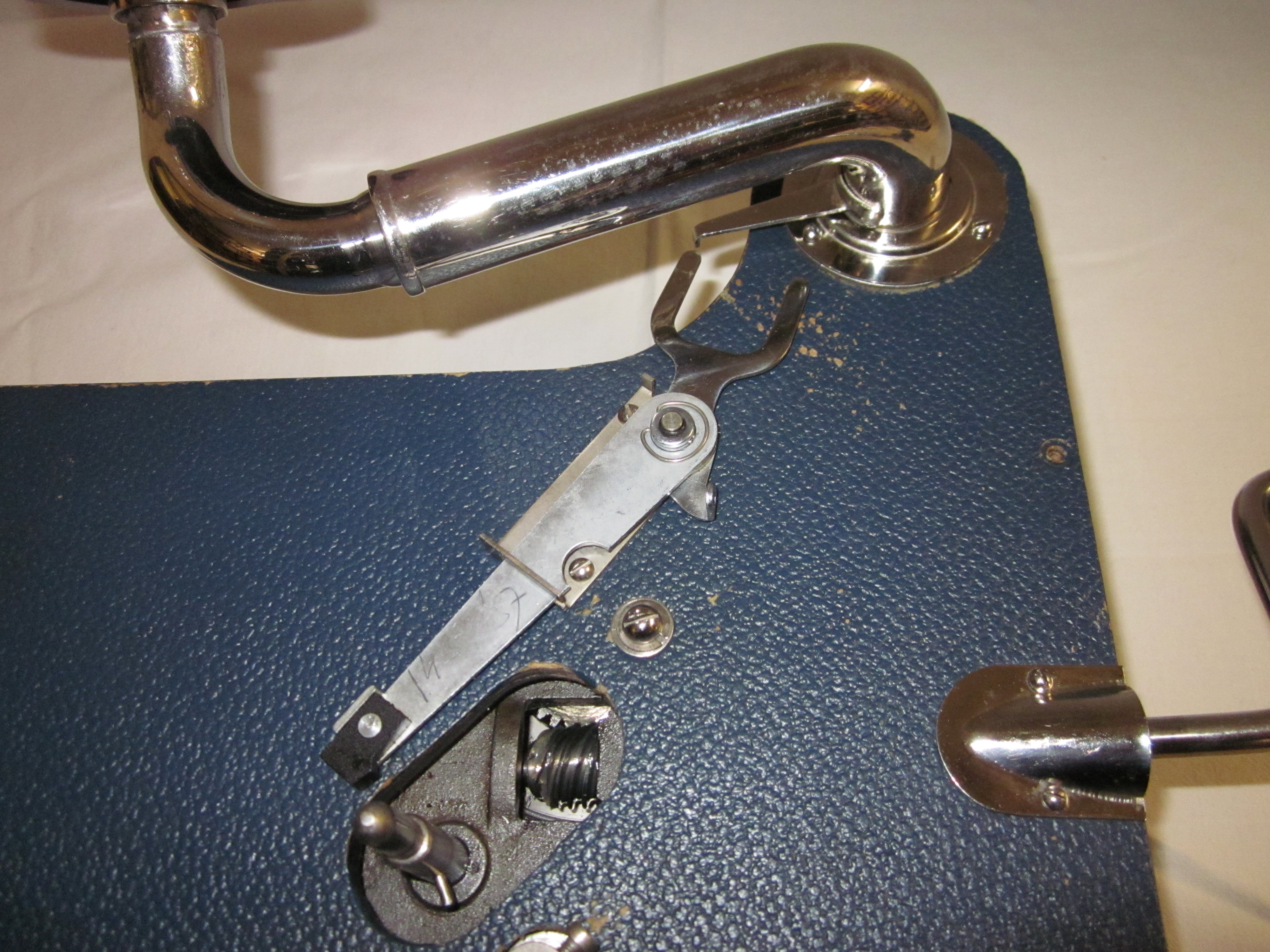

I'm borrowing this thread if I may. I just repaired a model 87 for someone and I have a question. Also I would like to mention that it is blue so a blue specimen has been seen also. Although this site: http://www.grammofonmuseum.no/Grammofon/HMV/hmv_87.htm has a picture of a blue one so it might not be worth a mention.epigramophone wrote: Mon Jan 06, 2020 6:50 am The fitting inside the lid is clearly visible on the examples pictured in the His Master's Gramophone book. I suspect that it's purpose is to prevent the tonearm from slipping off it's cheap and nasty looking support bracket whilst the machine is in transit.
The book states that the case is normally black, but that red has been seen, so now green has also been seen. An interesting find.
Anyway, my question is about the automatic brake. Attached is a picture of the one in this machine. Should there be a spring or something that keeps the moving parts in place when the brake is on? When I close the case and pick it up, the turntable starts to spin because the brake moves out of locking position.
