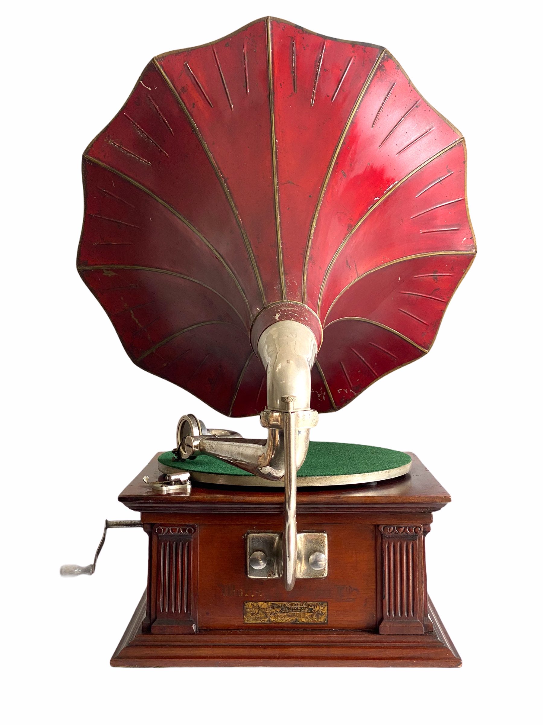

This Monarch Senior was marketed as the "Ionic" given the style of the columns.
This style is arguably up there with what I think is the most aesthetically pleasing of the HMV cases. Attached is a photograph of my own machine.
Regards,
Mario

Re: Gramophone Co Ltd Monarch ?
Thanks for the information Mario. You ve got a great looking machine there !! Just to educate me further, do you find your Monarch is pretty noisy when running compared to later machine from the twenties? I ve restored two other Monarchs and I found them all to be noisy. I m wondering if it s just that the gearing is understandably worm and therefore noisy or were they pretty noisy from day one.
Eamonn
Eamonn
