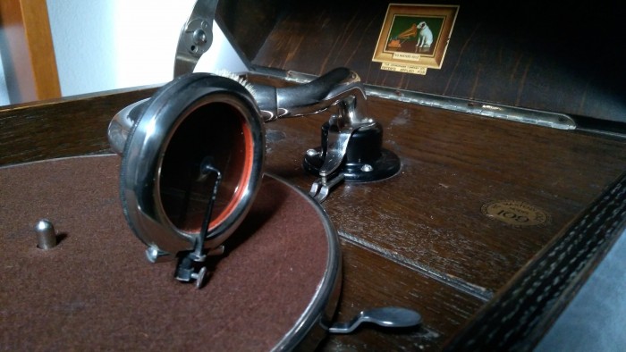

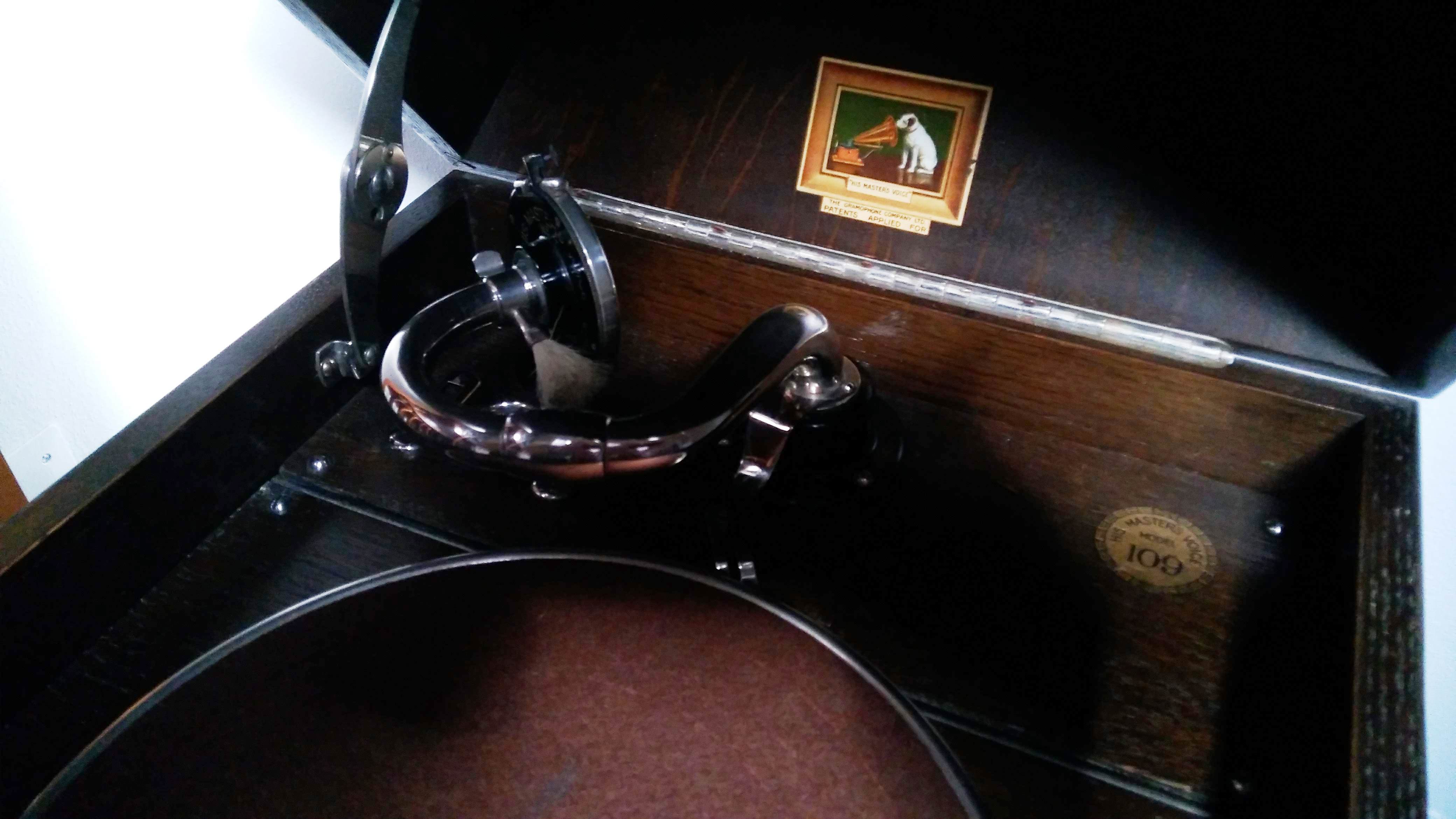

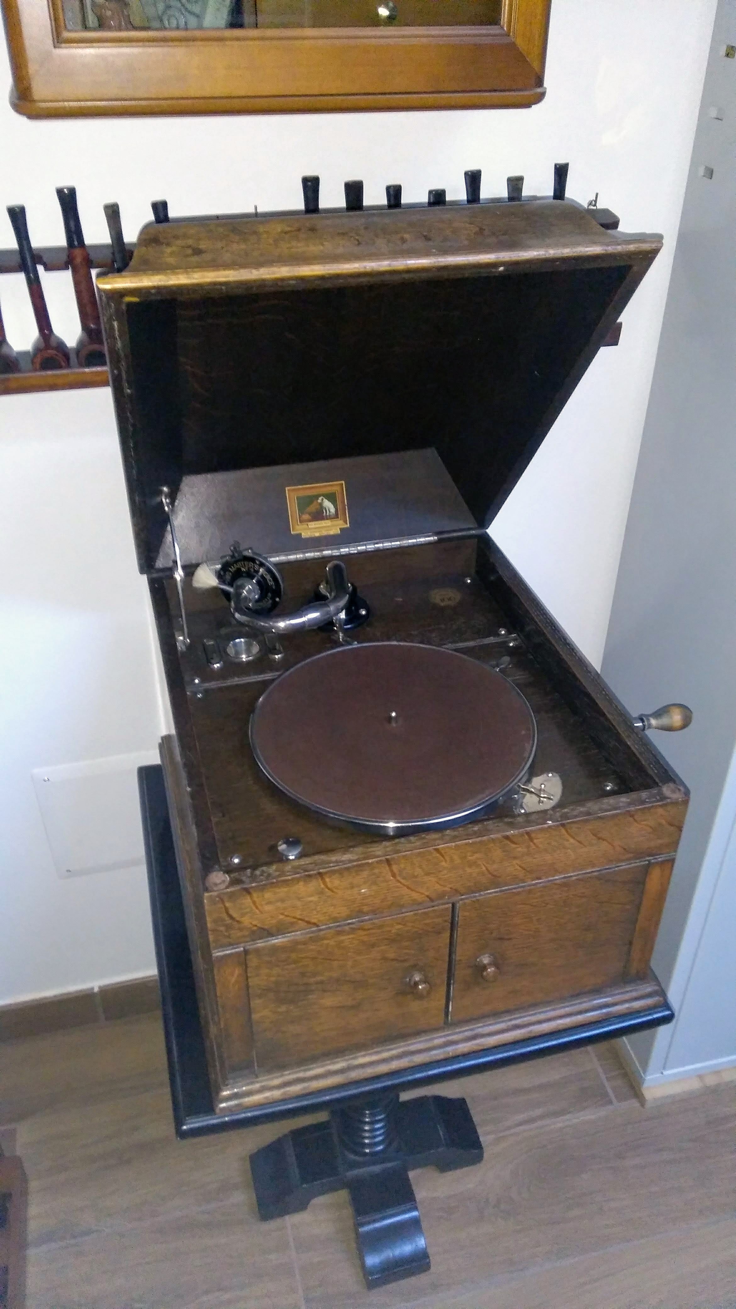

Here's the last guest added to my sample of acoustic gramophones: an HMV-109, the only internal horn machine I own apart from the portables. Due to overall ignorance and lack of specific documentation (still chasing a copy of "His Master's Gramophone" book without luck), some features of this model are either unknown to me or obscure.
What I know (more ore less):
* made from the middle of the Twenties in either mahogany or oak wood cabinet (mine looks absolutely oak as far as I can understand of wood).
* correct n° 4 soundbox with early stile brass backplate and flush rubber collar.
* correct double springs motor (model n°32?). I did not dismantle the motor board, but the seller wrote me he carefully checked inside the machine, and since he looked serious and knowledgeable I tend to trust him.

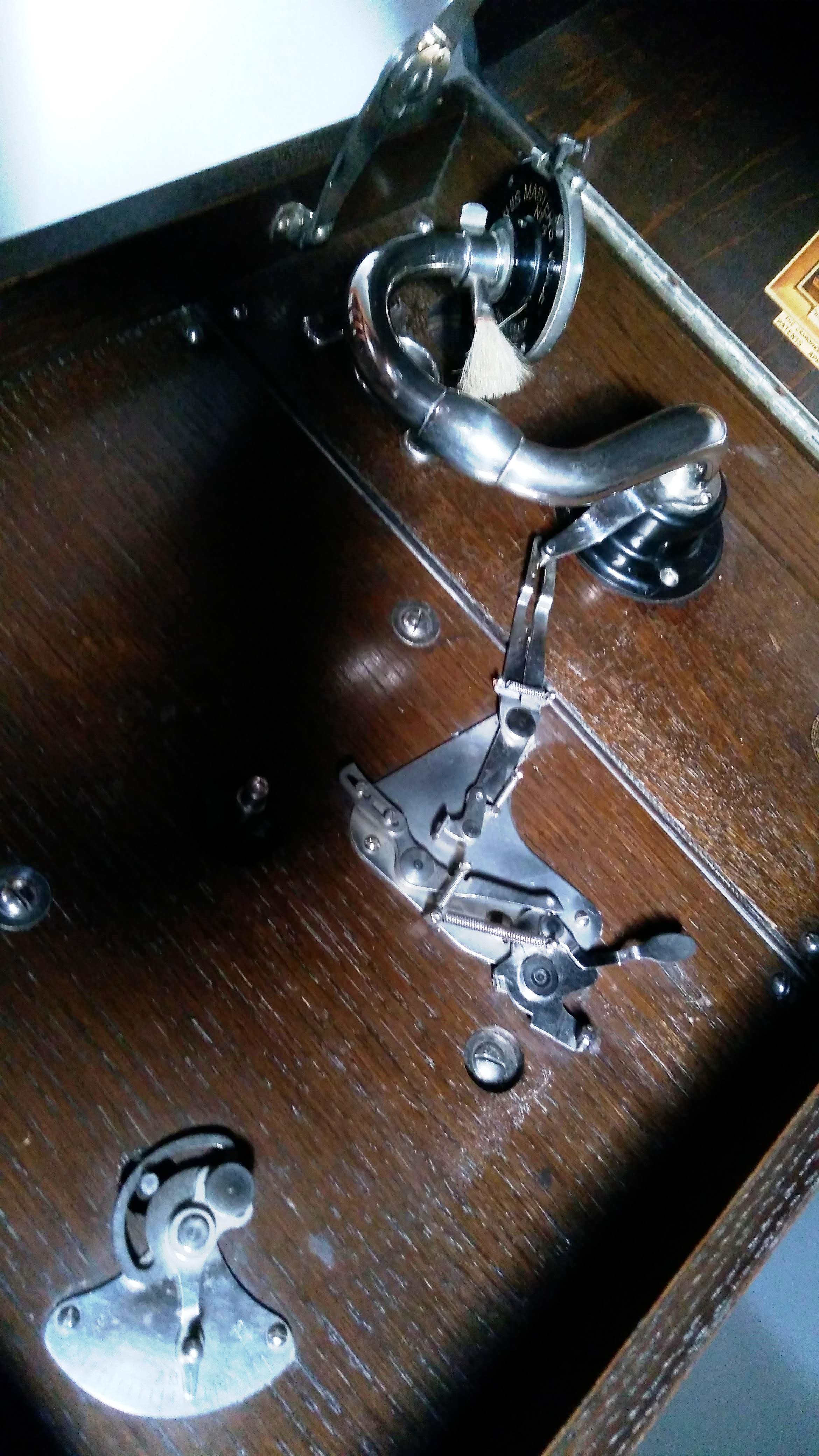

* automatic brake capable of stopping the record, but not starting it. Infact it seems the turntable must be put in rotation releasing the lever under it after having swung the tonearm fully to the right. I guess this could be considered the functional limitation of this device: nothing major when playing a 10" record, but it's a little more inconvenient to reach the release lever under a 12" record, especially if you have big hands and fingers!

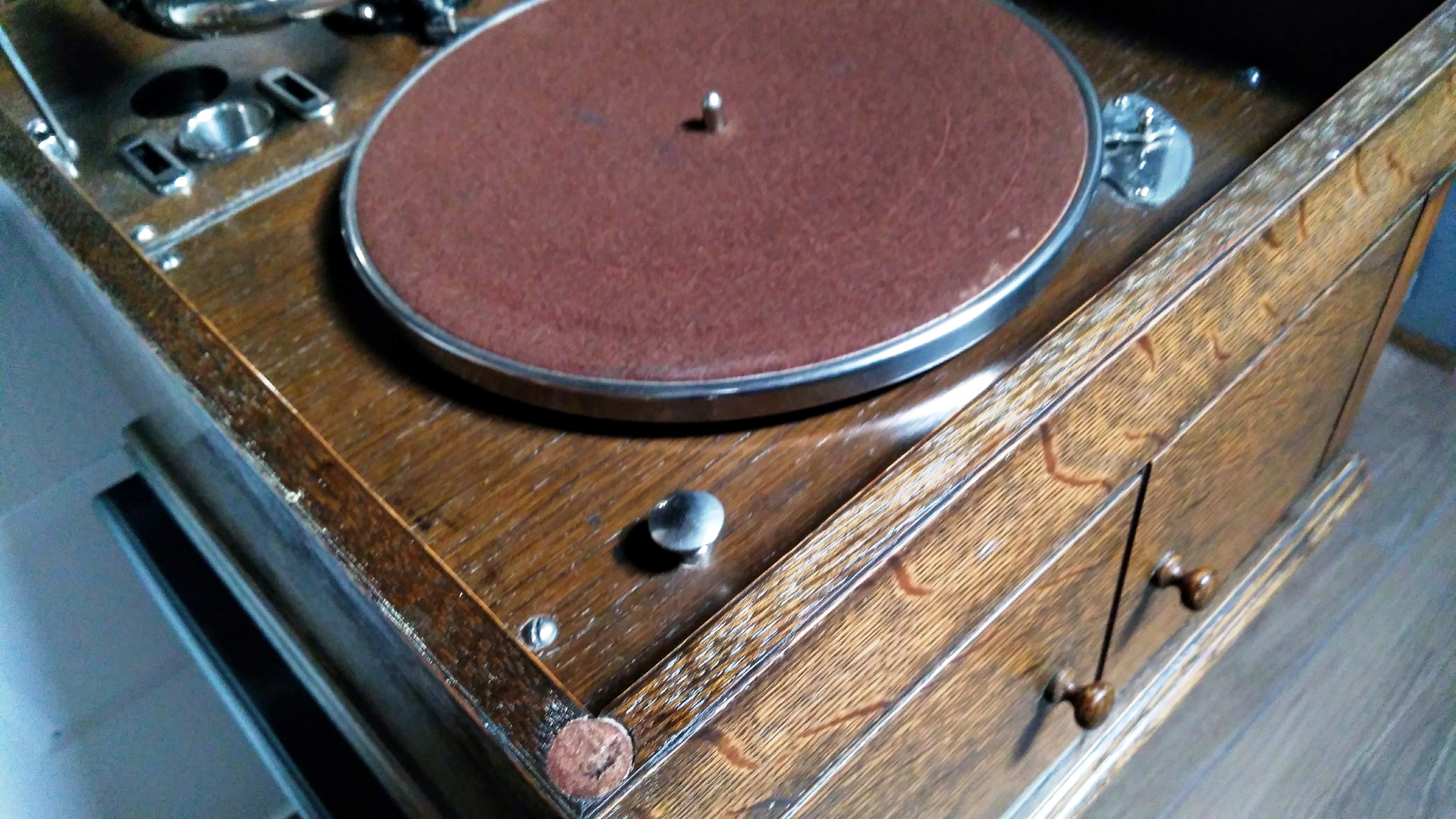

* no idea about the metal knob in the front-left area of the motor board. It's loose, rotates but does not engage or screw into anything... what's its purpose?
Thank you for any hint or additional thought (criticism also welcome!).

Re: HMV 109: latest toy.
Your 109 predates the introduction of the self releasing autobrake, which later examples have.
The knob on the front left corner of the motor board is to assist lifting it out for lubrication etc.
On removing the motor board you can tighten the screw which holds the knob in place.

Curious - my 109 had a second lifting knob in the opposite corner.
- Posts: 4680
The next model of auto brake added another lever to that arrangement, that allowed to release the brake moving the tonearm to the extreme right.
The knob is simply for lifting the motorboard when unscrewed. It has a screw below the board, which should be tight. If you pull the knob upwards carefully while trying to screw it (clockwise) eventually you could get it tight without removing the motorboard...
This is a marvelous machine with a nice sound.
A big thank you for the hints and additional information, much appreciated.
@ Epigramophone noted your explanation, good to know that it's how this version of the brake works!
@ Neilmack Yes, it's curious indeed, but your gramophone's arrangement with two metal knobs seem more practical from a mechanical point of view when lifting the motorboard. On mine there's no provision for a second knob in the rear of the motor board, I double checked yesterday night,
@ Inigo thanks for the hint: I did as you suggested and managed to tighten the knob again! And yes, following some quick sound check I can say the voice of this machine is surprisingly rich and mellow.
@ OrthoFan : great documentation and thanks also for the link to the forum discussions. While searching through the board in the past days I only managed to found the most recent of the three, that about the restoration.

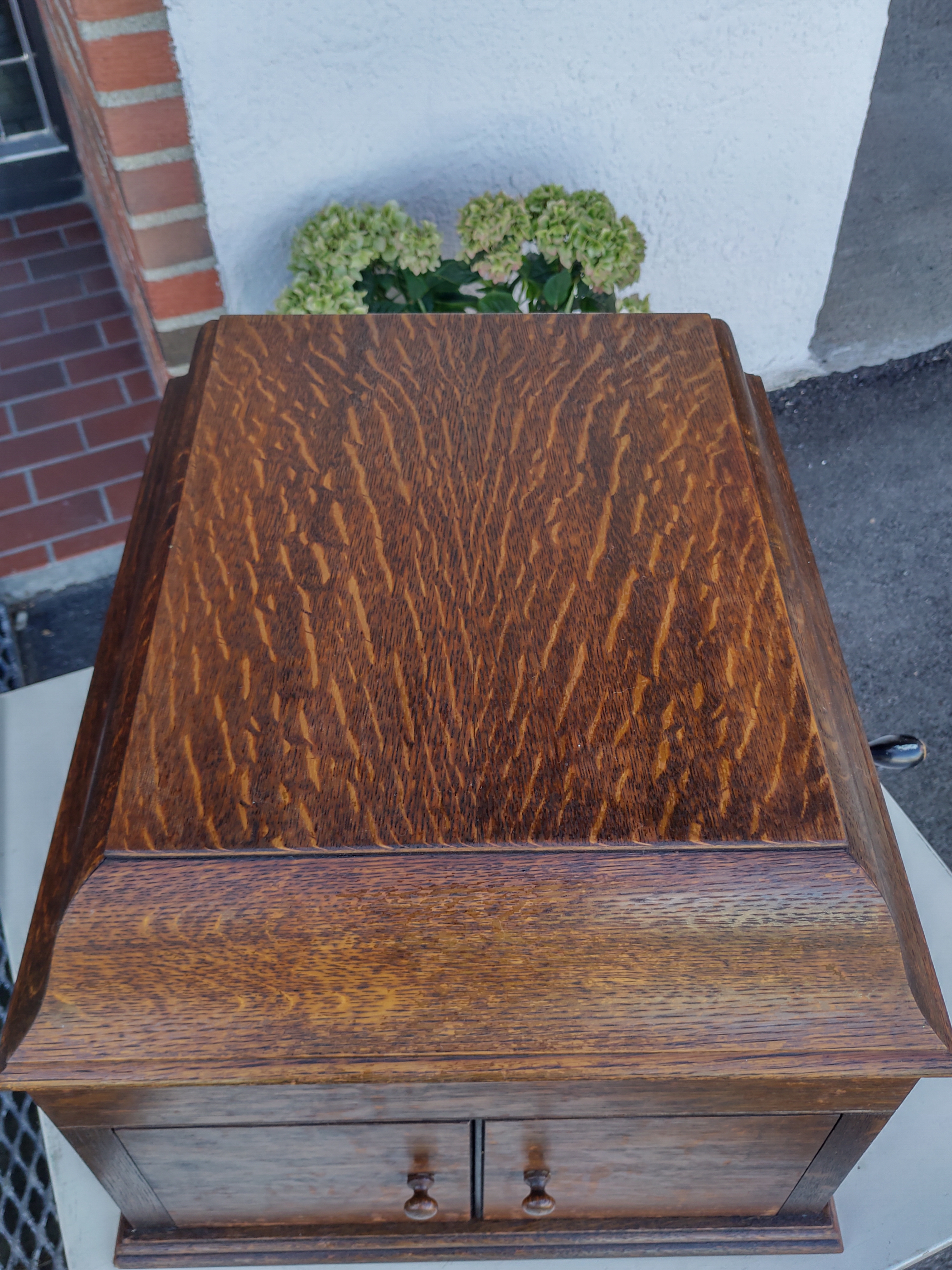

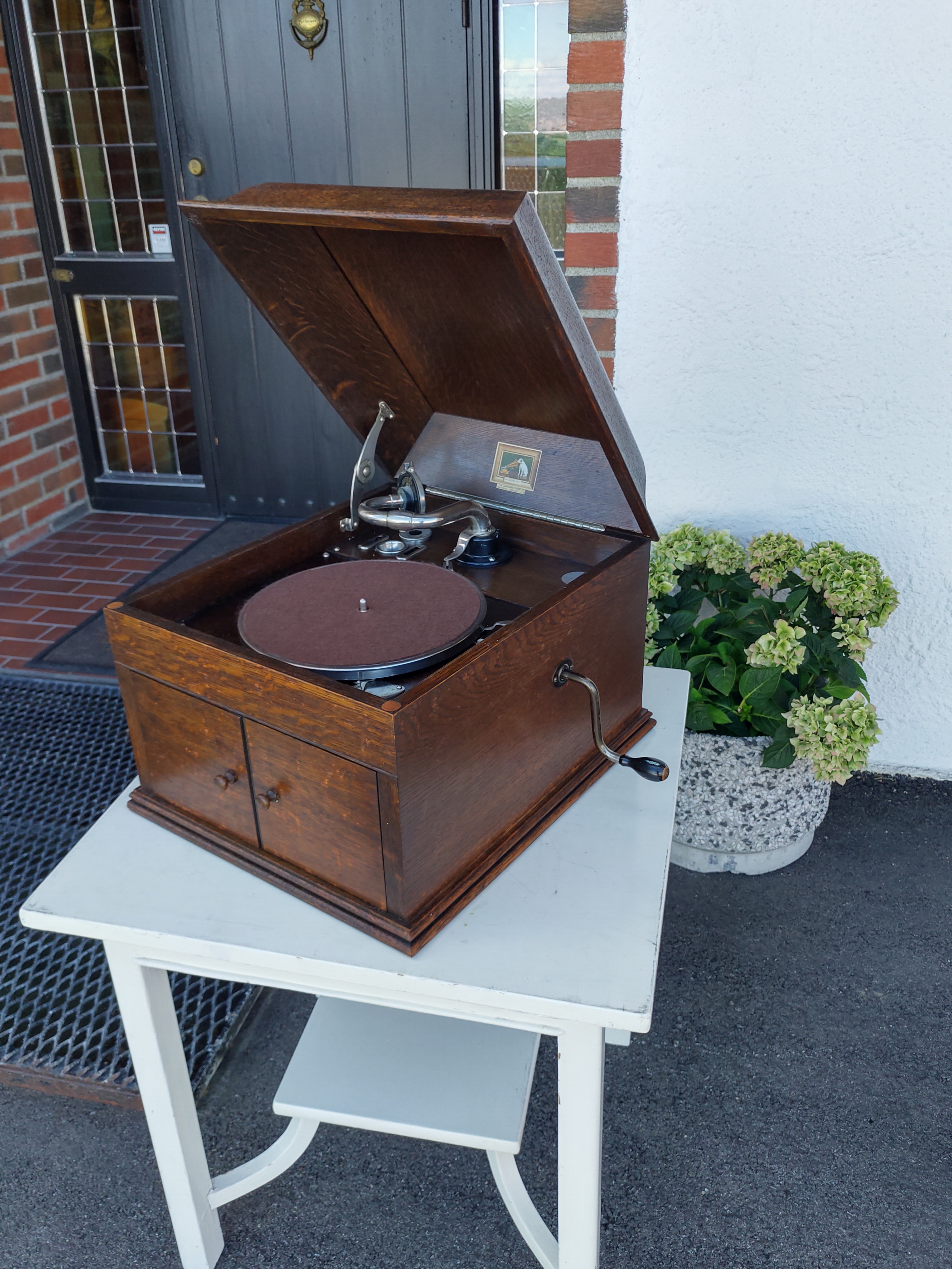

A great machine you have got there Paolo. I am the one who restored the 109 on the photos in the linked post, and here is my second 109, just finished restoring it two weeks ago. Here it is out in the sun, surrounded by flowers. It is a beautiful machine, and I have a hard time departing with it this time, since there are no flaws on the cabinet at all, no veneer problems etc.
Good luck with your 109, if it starts slowing..or you hear bumps inside the machine, you will need to clean the main springs, and the governor etc. I have this summer serviced 4 machines with 32 motors, and now I am closing a chapter, because next week I will service the last 32 motor that is left unserviced in my collection. The 32 motor is a heavy lad, and maybe not the easiest motor to service, but it is a strong and durable motor with its double spring motor.
