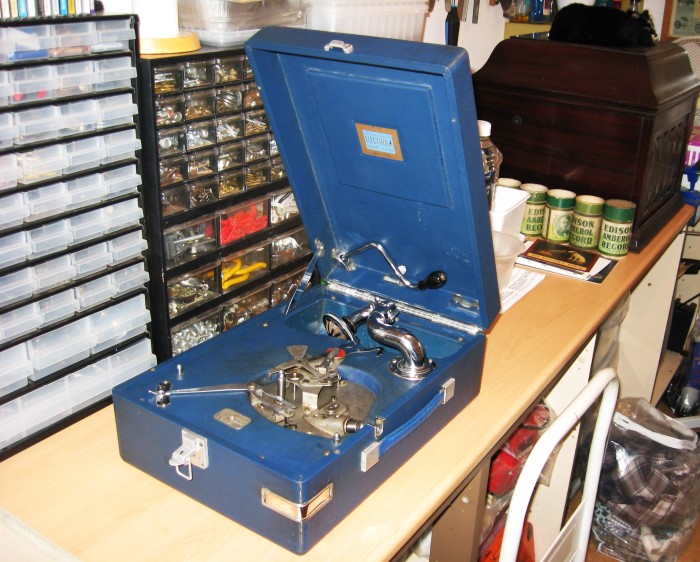

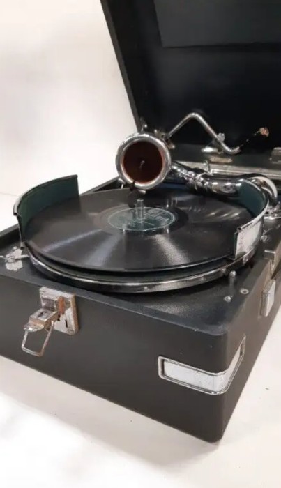

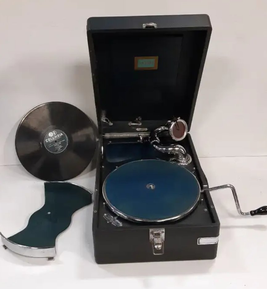

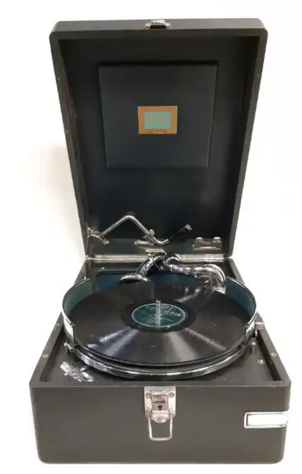

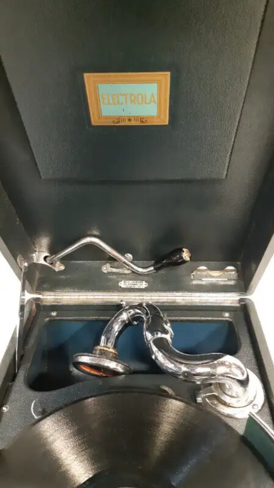

Well here is a rarity for Canada, I think, a German (?) HMV 102 Electrola, with its/a record holder intact.
$465 CDN
https://www.kijiji.ca/v-art-collectible ... 1618540876

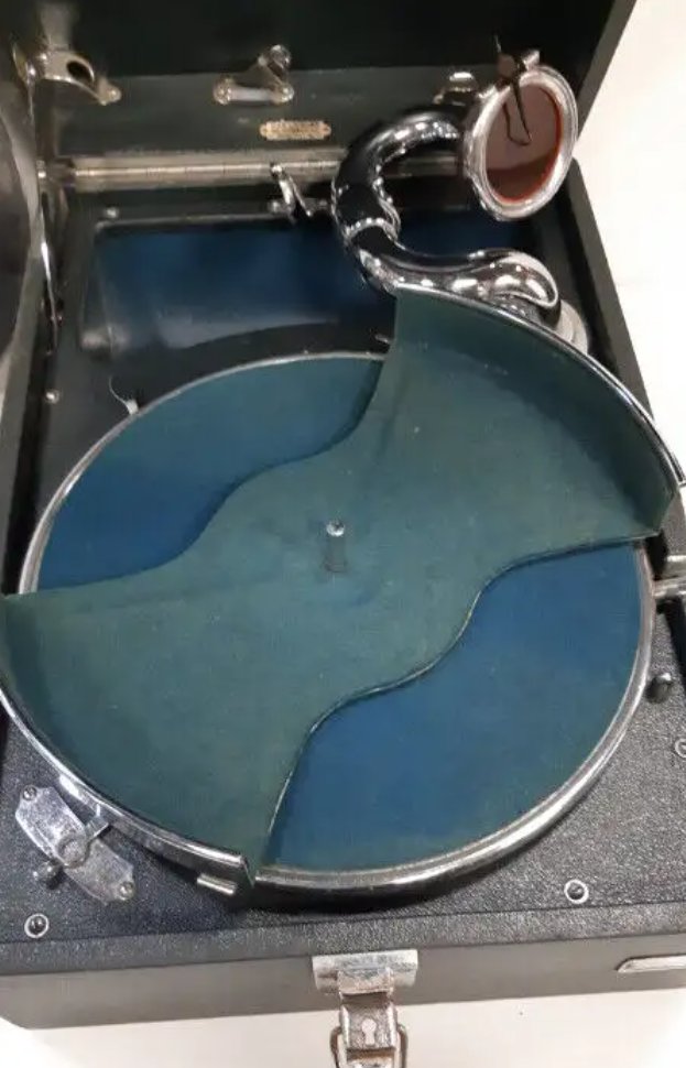

The reproducer doesn't look very HMV 5x-ish, but I have seen other examples with identical looking soundboxes. Also the felt on the record holder and the platter doesn't seem to match; one looks more green, the other more blue.

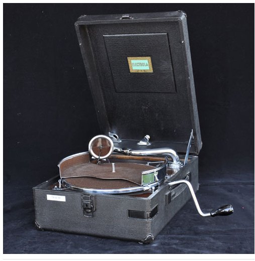

Here is one from a Turkish (?) collector:
2024-06-09 15.45.05 www.gramofonkoleksiyoncusu.com f81da330509d.jpg (41.96 KiB) Viewed 1534 times
http://www.gramofonkoleksiyoncusu.com/m ... php?id2=46

It's the Electrola Nr. 4 soundbox, correct for this machine. Tempting!

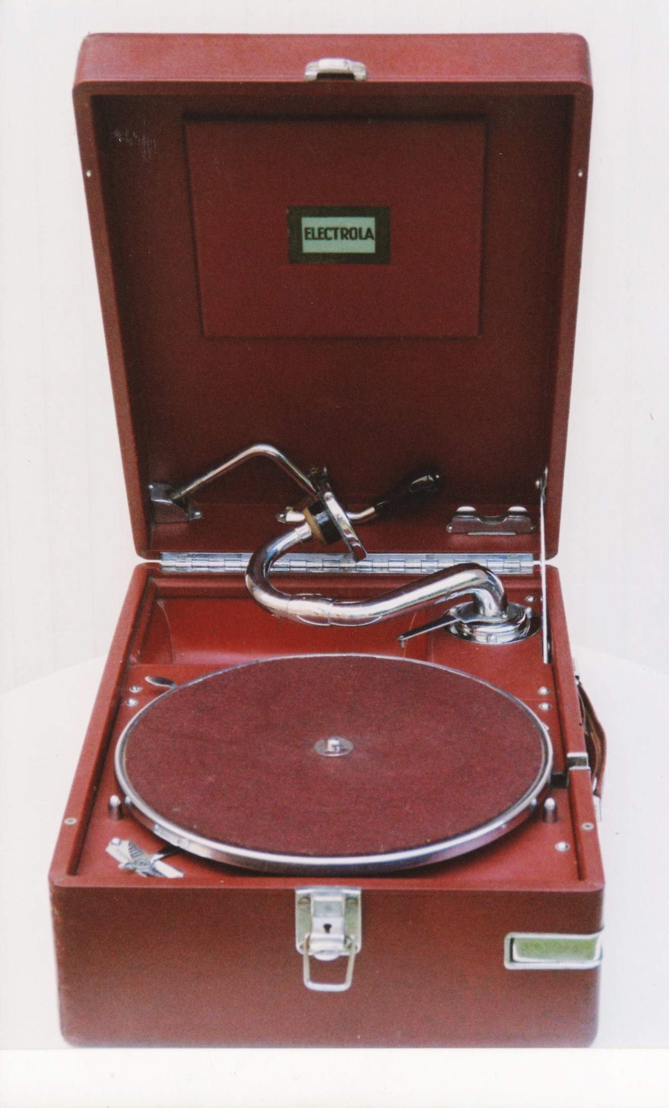

The Electrola No.4A soundbox would be correct for the second (Turkish owned) machine pictured by Lah Ca, which is a 106 comprising the "works" of a 101 in a 102 case. I had the red 106R version which has since been sold.

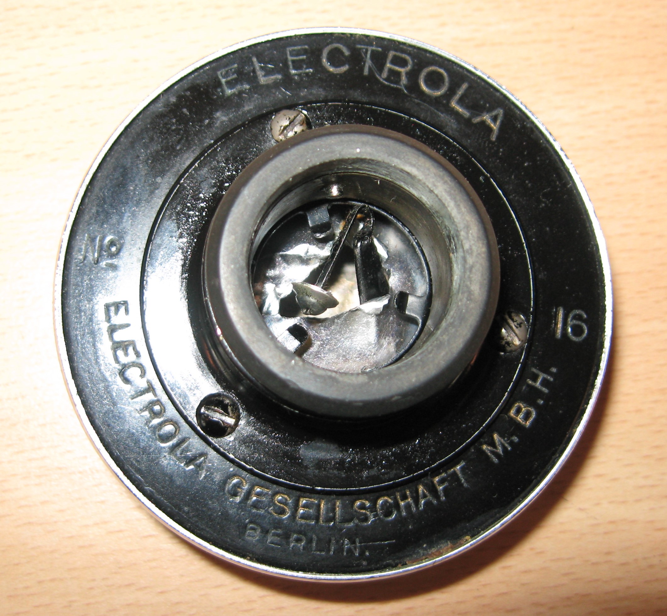

I am currently restoring the earliest version of the Electrola 102, which has the metal motor board, the Electrola No.16 soundbox (unfortunately damaged and impossible to dismantle for repair) and the unreliable "Universal Autobrake" which HMV abandoned within the first year of production. Needless to say, this brake does not work as it should. I have removed the actuating lever from the tonearm and am considering fitting a manual brake. Although not original, it could easily be removed, and the tell tale screw holes would be hidden beneath the turntable.
The later 102 pictured by Lah Ca also appears to have been fitted with a No.4 or 4A soundbox. Since my earlier 102 has a No.16, I doubt that a No.4 or 4A on a later version would be original since it would be a step backwards.

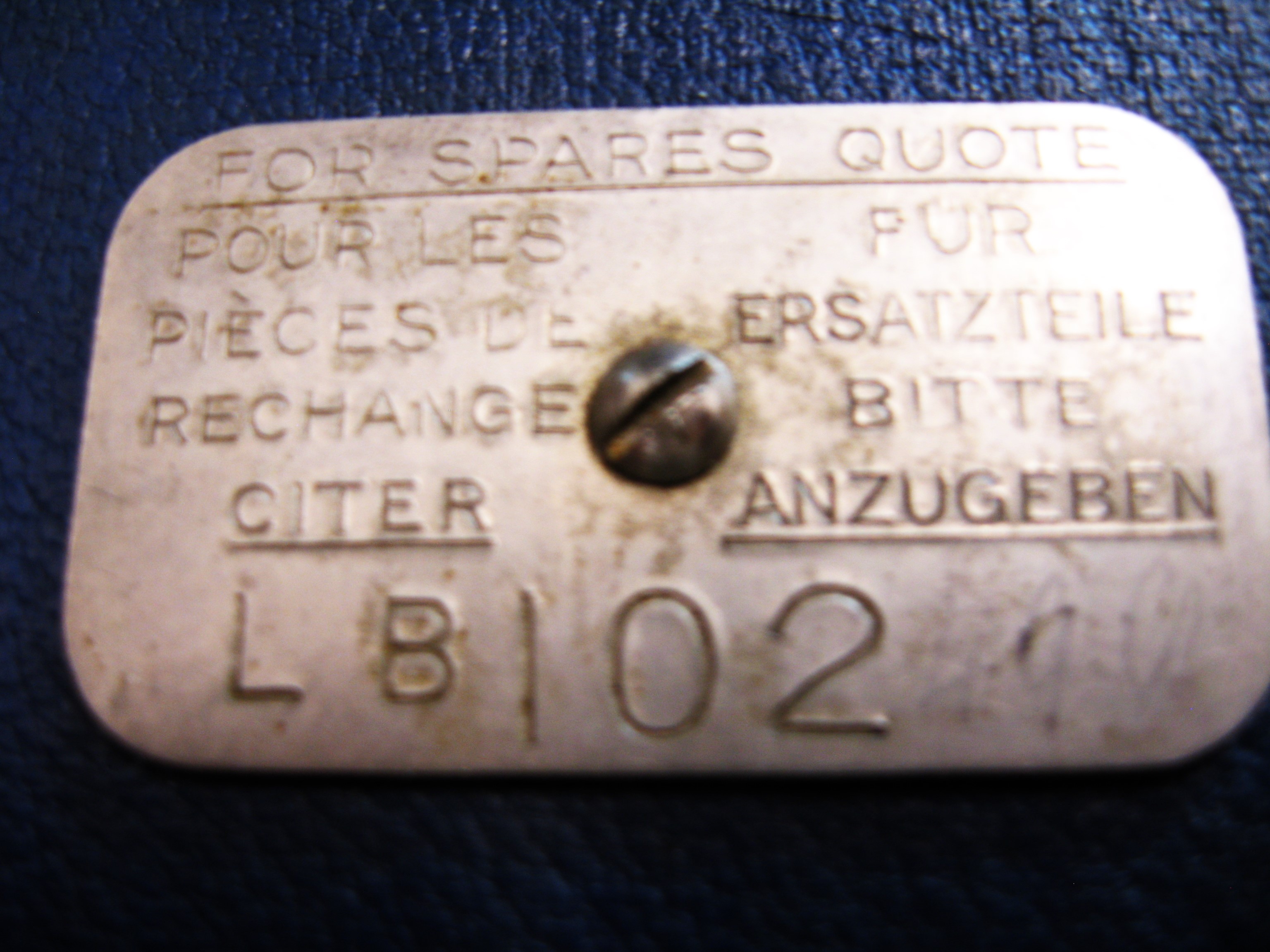

The Electrola LB102 is alright with this No.4a soundbox, which was used on the 102 too as No.16 reproducers were out of stock. This happend sometime before march 1933. There NEVER was the No.5a on a Electrola portable as on the HMV‘s.
Off course the No.16 sounds much nicer on the 102 but it’s original for this later 102 A or B, just like motor is already made in Germany and not Hayes. They probably abandoned the 102 as they introduced the 106 in november 1934.
Note that the leatherette got green while it is infact a blue portable! They are always very nasty to clean.

I remember that my 106R had an unmarked (German ?) motor, but my LB102 has an HMV 271-C.
