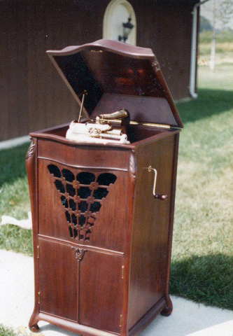

Bruce,
I'm not familiar with the 'Banner' designation, but the mahogany model you describe was called the 'Opera' by US and was the reason Edison was compelled to change the name of his 'Opera' to 'Concert'. When I lived in California there was a US 'Opera' for sale for years at The Gas Pump Antiques in Riverside, but that is well over ten years ago. I don't know where it went. The only other US 'Opera' I know of is in Don Gfell's collection.
Ask and ye shall receive . . . believe it or not I have photos of Paul's US 'Peerless'! The cabinet is by Herzog and the bedplate is ivory white. It went to the museum in Texas that Rick Willins was associated with. I actually have the images on my iPhone, but will have to email them to MordEth to post them for me, so stay tuned. It is a magnificent beast . . . gold-plating, bombe' cabinet, both doors linked to open at the same time. I show the patent drawing for it in my book American Phonograph Design Patents, if anyone has a copy of that to reference.

Valecnik
Posts: 3872
Location: Česká Republika
Re: US Lakeside on ebay soon.
Post by Valecnik »
John, Thanks for the information. I look forward to the photos. Do you or does anyone recall what this model was called?
You are right about the "Opera model". I kept in contact with a guy for years in Canada who had a beautiful example with a wood horn. He claimed that the reproducer had never been rebuilt but that it played perfectly. He sent me some pictures of it by snailmail which if I ever find them I will post. It was really nice. I lost contact with him but these are so rare that I wonder if Don Gfel ended up with it somehow. So the first model lineup was from bottom to top the Junior, Banner, Opera, and that upright one. Hope somebody helps us out here!

MordEth
Posts: 1160
Joined: Wed Jan 07, 2009 1:01 pm
Personal Text: Contact me for TMF tech support.
Location: Boston, MA
Post by MordEth »
John,
You’re fast—I noticed I had that image in my e-mail shortly after reading your post above. ;)
So as John promised, here is that photo:
From the photo, that’s a very nice-looking machine.
— MordEth
Valecnik
Posts: 3872
Post by Valecnik »
John, David,
That's the one allright. Isn't that the most bizarre looking piece of equipment you've ever seen? Looks like a cross between a Sonora, Amberola 1 and a 34 Chrysler! As far as I know it's the only surviving example of an upright non-Edison cylinder phono.
