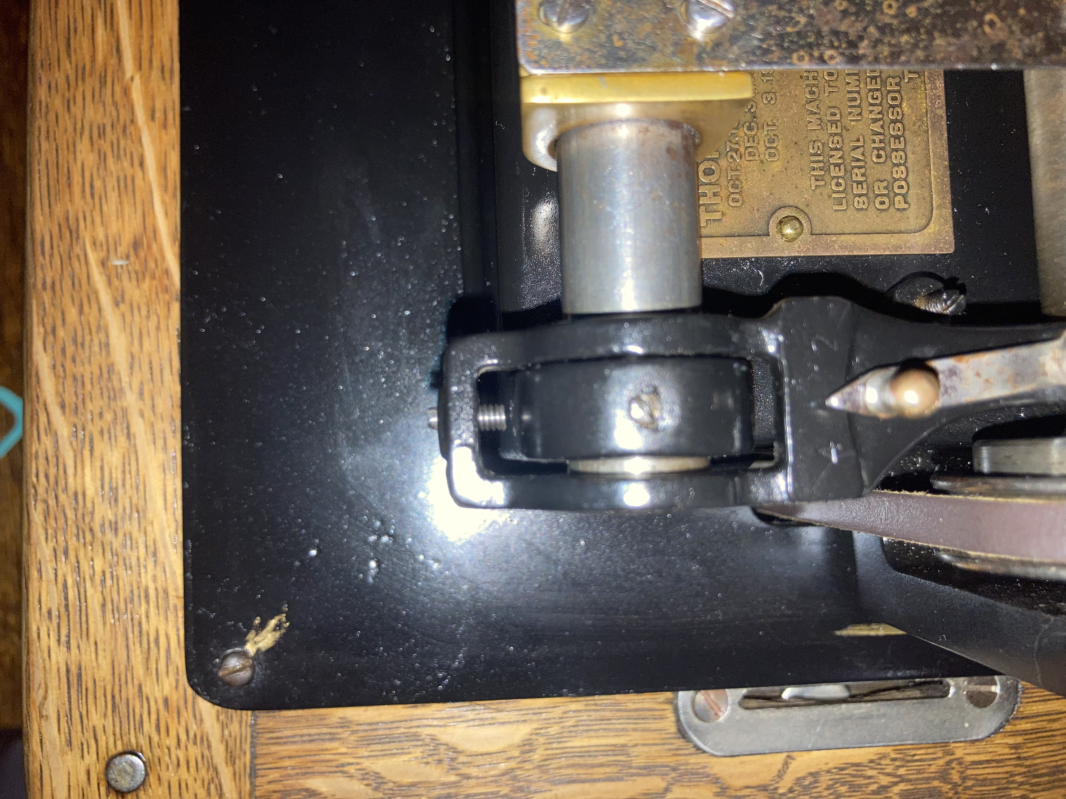

Oh! Here’s another part of this machine that could be contributing to my issue!
The screw that’s supposed to hold the 2/4 min switch is way too short it’s not even touching the back casting!
EDIT: I’ll just use my Home B screw as a temp fix.
