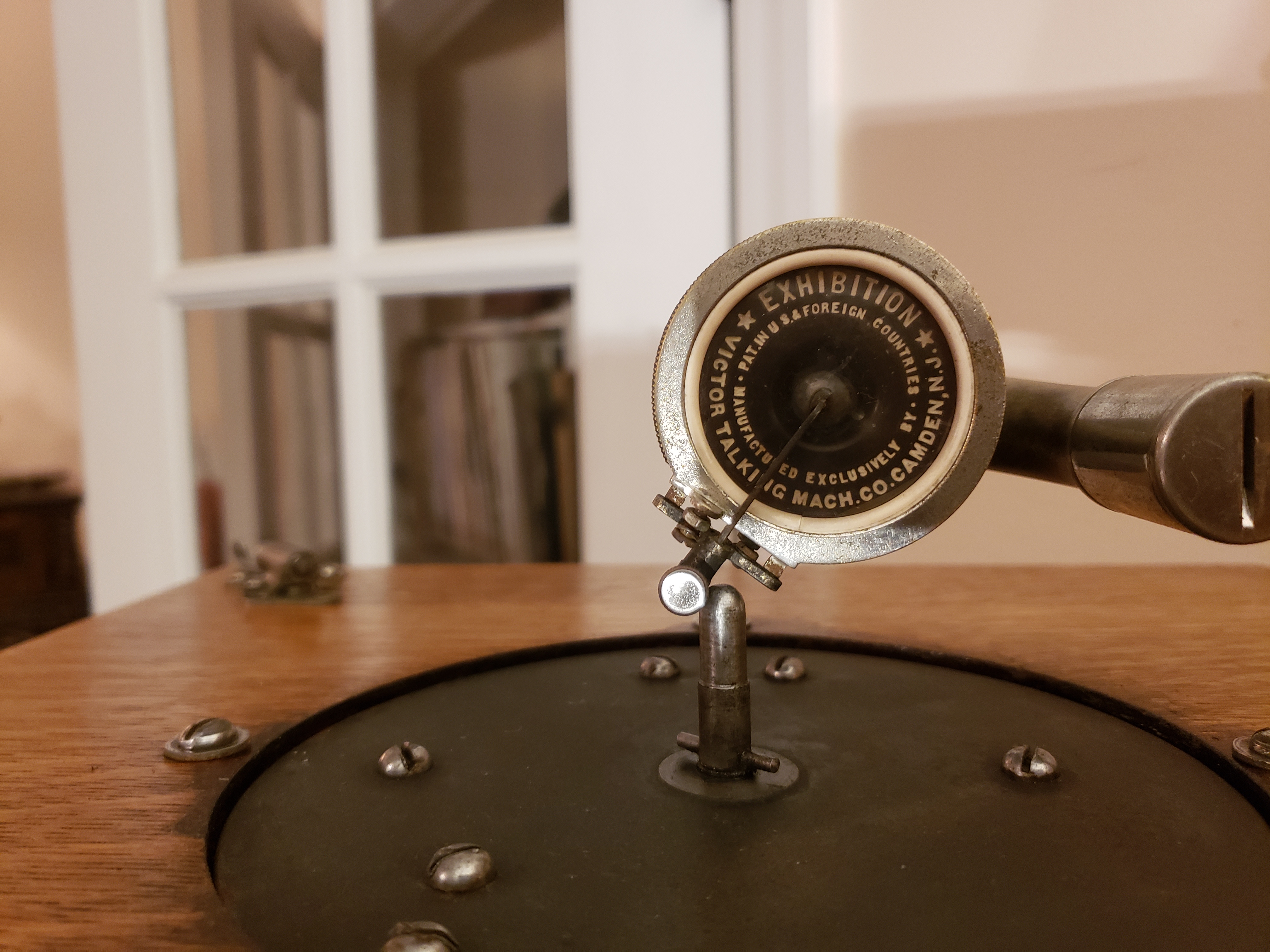

So, the transitional (plain case) D I'm selling on ebay measures 15 ¾ at the base. (for anyone unfamiliar, later Vs were larger in cabinet size.)
I'm wondering if it's because of this that the "center spindle test" looks like this for me.
Do I need to recheck my other taper arms and brackets to find one that aligns it perfectly? Or are all gonna be off because the case is smallish?

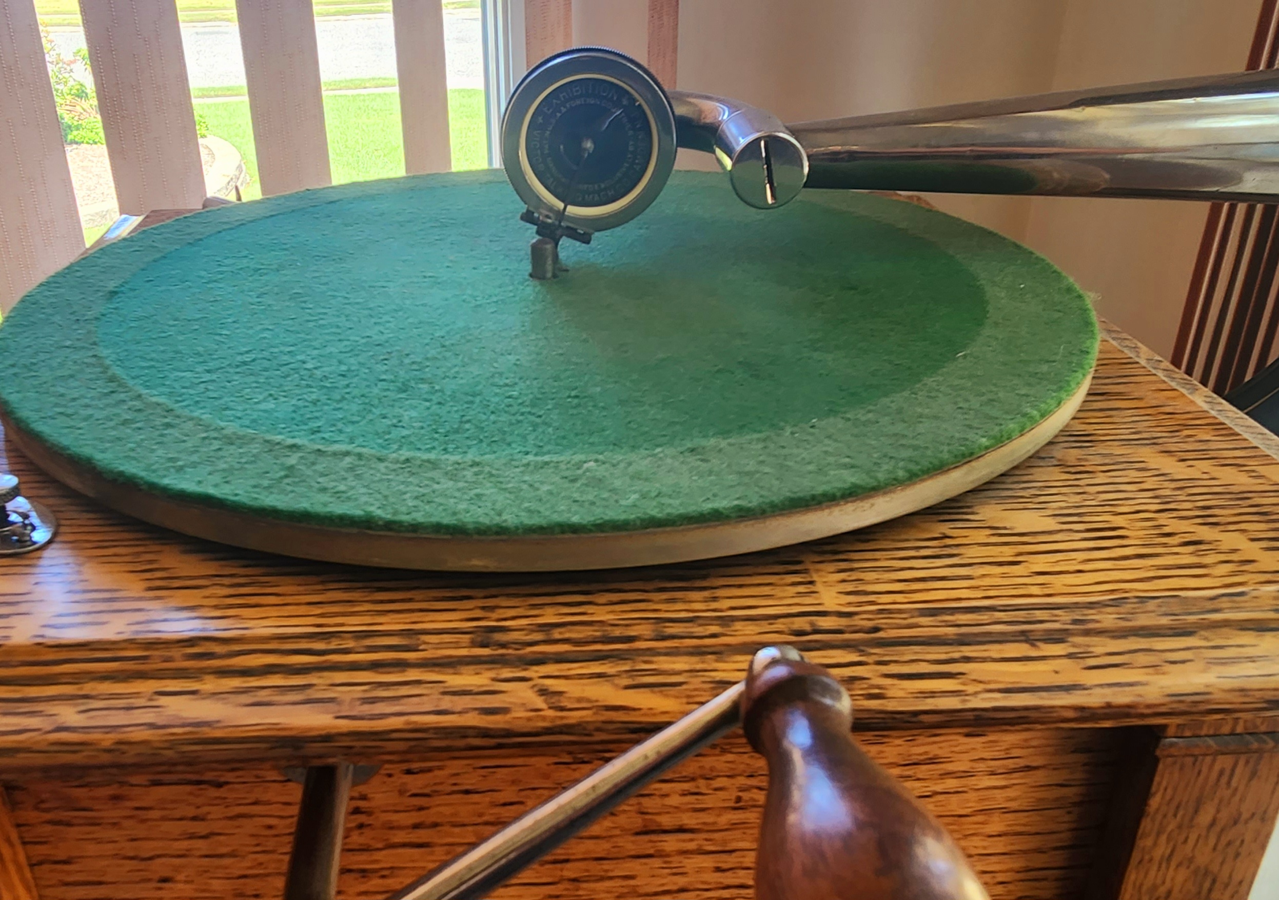

My plain case Vic. "D" Serial #12238 has a 15 ¾" base & the tone arm hits the spindle the same way. Your Serial # is just 690 later than mine . My machine came out of the attic of the family that bought it new. They bought it with the Model "L" horn! (24"X36").

My transition "D" needle hit dead center. Case measures 15 ¾ inches at the base. Early serial # 9207. Slotted crank.

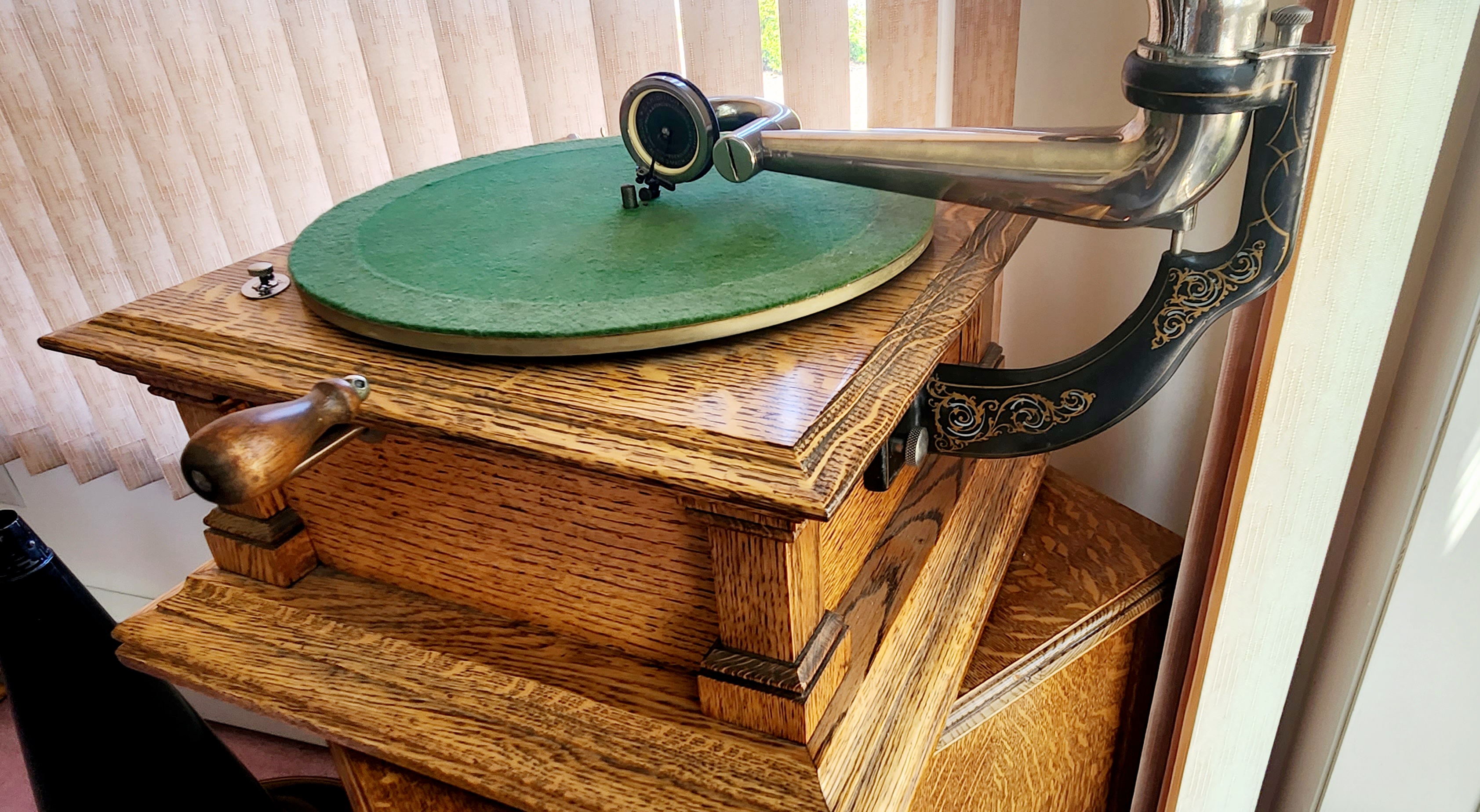

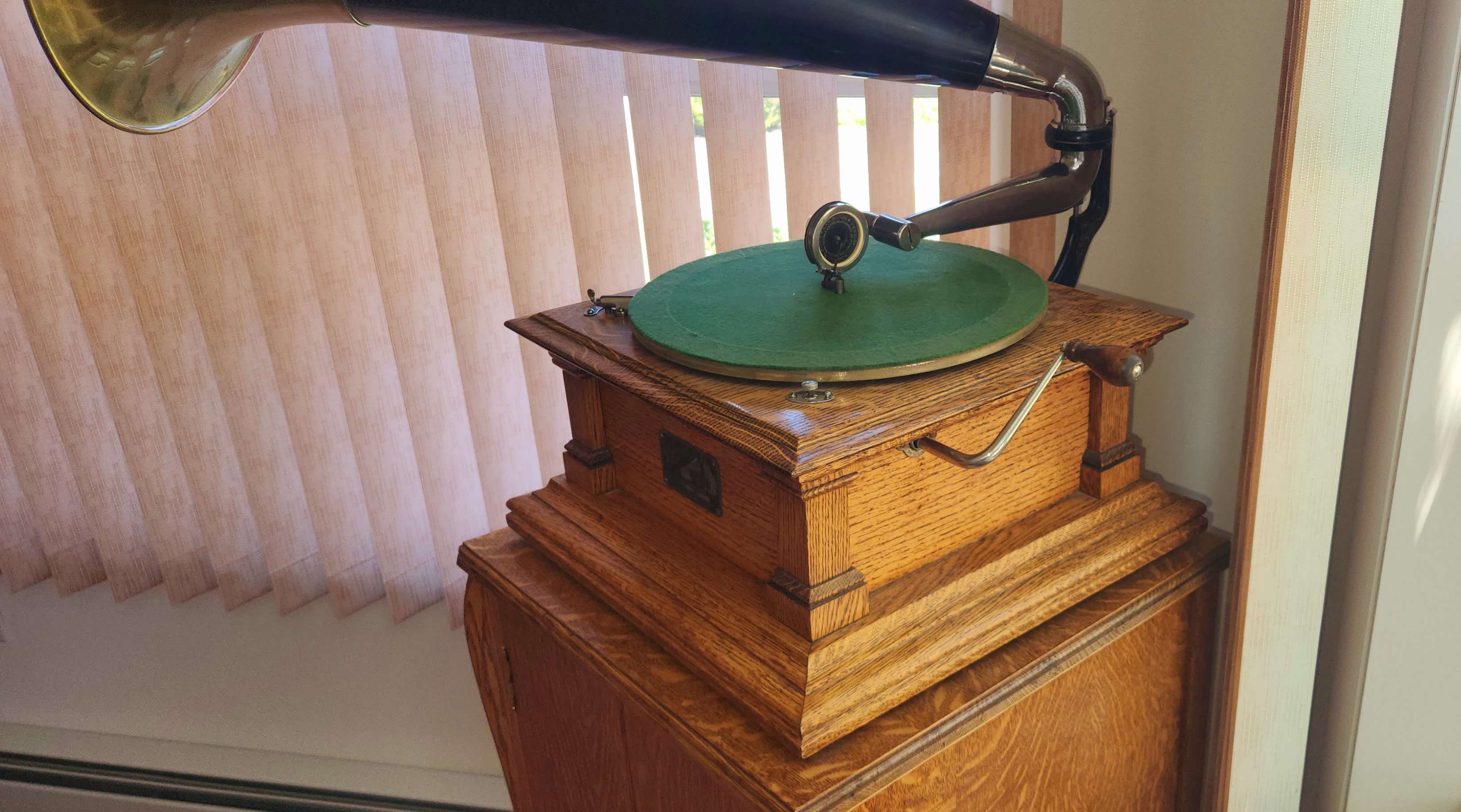

Any chance we can see a side view of the setup with needle in place on the spindle so I can compare brackets and tonearms?
fmblizz
Posts: 1212
Location: South Jersey
Re: Another Victor D V transition question re brackets
Post by fmblizz »
4 pics click on the pic to enlarge for better view
