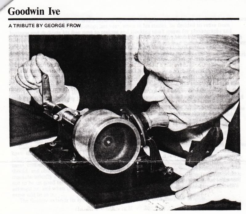

Yes, this was made by Goodwin Ive in 1977 for the centennial of the phonograph. Reportedly 100 were made in total. It was well-crafted and nicely decorated, and works extremely well (I owned one in the 1990s). Someone has replaced the original base on the eBay example. Ive's base was much nicer.
It's not a reproduction of any original, but rather an adaptation of an apparently 19th century English machine by an unknown maker. As designed, the mandrel acted as a flywheel. A very peculiar design. Here is Goodwin Ive with the machine that inspired his:
He was not able to get the machine to perform well as originally designed so he adapted it to put the mandrel between two upright supports, which is how virtually every tinfoil phonograph was built. He did mimic the design of the speaker, and the gilt decorations.

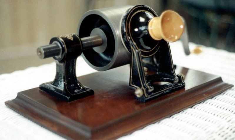

Re: Tinfoil Alert!
I have that model by Goodwin Ive in excellent original condition. I bought mine in 1977 or 1978. I had no idea they were so rare. The mahogany base warped slightly on mine, but not enough to put the screw into a bind. They actually work pretty well. Since I could not find genuine tin foil years ago, I used self-adhesive aluminium duct tape, which isn't ideal (too thick and sounds raspy), but it works. I cut the foil long enough to allow an overlap of 1/16" inch. I used a rolled-up sock to burnish the foil on a smooth surface, then peeled the paper backing and applied the foil. I burnished the overlapped seam to minimise a clicking sound when the needle passed over. The fussiest part is laterally aligning the needle with the grooves on the mandrel; finer screw threads would have helped. Vertical adjustment is easy; lower the recorder until it just touches the foil.
Many original tinfoil phonographs had a slot cut across the cylinder to tuck in the ends of the foil, and a thin metal strip was wedged into the slot to hold the foil in place. As a result, there would be a slight gap in the recorded sound.

Another of these machines, correctly described as a Goodwin Ive, appeared at the SAS sale on May 23rd 2012. It sold for a hammer price of GBP£480.
Unlike the example currently on eBay UK, it appeared to have the style of base which other owners have pictured on this thread.
