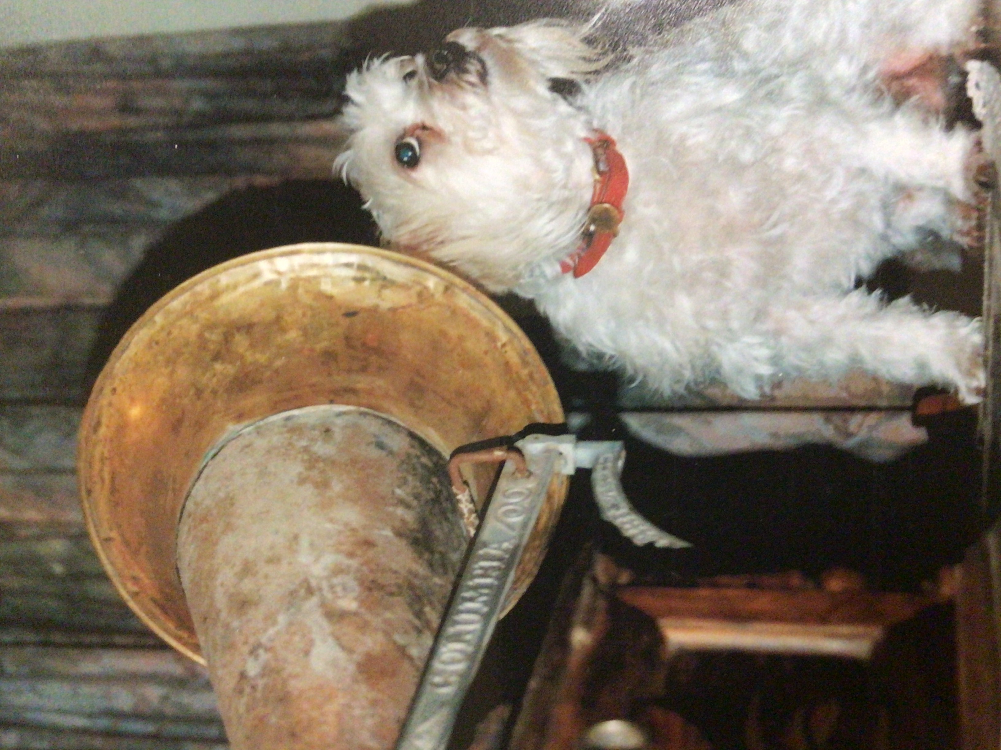

I am in the process of restoring a 1904 ish Columbia AH machine but the tin section of the horn is badly rusted. I presume finding a competent tinsmith is my best option here as the brass bell seems ok. Another possibility is to make some sort of insert and try and patch things...? Does anyone have any thoughts about a positive way forward? The rest of the machine seems OK except for some oak laminate lifting on the plinth.
The other thing I need to consider is sourcing an elbow for the horn after it is restored. I imagine a reproduction elbow would be easiest but would value any thoughts as to where I could enquire. I have seen leather elbows on some early machines too.
Thanks for any thoughts on my project and I hope the pic of the horn comes through OK

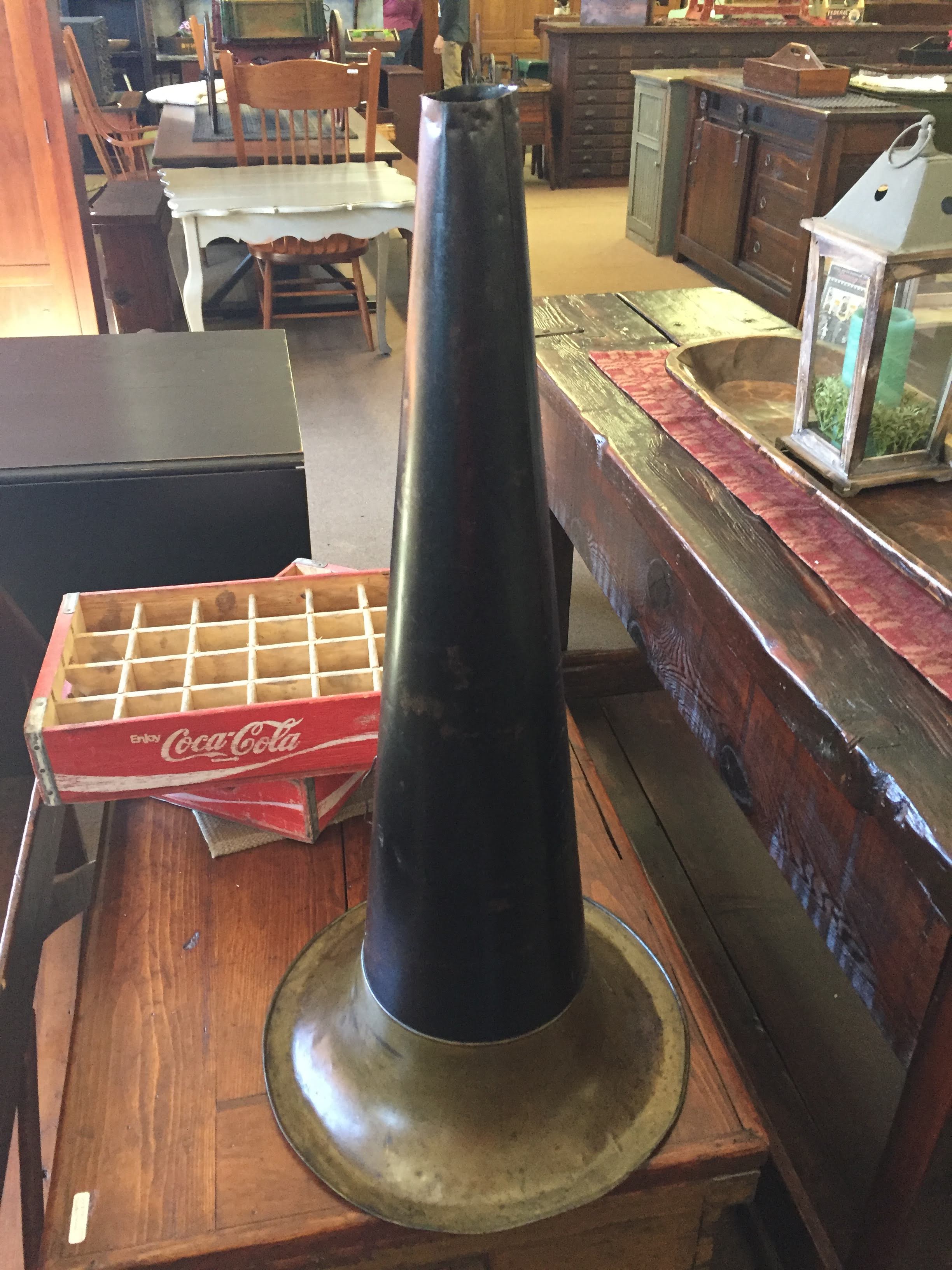

Yup, like others said that horn is shot. I had that same disappointment when I found this horn in an antique store a couple years ago.

My sincere thanks for all your perspectives and I now feel more alert to possibilities etc.
I do have the opportunity to chat with a local tinsmith but my gut feeling is that it may be too complex / pricey to complete a graft with the existing bell. Another thought is to take up Mike’s offer as his horn ‘section’ sounds about right, but postage to Aus may be prohibitive. I will also enquire at our local phonograph societies and see if something may emerge. I have not yet made contact with any local enthusiasts at this point in time.
Presently I don’t have the machine at hand except for the reproducer which has already been restored. Alas, I do have a pic taken decades ago of the AH in question but it doesn’t reveal much. I think it has a centrally located crank unlike the very early machines. In the next few weeks I will retrieve it from storage and get the ball rolling. Again my sincere thanks for your shared expertise and pathways. I’ll post some more pics as the story unfolds.
Meanwhile is is a pic of my parents dog (Chester) at the helm and another of the reproducer.

Greetings - I’m pleased to say that a local tinsmith has offered to reconstruct the rusted lower section of my existing Columbia AH horn for a reasonable price.
I just wonder if someone has a measurement from the join edge of the tin section ( not including the brass bell) to the narrow end of the cone? I also wonder how wide the opening is at the narrow end as well? Finally, I wonder what sort of elbow a 1904 AH may have used and if there are reproductions ( in brass) available? If I can’ t access an elbow, perhaps I may get a leather one made up. Does anyone have a template for this?
Thanks for any consideration and perhaps a close up pic of the elbow and cone end may be helpful but no expectations.
