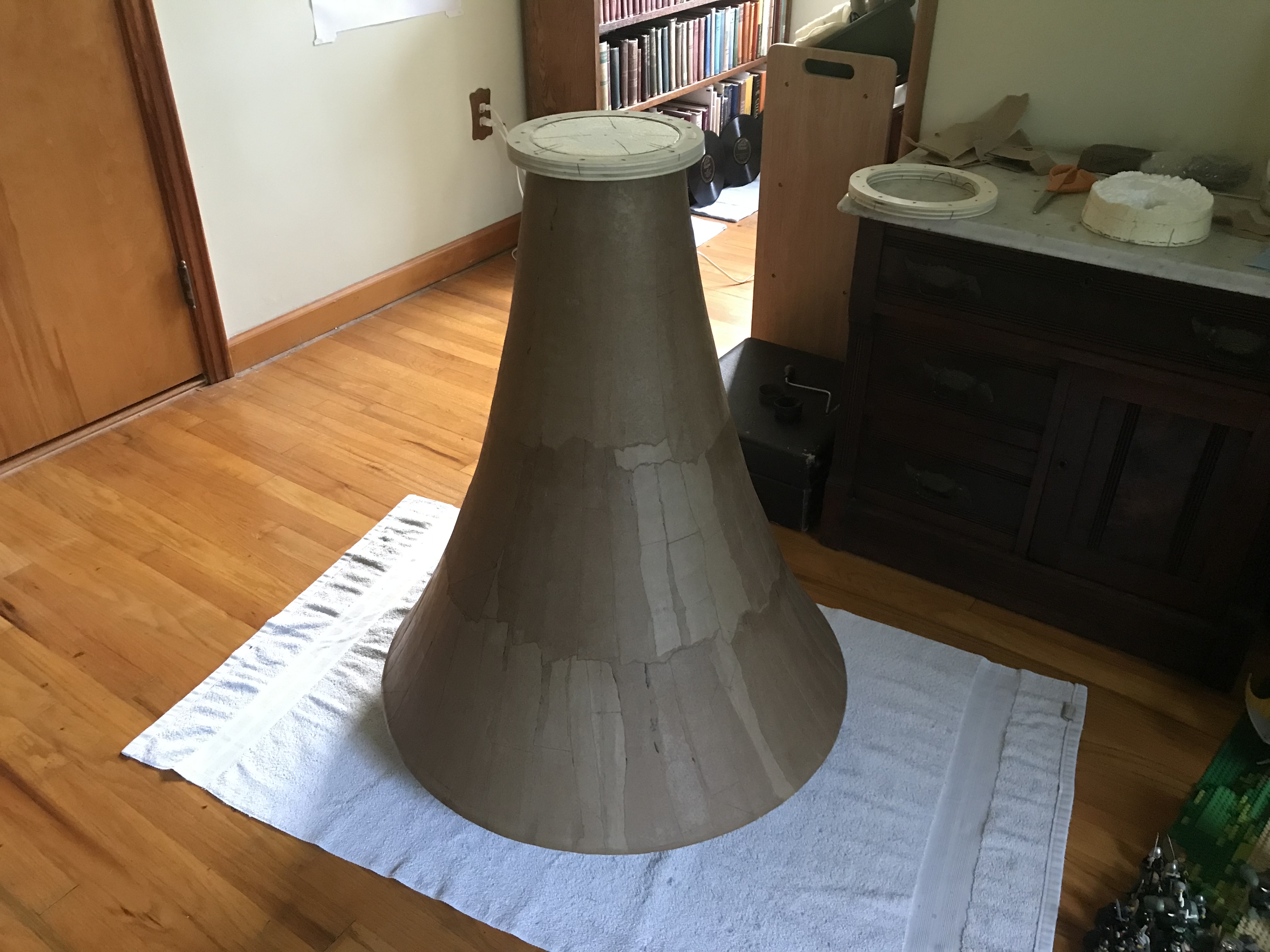

Alastair, it is what they're saying... To install the border reinforcement ring and then cover it with the last layers of paper. Your idea of it being rough, so the paper adheres better to it, is the thing to do... I was thinking more about choosing a perfectly smooth ring, and installing it at the end, over the paper, so the ring was the finishing at the border.

At any rate, I don’t have any suitable hoses at the moment, but I do have some wood, so to start, I’ll try something along the lines of the Expert ring embedded in the horn, but made from wood instead; when I apply the first layer of paper, I’ll let the ends near the mouth overhang by a few inches, then add the ring, build up the rest of the layers over it, and then fold the loose ends of the first layer back over the ring and final layers.

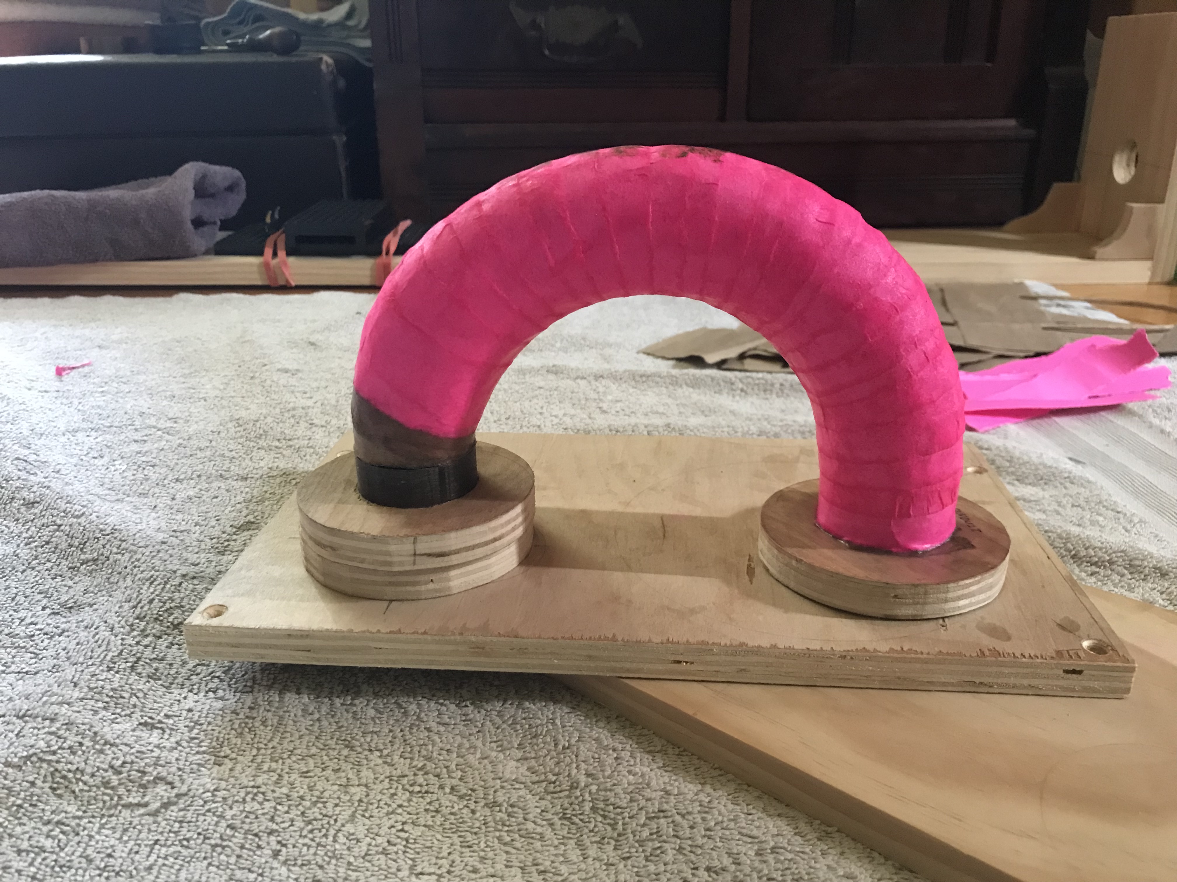

The former is now completely removed, after being partly dissolved with D-limonene, partly pushed out from the throat (once most of it was dissolved), and partly scraped out by hand; now I can attach the wood mounting ring at the large end and continue adding layers over that.
While I was waiting for the former to dissolve, I started work on the internal conduit, and began removing its former as well; it seems to be coming out more easily, so if I can make a wood ramrod that reaches all the way around the curve, dissolving it shouldn’t be necessary.

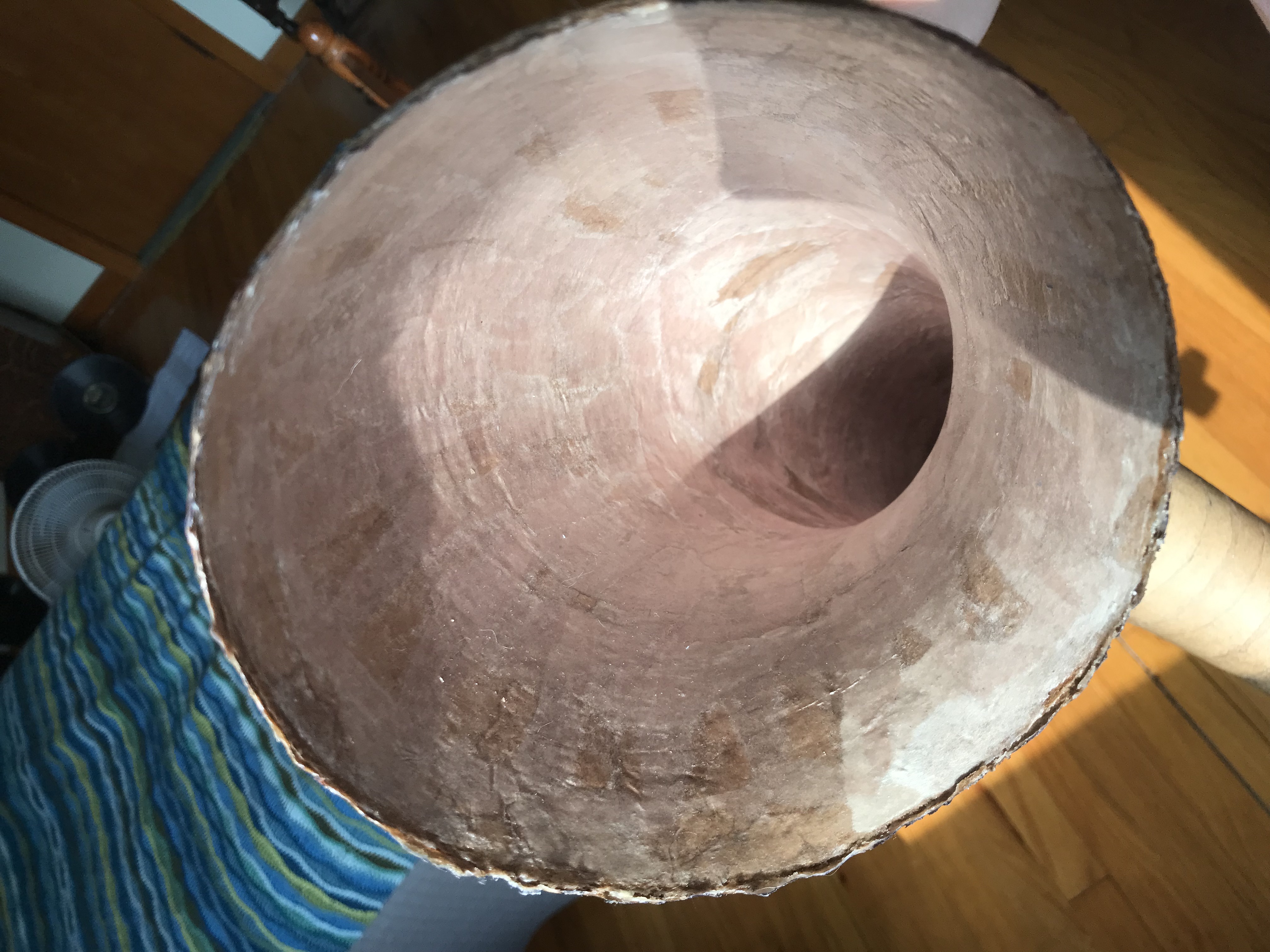

I started work on the mouth section, and just added the third layer (fifth and sixth, counting individual sheets) to-day; I mismeasured when cutting out the wood ring for the mouth—gave it a 12.75” radius instead of 13.75”—but then realized that I can just cut off the extra paper from each layer before adding the next, and fold a final layer over the cut edge after the horn is off the former.
Once the lower layers have dried, adding more wet layers on top makes the first layers expand, so the mouth keeps expanding and rippling as paper is added, but so far, it seems to shrink back and pull tight against the former—Could this be why homemade paper horns tend have wrinkly inner surfaces? And if so, has anyone else noticed it happening and found a way to prevent it?

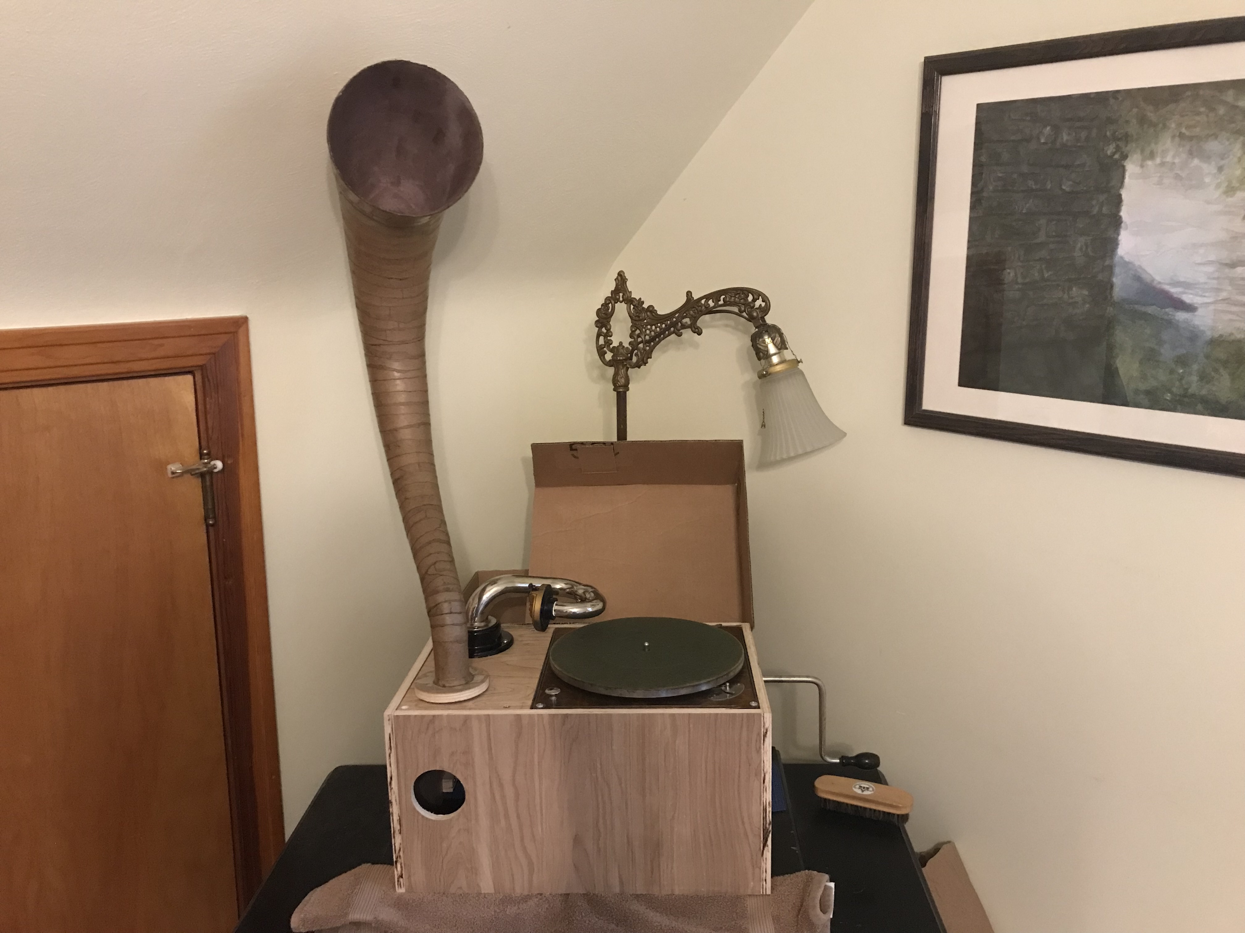

With the formers for the neck and internal conduit removed, I was finally able to hear the horn (or half of it, at least) in action, and for as small as the mouth is, it sounds surprisingly good—compared to my only reference, a Victrola Alhambra, its bass is rather lacking (and the Alhambra has the small, straight Orthophonic horn, so even it doesn’t have much bass) and the frequency response sounds slightly peakier, but it seems indescribably “less flat”, “less restricted,” and “more open”—it’s a difference that I’ve noticed with some experimental horns, and I usually attribute it to a better treble response, but it could also have to do with the shape of the emerging wave-front, as the Alhambra’s mouth is rectangular while the half-horn’s is round.

Since Wednesday, I’ve added just over two more layers of paper to the mouth, for a total of four and part of the fifth—my current plan is to stop at six layers, so it should be able to come off the former soon—and I installed the wood mounting ring.
A decorative marbled paper is a good idea—when I began the project, I wasn’t at all sure that it would turn out well enough to warrant a decorative finishing paper, but based on how just the half-horn sounds, I think it will…When I tested it Wednesday, I used my not-as-good Orthophonic soundbox, but after taking my better soundbox from the Alhambra and putting it on the homemade gramophone, the sound quality is much better; the frequency response is less peaky and the “more open” quality is more noticeable—for records in good condition, I would say that it sounds better than the Alhambra at this point. Interestingly, worn records sound more worn with the half-horn than with the Alhambra, even with the same soundbox and type of needle—Perhaps the narrower frequency response of the latter filters out more of a worn record’s surface noise and high-frequency distortion?

Re: Homemade Exponential Horn Project
