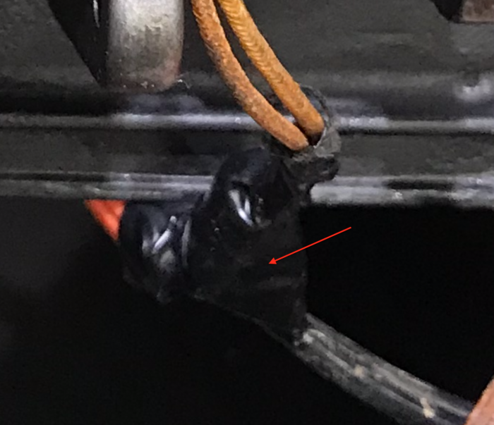

I would leave it as is, maybe replace the wiring with modern cloth covered wire and add some type of variac as a speed control, since it doesn't appear to have a governor... I always wanted an electric cylinder player... no more winding.
![Wink ;)](./images/smilies/icon_e_wink.gif)
It's an amazing conversion, since everything fits like it was born that way...
Most of the original wiring looks OK, but I would replace the power cord and get rid of the electrical tape connection. Solder the connection and use heat shrink insulation...
