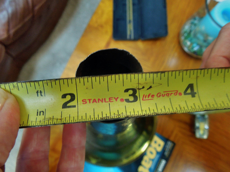

Please excuse my cross post with the ‘tips and tricks’ forum but I am hoping to seek some measurements in ernest and I have a tinsmith waiting in the wings - i would be deeply grateful if someone could give me a measurement and maybe a closeup pic or two of the narrow end.

Also, the diameter of the narrow opening would be good to know and maybe a close-up picture of this end this may help with the remanufacture of the horn. I think there is a step but am not certain?

My original AH horn has a total length from the small end to the base of the brass bell of 15 inches.
The length of the reduced area that fits inside the elbow is a hair over ¾ inch.
The diameter of the reduced area that fits inside the elbow is just shy of 1 ⅛ inch.
See attached pic's
Hope this helps.
Blizz
