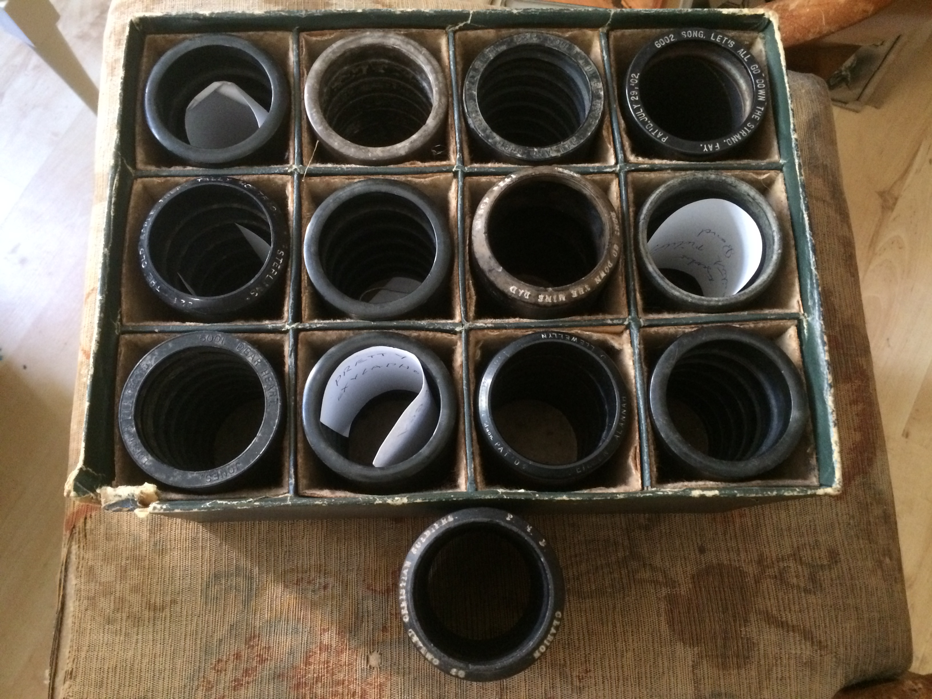

Arguably/possibly this thread should be in the UK section as this is a UK variant, but I believe it's basically a generic US machine - although admittedly, I have almost no knowledge in this area! Cylinder phonographs aren't my main "thing", but I couldn't help but have this accompany me home from an antiques fair today. I paid £140 (that's around $195) including 13 cylinders but no horn. I would welcome all comments, information and advice please!
Obvious problems are - the rubber belt? - a stack of washers under the bolt that holds the feedscrew knife edge bracket (I have no idea what the proper terms are for these parts!) - speed out of range (fastest is too slow) and warbles wildly - and most seriously, although there is sound, playing a (black) cylinder generates quite a lot of pale amber coloured dust. Obviously I won't play any more cylinders for now.

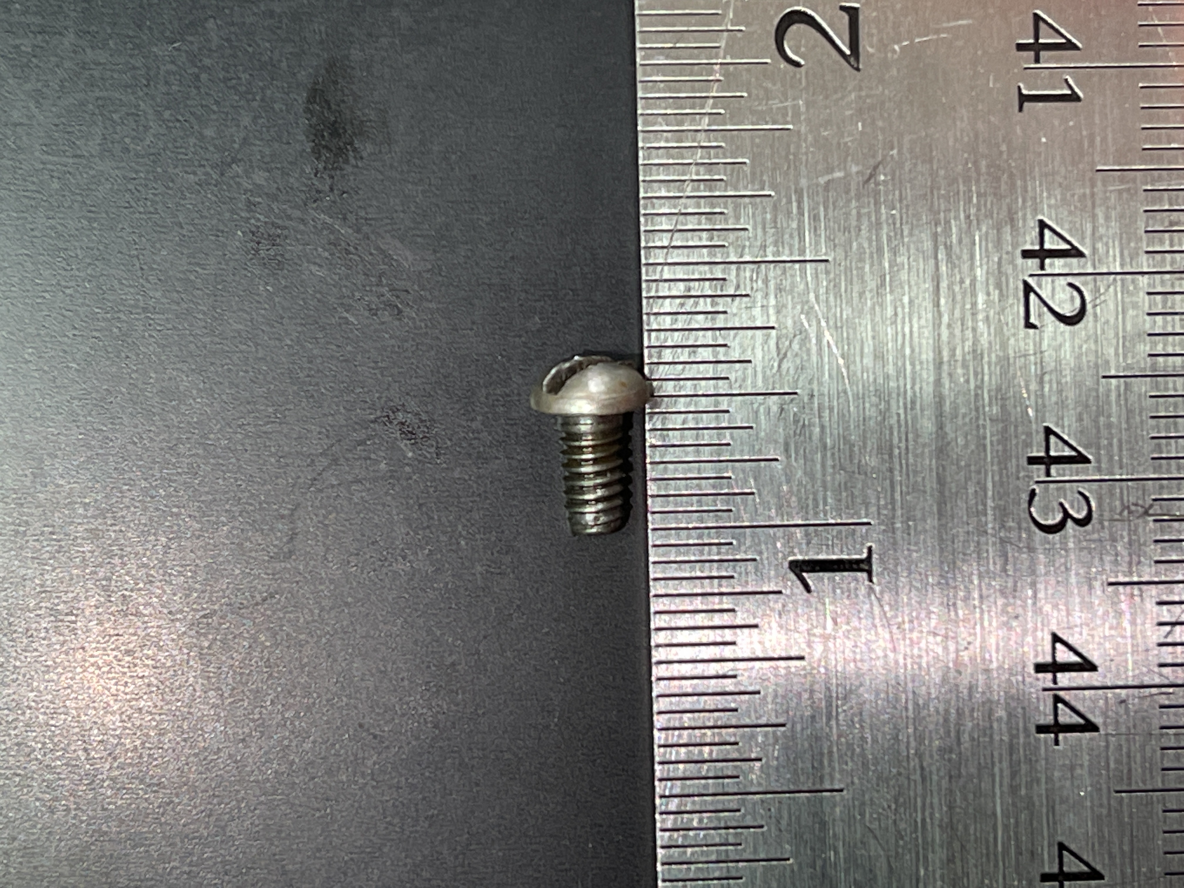

I have no idea about those washers holding the halfnut in place. Maybe it was DIY repair?

Halfnut washer issue:
Whoever repaired the machine last did not have the correct size screw for the half nut so they used a longer screw and washers to make up the space differential. See pic for correct size. There should be 2 screws securing the feednut bar so if you have the other one you have a guide to get the one you need.

I agree, the belt probably is part of the problem, but it probably isn't everything. I'd guess the motor needs a good cleaning and lubrication as well. Since it's running too slow, it also needs adjustment; David's right, the governor is likely off, although he got it the wrong way 'round, since you say the machine runs too slow, not too fast. As to that amber dust: did the black cylinder have brown spots or blotches on it? If so, those are mold, which is the death of wax cylinders. I don't know why, but in my experience European cylinders seem more prone to it than their American Edison counterparts. I have the impression even the Edison foreign language series cylinders are more prone to mold issues than the domestic product.

Thanks - no, the cylinders are really clean, so I'm guessing the "C" reproducer might have a chipped stylus? Unless a previous owner has treated the surface of the cylinders with something that has now hardened in the grooves? I must try to look at the stylus under magnification.drh wrote: ↑Sat Sep 11, 2021 2:09 pm I agree, the belt probably is part of the problem, but it probably isn't everything. I'd guess the motor needs a good cleaning and lubrication as well. Since it's running too slow, it also needs adjustment; David's right, the governor is likely off, although he got it the wrong way 'round, since you say the machine runs too slow, not too fast. As to that amber dust: did the black cylinder have brown spots or blotches on it? If so, those are mold, which is the death of wax cylinders. I don't know why, but in my experience European cylinders seem more prone to it than their American Edison counterparts. I have the impression even the Edison foreign language series cylinders are more prone to mold issues than the domestic product.

I think I have a spare piece of Wyatts belting, I can rotate the stylus too if it is at fault, I may even have a screw to fit the half nut arm, doesn't seem too hard to bring up to scratch
