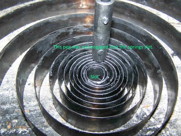

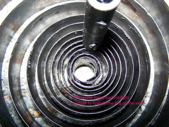

The peg off the axle had become disengaged from the slot in the centre of the spring.
This happened because the last centre spiral was not tight enough to hug the axle, matter of fact the last spiral was hugging the spring.
In the photo's, I have started working the spring to become tight up against the axle.
I think once it's engaged the center will properly wrap itself around the axle again once it's would to the top.
How did this happen, it can't be wound backwards ?

Yes and yes. That could be the reason for disengaging. Also, it is always advisable not to let the motor run down completely, as this can disengage the center hub, better to run down until the point where the springs still keep some tension.
