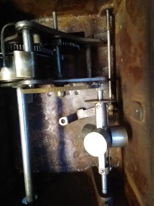

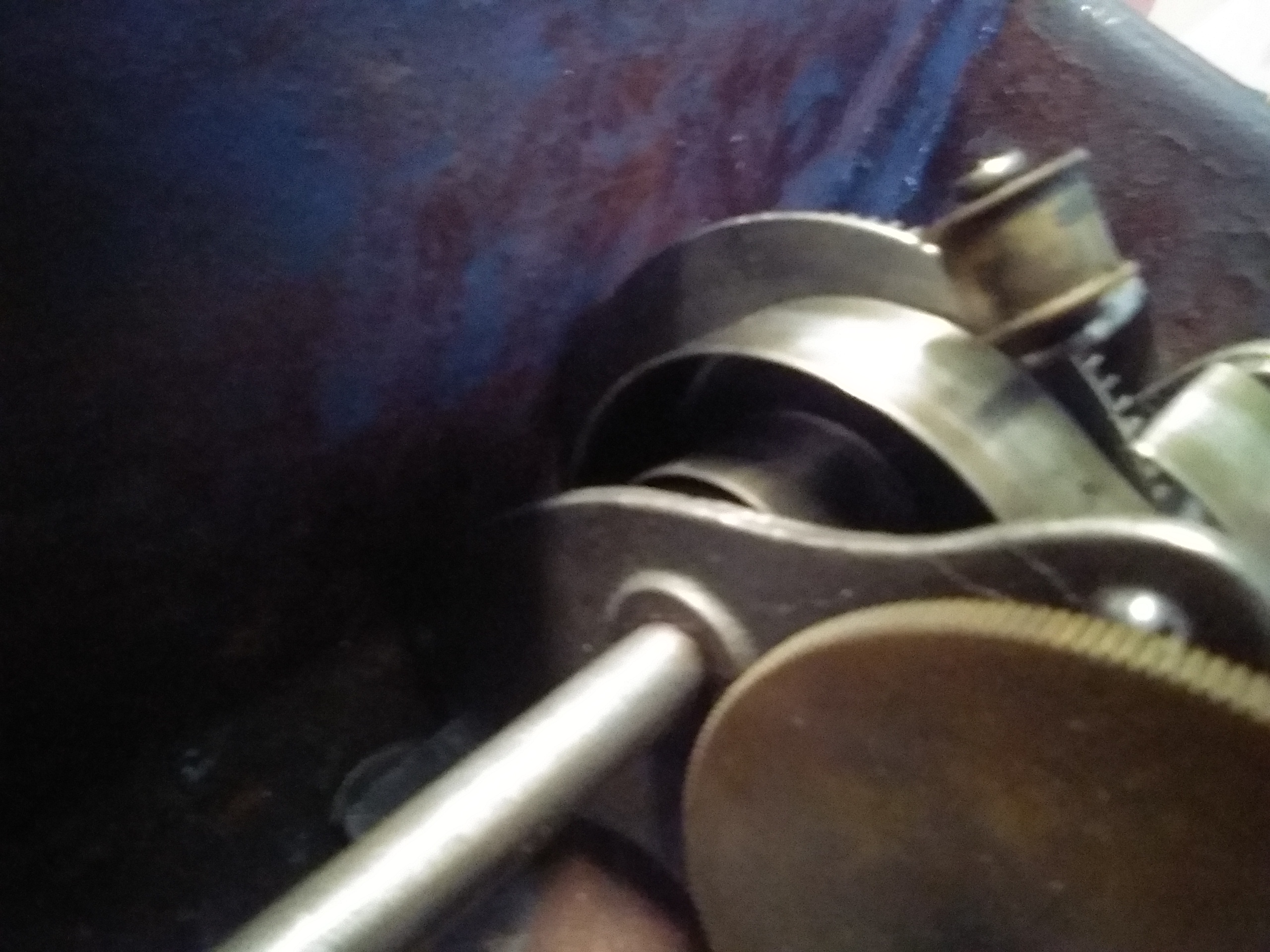

Look at this mess inside.
Quick look at the broken mainspring, the bent arm and idler pulley, and the background of iron rust. Most Gems need new mainsprings anyway though to boost playing time. Glad the governor is OK -- I turned one of the large gears by hand and the governor took off running smooth and strong, no wobbling on the friction disc. That's good news.
Getting this running will be mostly installing replacement parts with a bit of reshaping & touching up. If I had a lathe I'd machine a new end for the mandrel. Aluminum would be a better replacement for cheap diecast.
And I needed Edison parts anyway as I'm fixing the Home B. This probably will take a long time; don't hold your breath. But there's another machine in preservation that will be playing cylinders soon enough.

This morning,having no time to work on it, I dropped some oil into the bearings on the topworks and spun the mandrel over by hand. It rolls nicely but the surface of the mandrel pulley is out of round--this thing is going to sound horrible unless it's changed. So there's that.

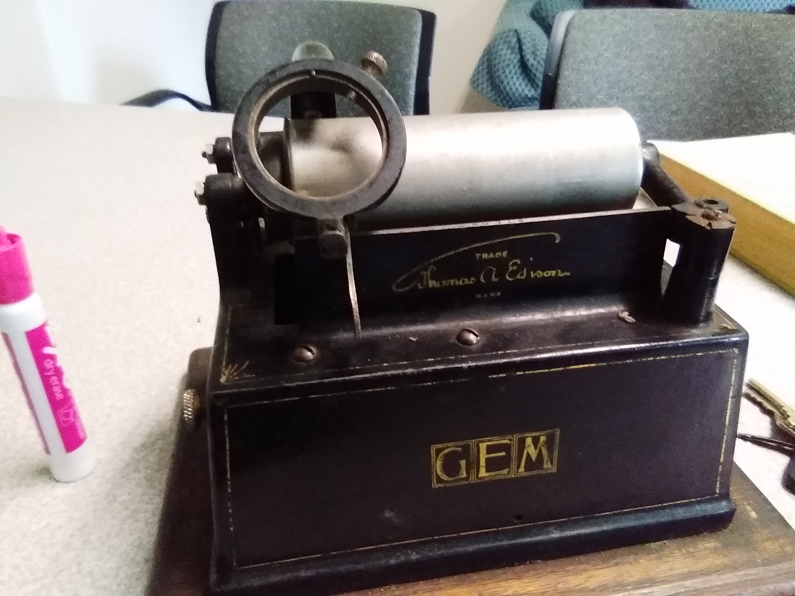

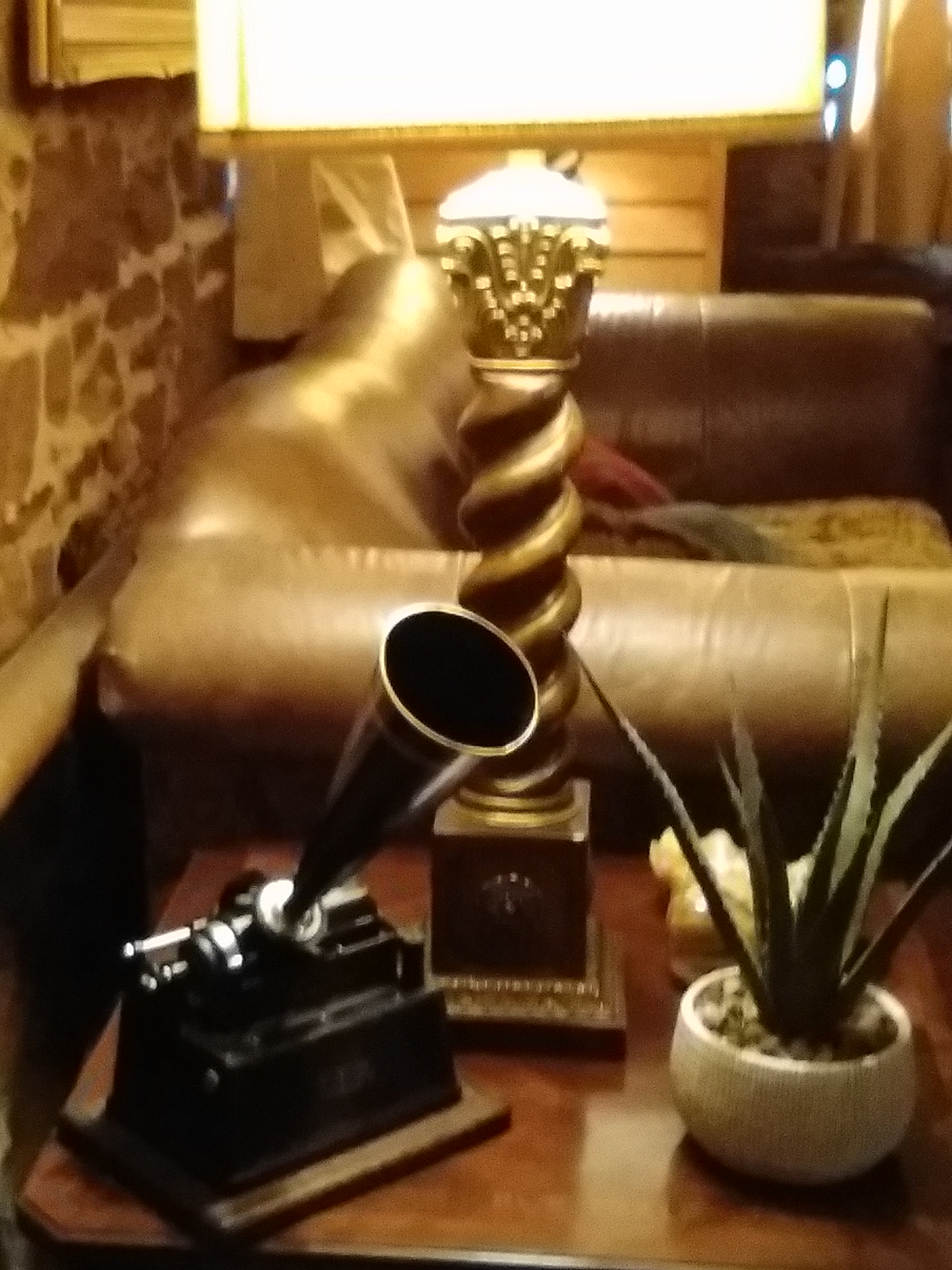

Quick mockup with a new horn and the K reproducer off the Fireside (and the K does it no good as this is 2m only.) Going to be a slow project.
I found out the threads for small screws inside the casting are the same thread as others used on it so hopefully re-attaching the brake assembly will be easy.
