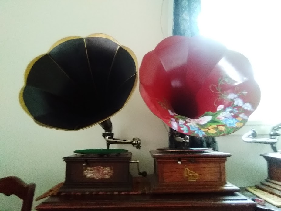

The horn is a repaint of a horn that probably came off an old BI originally. It seems bigger than the ones I've seen on Standards before, and measures to 18.5" across the bell. I don't think it is the correct horn but then this machine does not have the original, correct turntable on it any more either. It's got one that is either off a late machine or that has been turned down to match a conventional Victor or Columbia record.
With the Analyzing reproducer and the BN style horn on it, it's the Standard that sounds like the BN that it isn't. So here's a picture comparing the Standard with an old BN.

It does seem like a bit of one to me as well, almost like a hint of a Frankenphone that used a mix of Columbia and Standard components.
