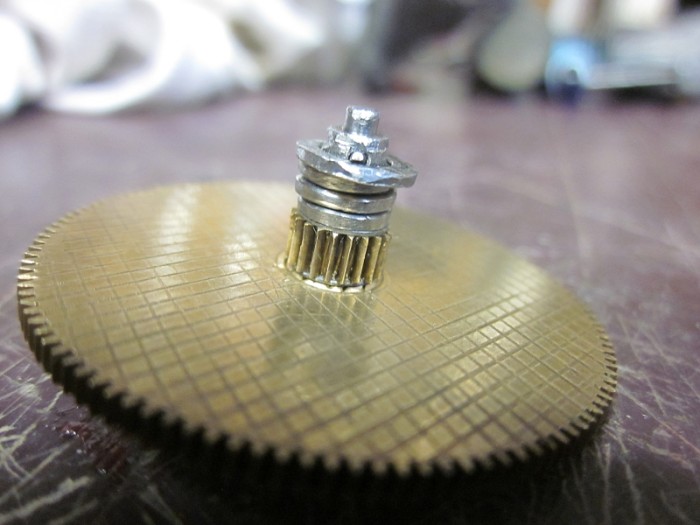

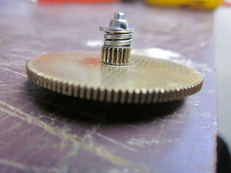

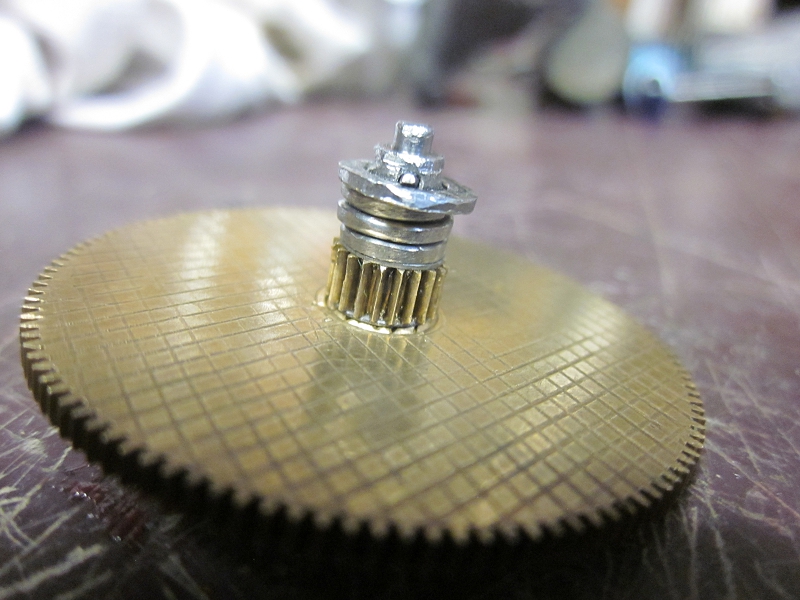

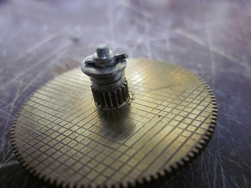

Re: Help Request - Sonora Auto Stop
Here are some close-up shots of the torsion clutch. The parts are tiny and the idea of taking it apart has me intimidated. Until I find a definitive answer, I will continue to manually push the stop lever. I can see why Sonora abandoned this braking mechanism the following year. Rube Goldberg would have liked it. https://youtu.be/40AO2RdEixs
- Posts: 364
- Joined: Tue Aug 14, 2018 7:35 pm
- Location: Syracuse N.Y.
You'd have to push down on the spring and then pull the retaining pin. I doubt you'd gain anything from it. But you might soak the entire assembly in parts cleaner for some time just in case excess oil might have gotten into the spring/shaft area that shouldn't be there. But it probably should have a very tiny amount of oil in it so it can slip when it needs to such as when the lever gets reset.
Thanks for your advice. I tried removing any accumulated oil by washing it with an old toothbrush, detergent and water. I carefully dried it and put it back together. It had no benefit. I didn't add a tiny amount of oil, but I will. I have examined the switch carefully and it works effortlessly. At this point my best guess is that the design was flawed when drawn up in 1913. Getting it to work again might only be temporary. Still, I like a challenge and maybe a solution will present itself. I'm in no rush and I am patient.pallophotophone wrote: Sat Apr 01, 2023 1:30 pm You'd have to push down on the spring and then pull the retaining pin. I doubt you'd gain anything from it. But you might soak the entire assembly in parts cleaner for some time just in case excess oil might have gotten into the spring/shaft area that shouldn't be there. But it probably should have a very tiny amount of oil in it so it can slip when it needs to such as when the lever gets reset.
