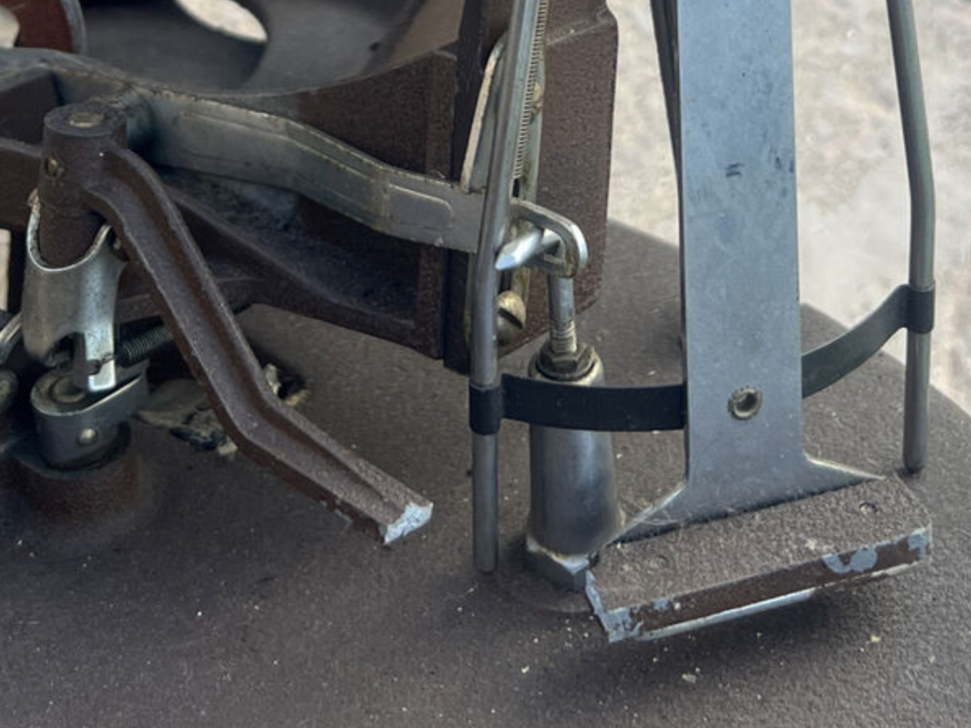

We are exploring the need for producing some replacement parts for the pre-war 16-E changer. The first project will be an exact replacement for the often-broken turn over arm. Like the Victor changer parts we made, the arm will be a fully finished drop in replacement. Please contact us if you’d like to be on the list for updates. If there is enough interest we’ll go ahead with the project.

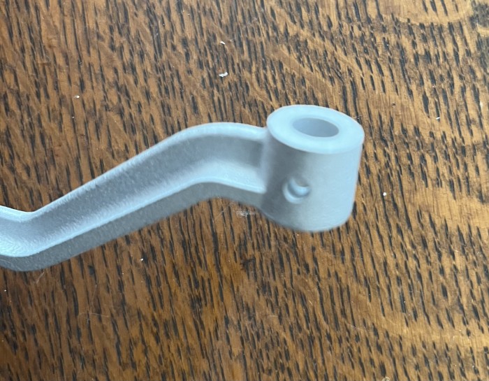

Capehart Enthusiasts,

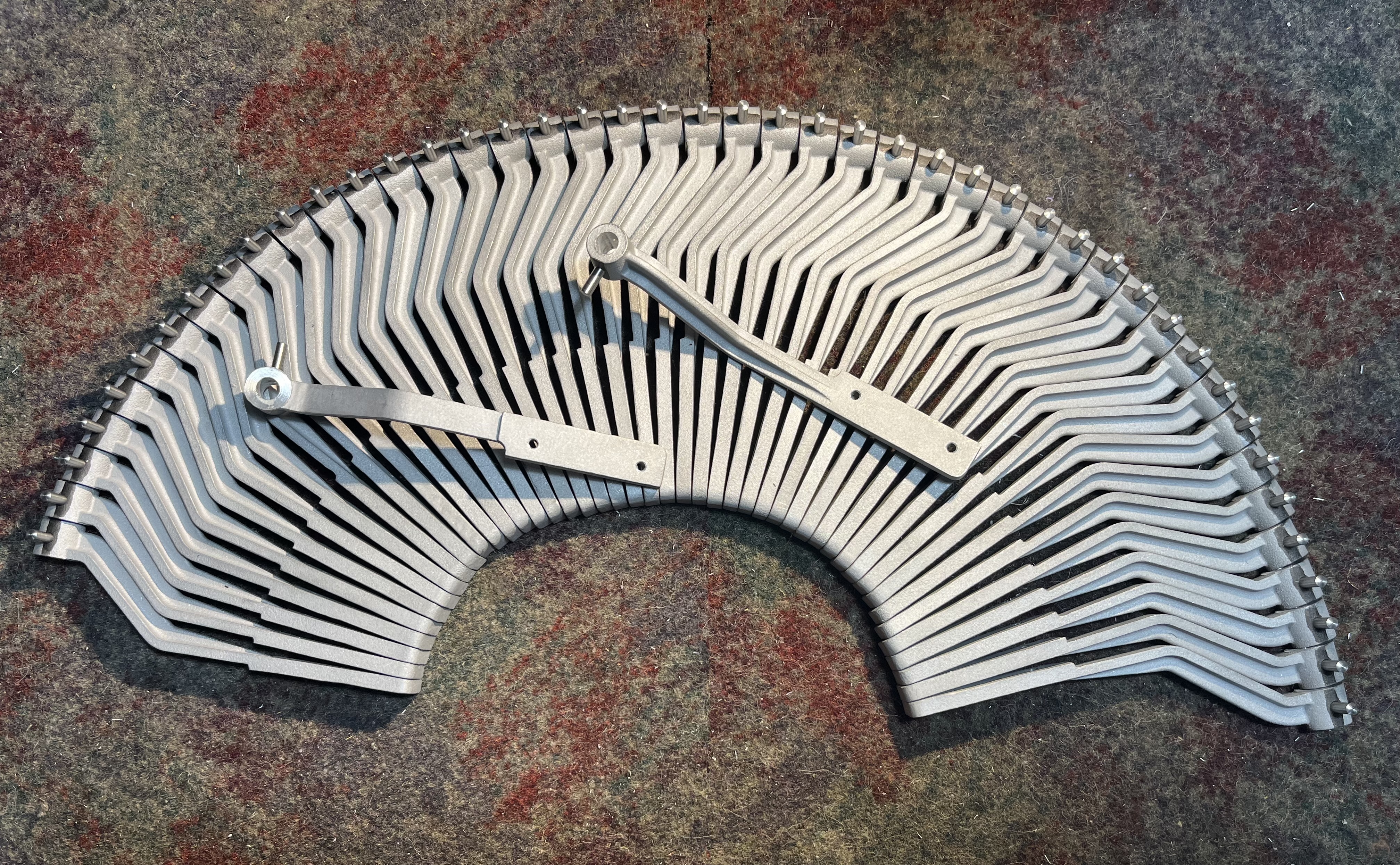

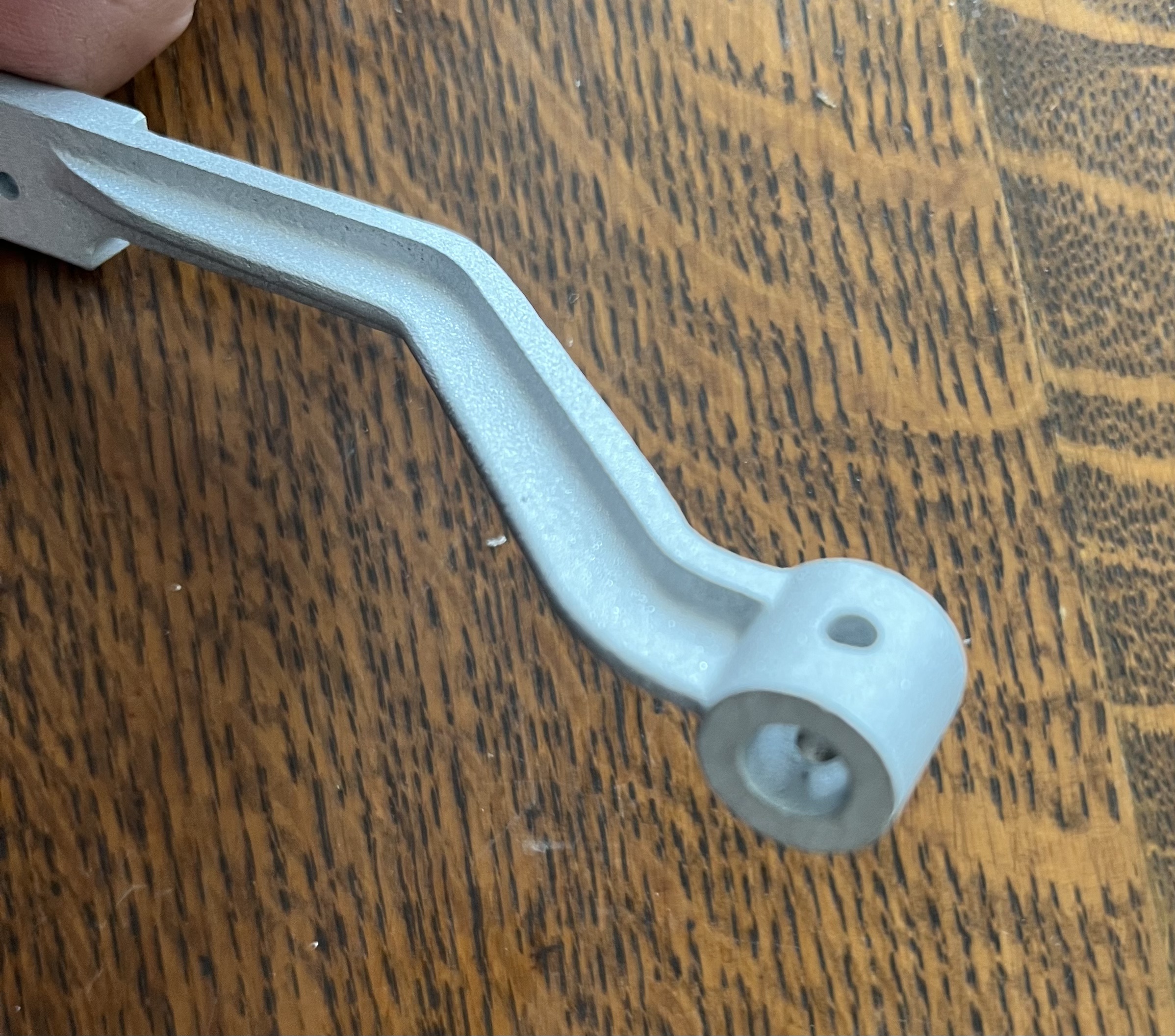

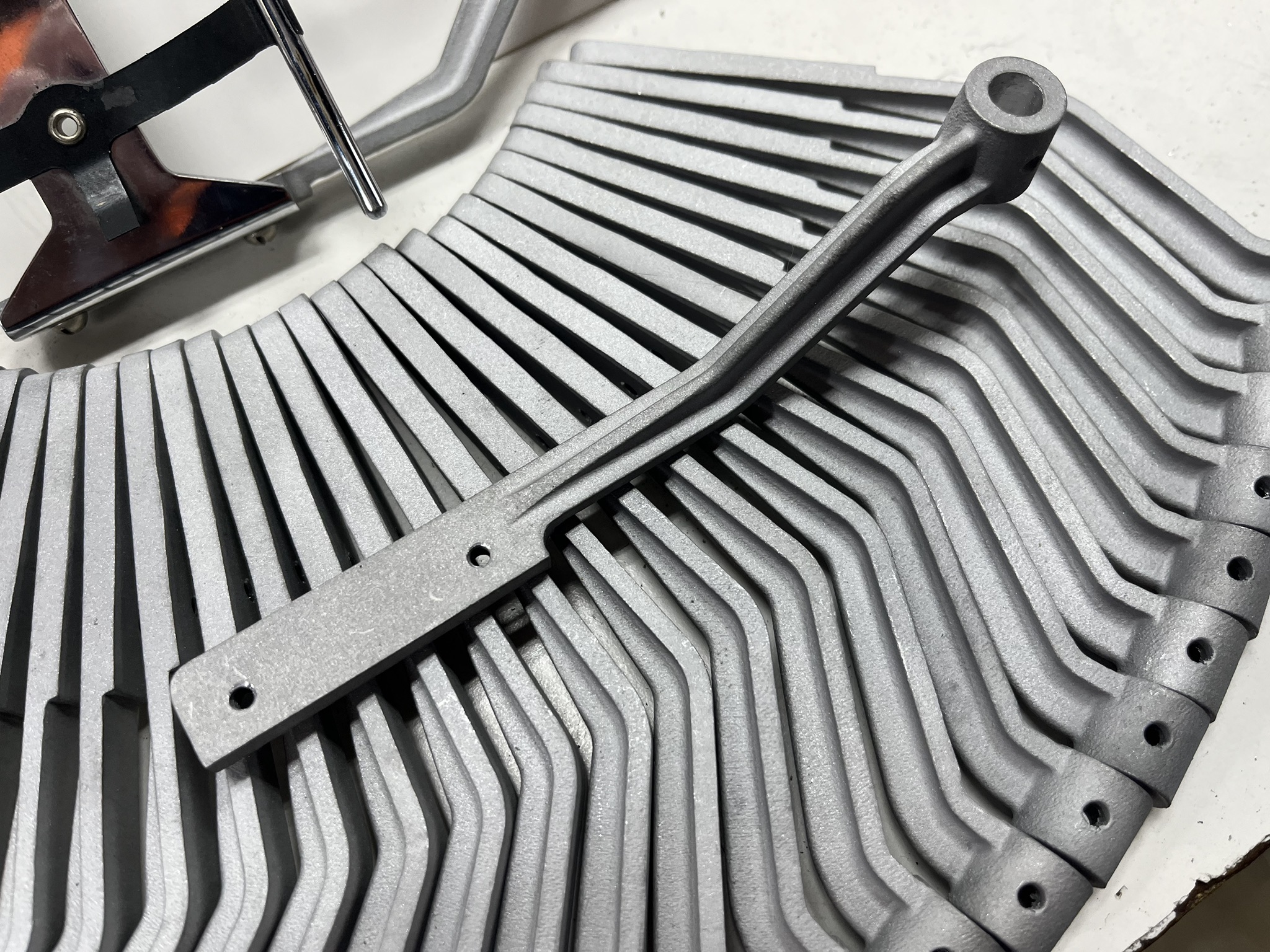

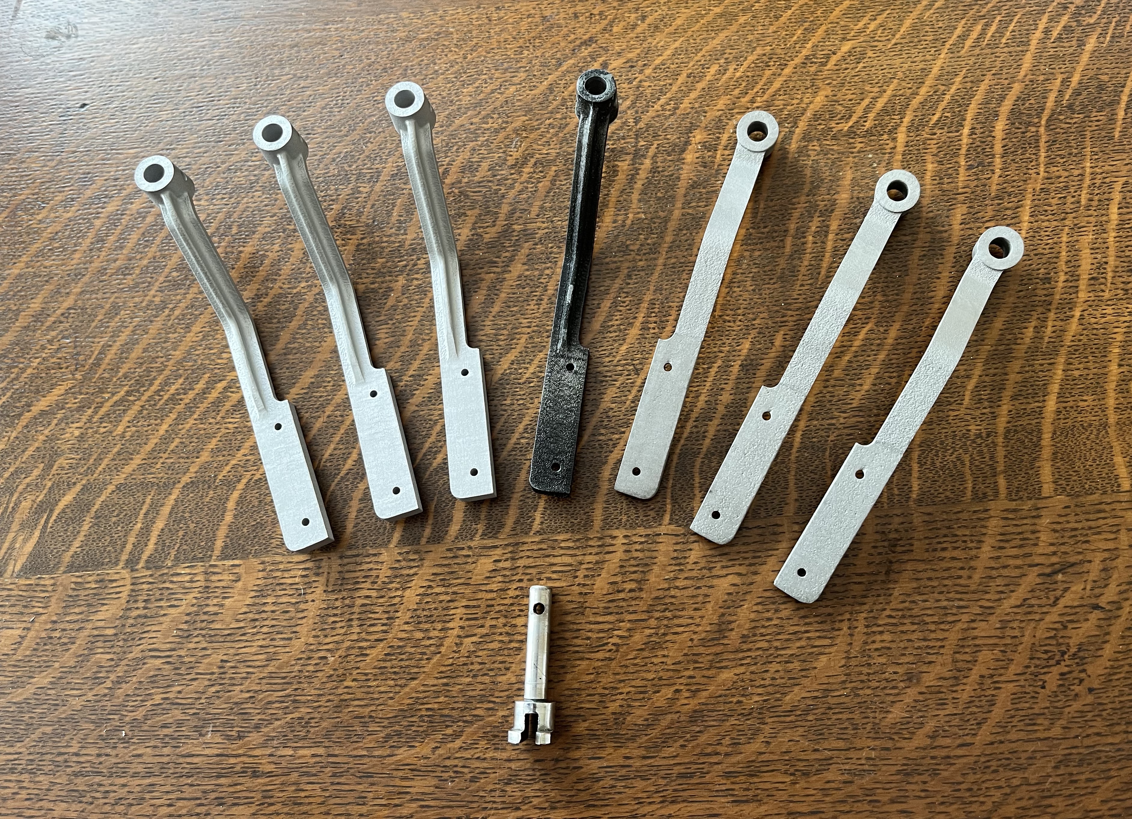

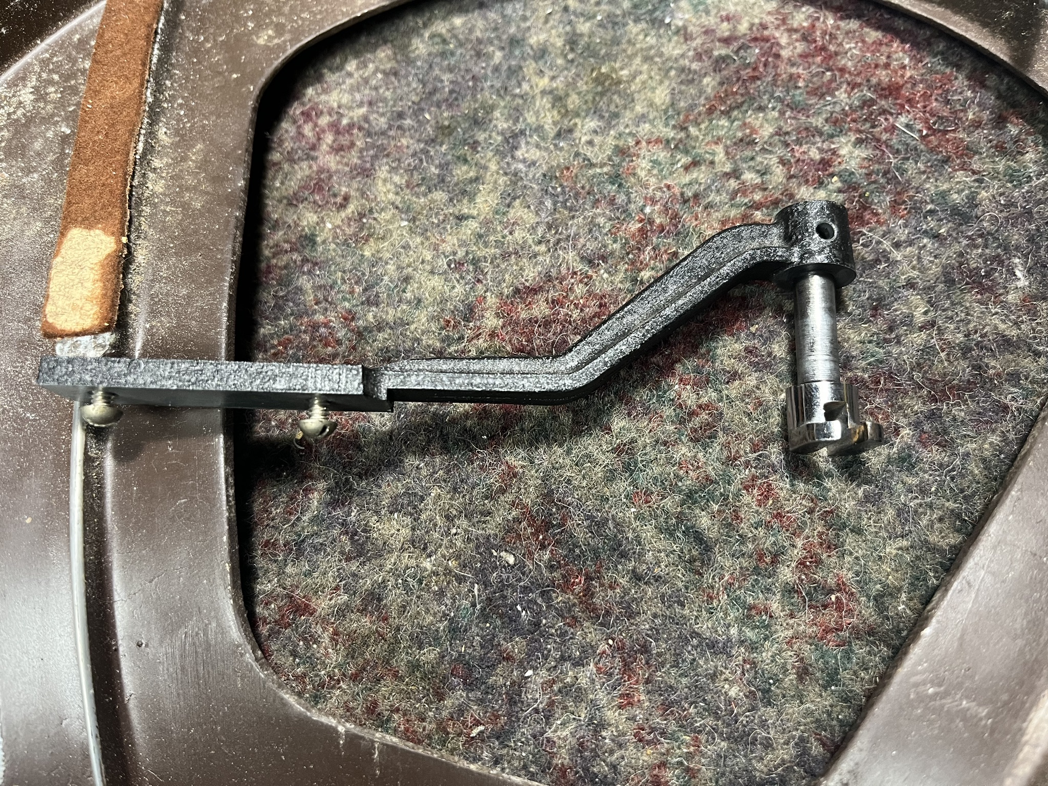

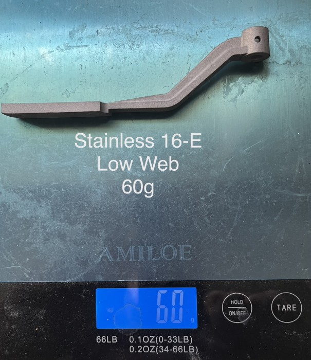

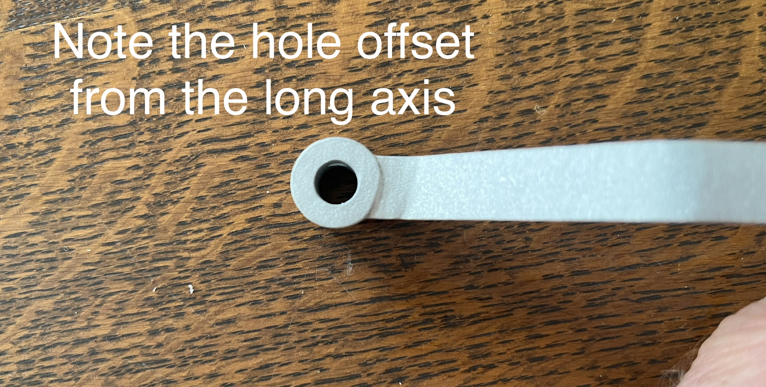

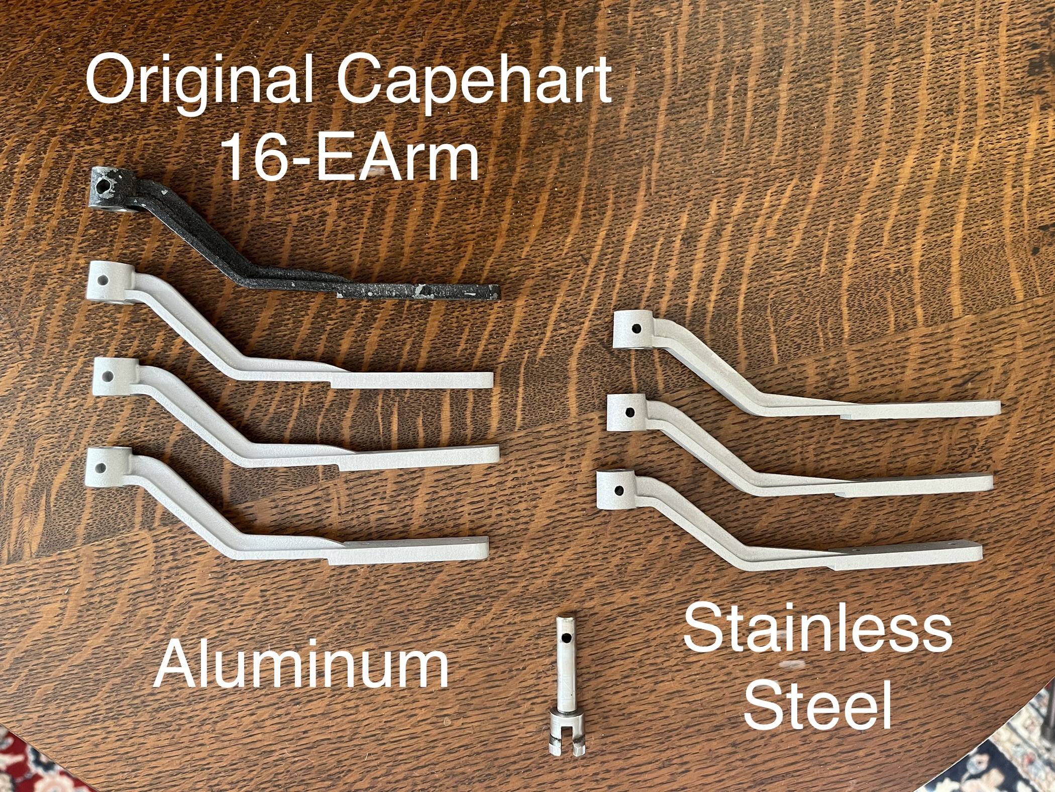

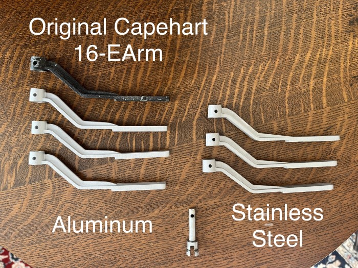

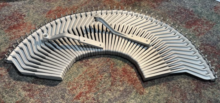

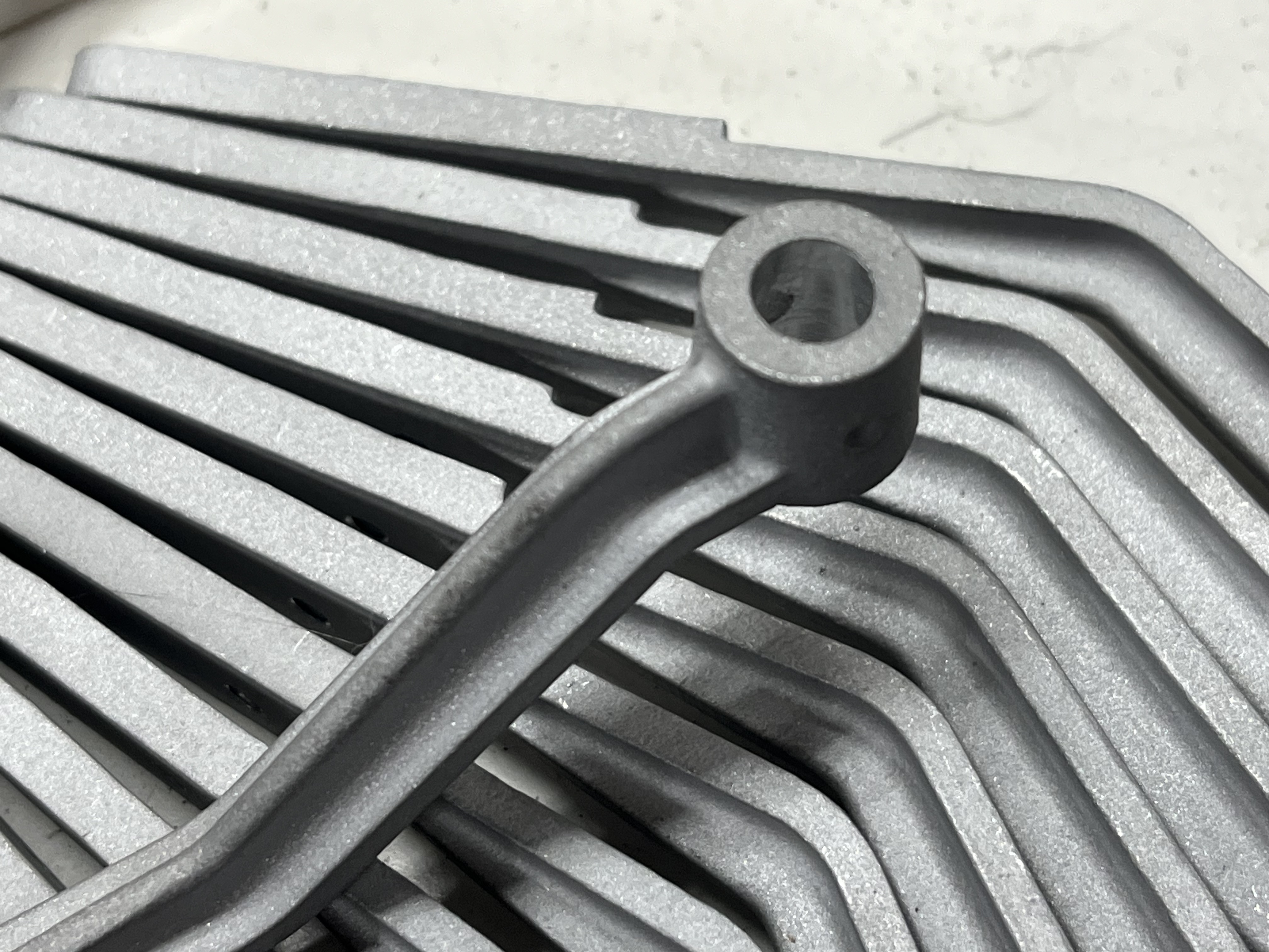

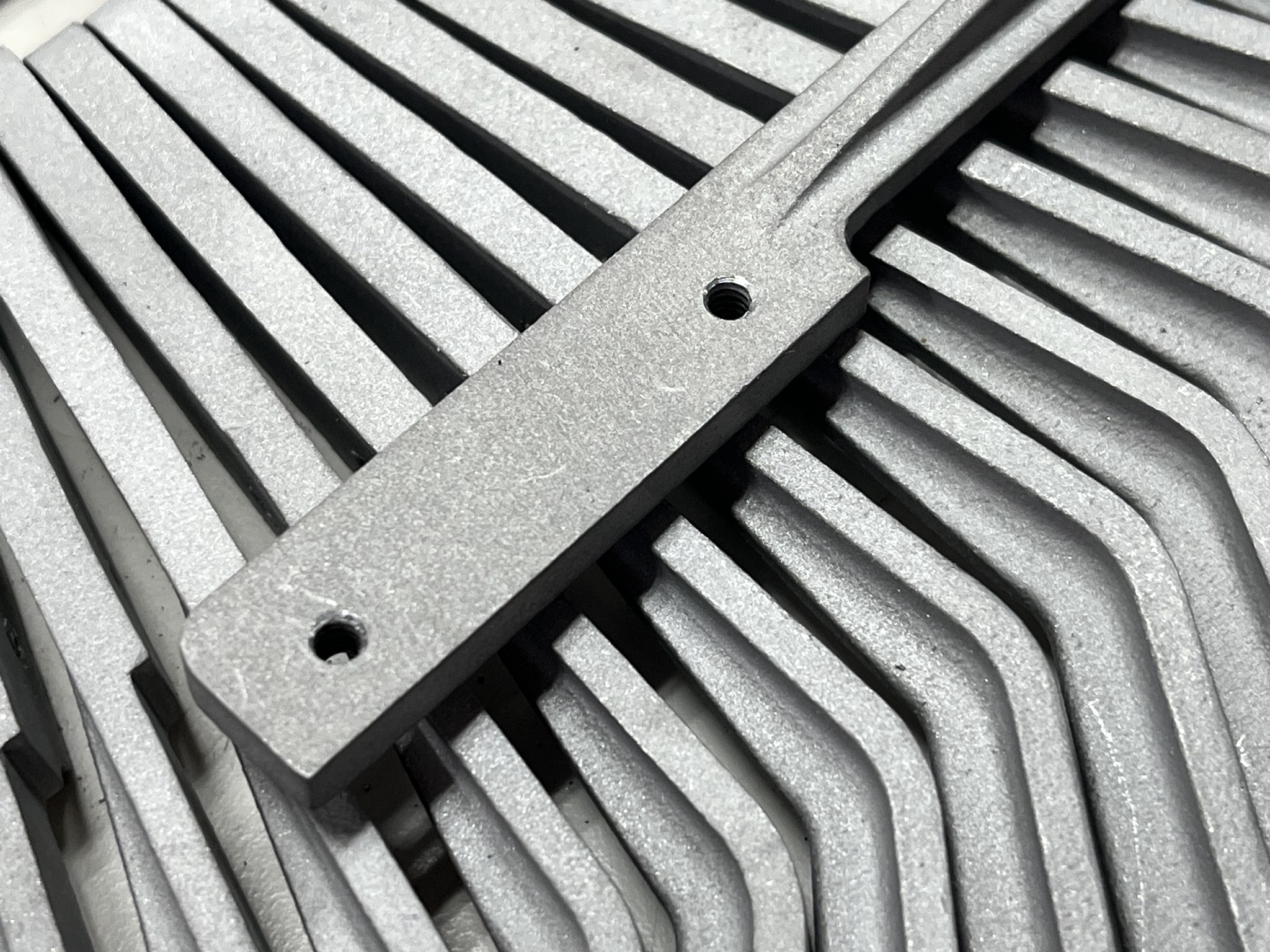

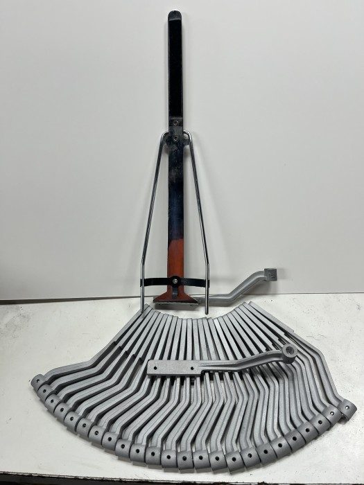

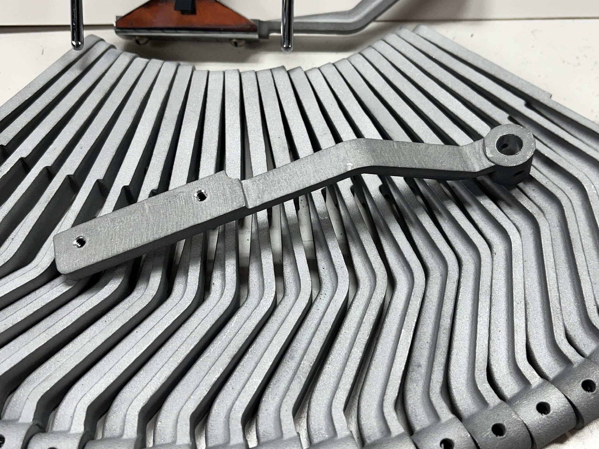

We’ve been making steady progress on the turnover arm project for the 16-E changer. Here are some photos of the first articles received recently. Design verification, machining and testing will follow. They look pretty good by eye but much work is needed before making them available to the collecting community. The first articles were made in both aluminum and stainless steel for testing. Notice the two different web profiles, we’ve encountered examples of both types.
Please send a private email to VictrolaParts@gmail.com if you would like to be on the availability notification list.
Mark & Bronson

We are nearing completion of the Capehart 16-E reverse arms. They are in the final functional test and we expect release by mid-May.
There are a limited number and many have been pre-ordered. Please send an email to VictrolaParts@gmail.com to be notified when they are ready to ship.

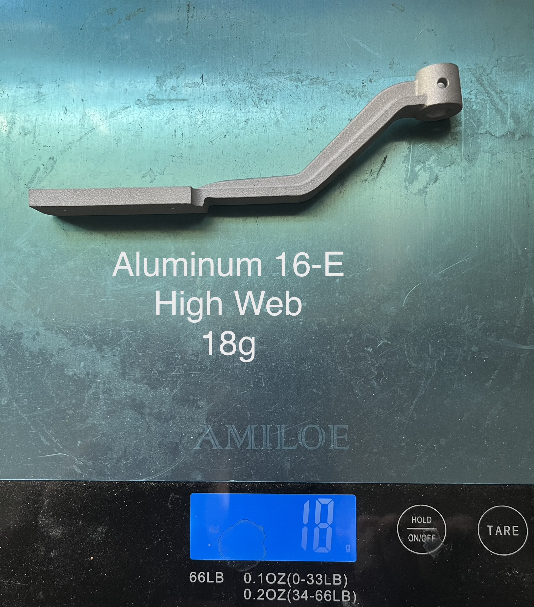

After extensive testing the new aluminum Capehart 16-E reverse arms are ready to send out to all the patient collectors that have been waiting for these. A few remain unreserved. Send an email to VictrolaParts@gmail.com for details.
Thanks,
Mark & Bronson
