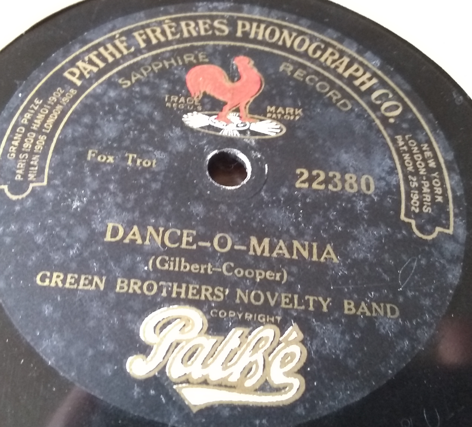

I have no experience with vertically cut disks at all (except with an Edison disk that I tried playing on my Aeolian Vocalian machine using a cactus needle - sounded good for all of 20 seconds or so until the needle tip was destroyed).
How do you tell if a disk is vertically cut?
Vocalian and Pathé both produced vertically cut disks, I think. I have received a couple of boxes of records with a number of Pathé disks in them. My little bit of research suggests that vertically cut Pathé disks are marked as 80 RPM.
So if a Pathé disk has no special indicator, is it safe to assume that it is laterally cut? The label below says, Sapphire Record." Safe to play laterally?

Etched-label Pathé records are verticals. Pathé discs with the rooster on the paper label are, as well. When it says Actuelle on the paper label, it’s lateral.
Sapphire also signifies vertical. The selling point is that you use a civilized and reusable sapphire - rather than the brutal cutting and slashing, one use only, steel needle.

Thanks. I will have to wait to play some of these records then.PeterF wrote: Thu Mar 23, 2023 2:15 pm Etched-label Pathé records are verticals. Pathé discs with the rooster on the paper label are, as well. When it says Actuelle on the paper label, it’s lateral.

The record label will usually give some clue if it's a vertical cut record. There's a number of vertical brands in the pre-1920 period. Reference to "sapphire" on the label is common. The grooves on such records also have a flush transition to smooth deadwax, with no runout groove.

Sapphire means that these records must be played with a special needle that has a sapphire ball in the point. Don't play them with steel needles or others because you'll ruin them.
the soundbox is also differently placed, and has the mica diaphragm looking forward to you, in a vertical position. the needle bar is also different, and has an angle for the needle to test on the record at 60 degrees.

I tried my experiment with a cactus needle on one of the less interesting looking Pathé records in the box. I put the AV soundbox into vertical position and played both sides of the record. It sounded very good. It only started to get a little fuzzy towards the end of the second side when the thorn needle was wearing down. The experiment was much more successful than with the Edison disk. But I won't make a habit of this.
Now I might have to go looking for a Pathé sapphire needle. We will see how many Pathé disks are in the boxes and just how badly I want to play them.
