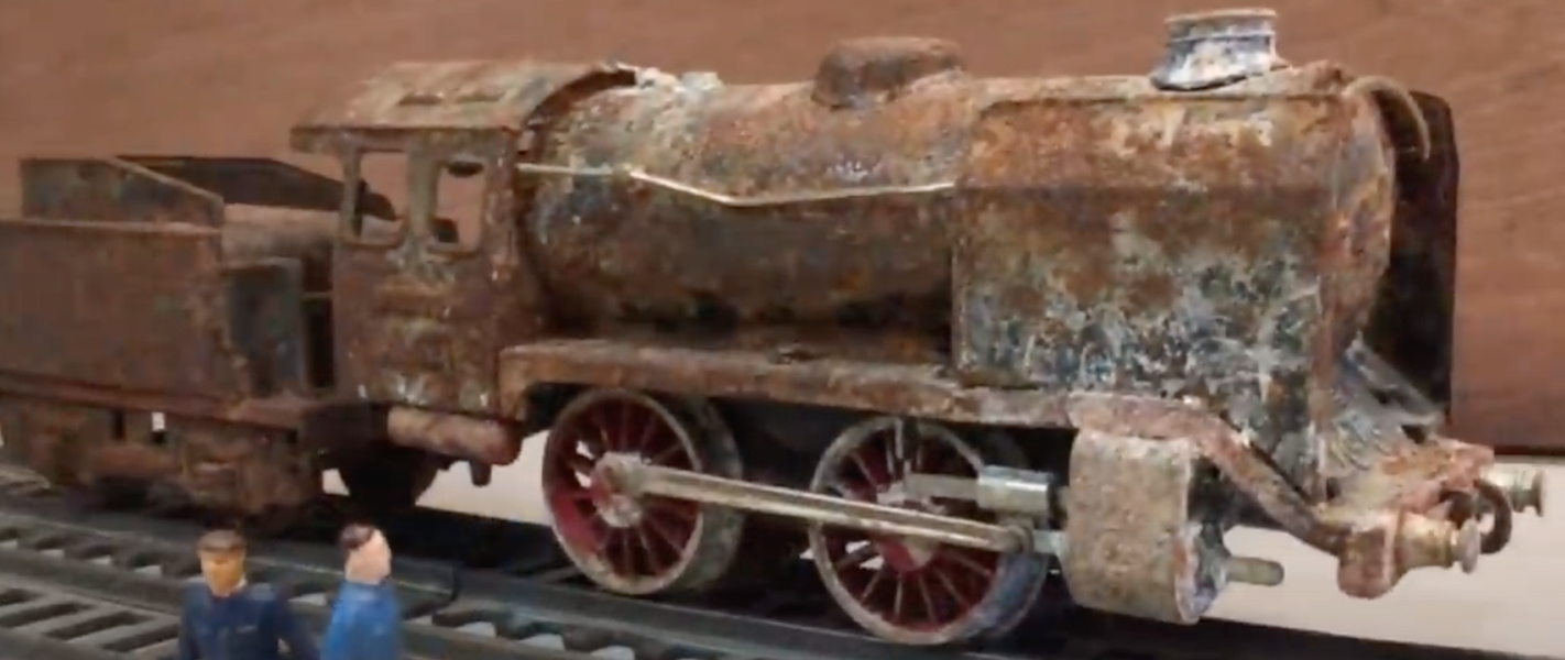

Pre WWII Marklin clockwork train restoration - from total junk to like new.
This train looks like it was found in a WWII bombing rubble pile - totally gone.
This is one of the best resto videos I have seen, using all the techniques necessary to restore lost cause phonographs, etc.
Disassembly, reverse electrolysis, nickel plating, sandblasting and detail painting all in one...
https://www.youtube.com/watch?v=l8PLnh8kmEA

Wow! That was fun to watch! I held my breath each time he bent a tab to disassemble something. I found it interesting that he did not put the same level of care into the restoration of the motor. By not disassembling it, he left a lot of gunk in the bearings and pivots which will only accelerate the wear. I ended up subscribing to the channel!

It's amazing, but he only shows his successes. The bending of old rusted thin tin tabs cannot be so successful!

I refrained from writing at first, but now I have to second these sentiments. The video is interesting and shows a pair of useful tips that I might make use of in the future, but my direct experience in the field tells me that it's just too good to be true, to the point of being suspicious. It's nearly impossible that such a rusted tin car has no perforations or unrecoverable parts anywhere. Also, as said by Inigo, forget to bend back and forth heavily rusted tabs without breaking one.Inigo wrote: Wed Sep 22, 2021 1:14 pm The bending of old rusted thin tin tabs cannot be so successful!
I also find a bit weird the first section, where he tries to crank up a clockwork that is obviously frozen, which is indeed the last thing you might want to do with a clockwork that is obviously frozen and clearly needs to be disassembled.
