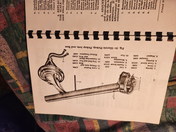

This is they type I am working with.
Update:
I just checked it on an oscilloscope, and touched the needle. No deflection. Checked with ohmmeter, and it went open. Any theory in how to get a new coil? I can't discern where it broke free, even under a magnifying glass. Attached is a photo of the type of pickup.
Chris I.

Possibly the best thing to do with the coil is rewind it with fresh wire.
I'm certainly not claiming to be an expert on this but I have some luck with similar coils, though there are probably easier ways than I did it:
https://youtu.be/1mhp5vIMWWI
