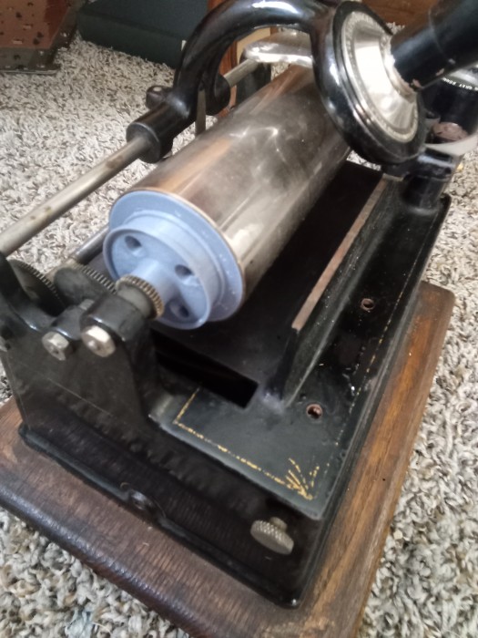

Hey @dzavracky there was 3d printing mentioned in this thread, engineering, and records. Any chance you could work your magic again?
(For everyone else, David was nice enough to print out a new GEM mandrel pulley. My survivor GEM A now just needs the motor rebuilt and a new belt before it is ready to play again-- the print is crisp and clean although I may ream it out and add a brass or bronze bushing in the center. I oil with 20-weight, not LaBelle model railroad lubes, and I don't know if it will eat up the new part over time. Looks pretty good for a 121-year-old record player though, way better than I could design, and now I have an actual chance to hear it in my lifetime so thanks again David it's great.)
