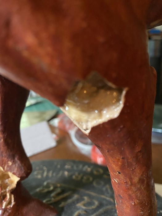

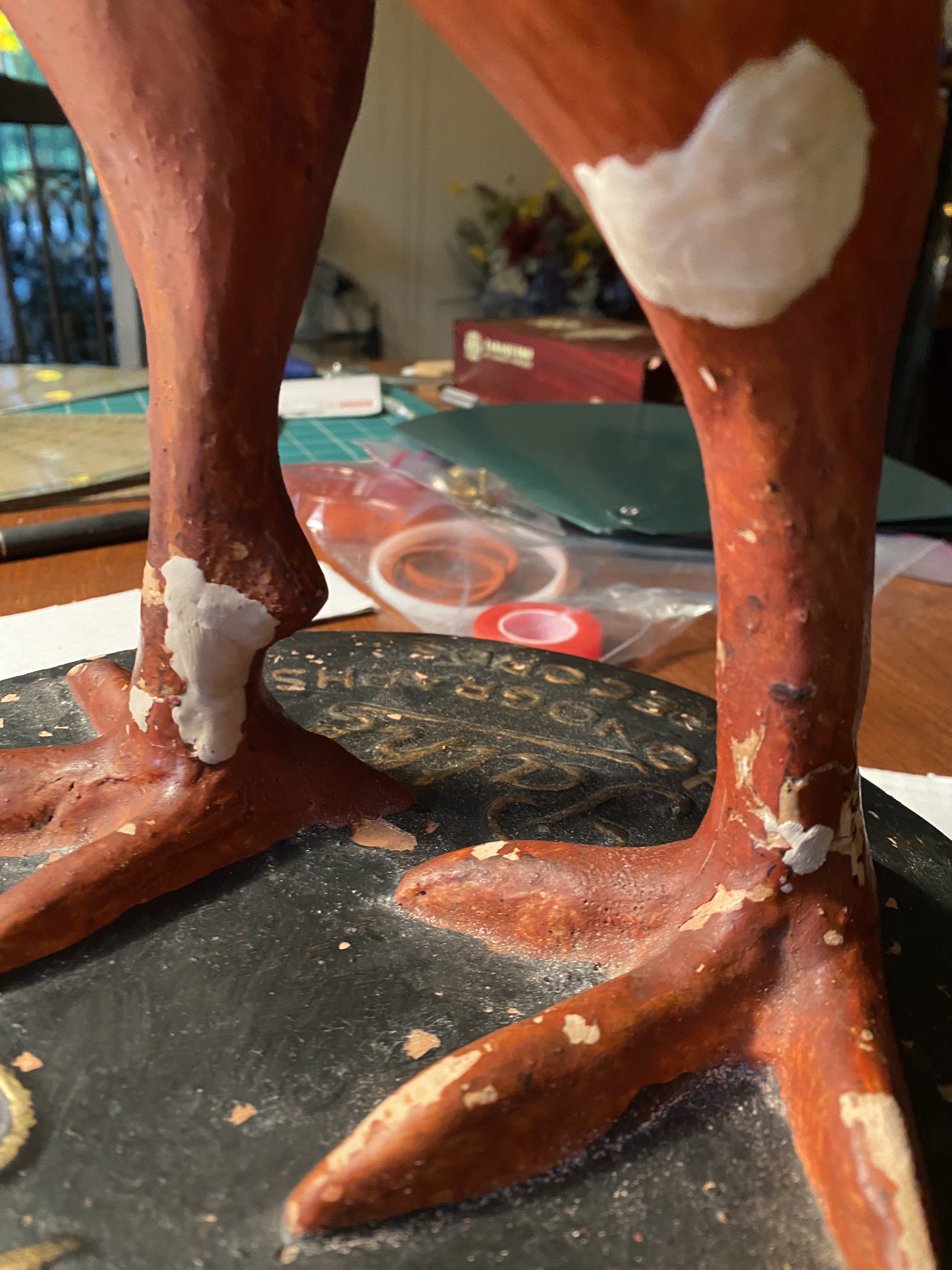

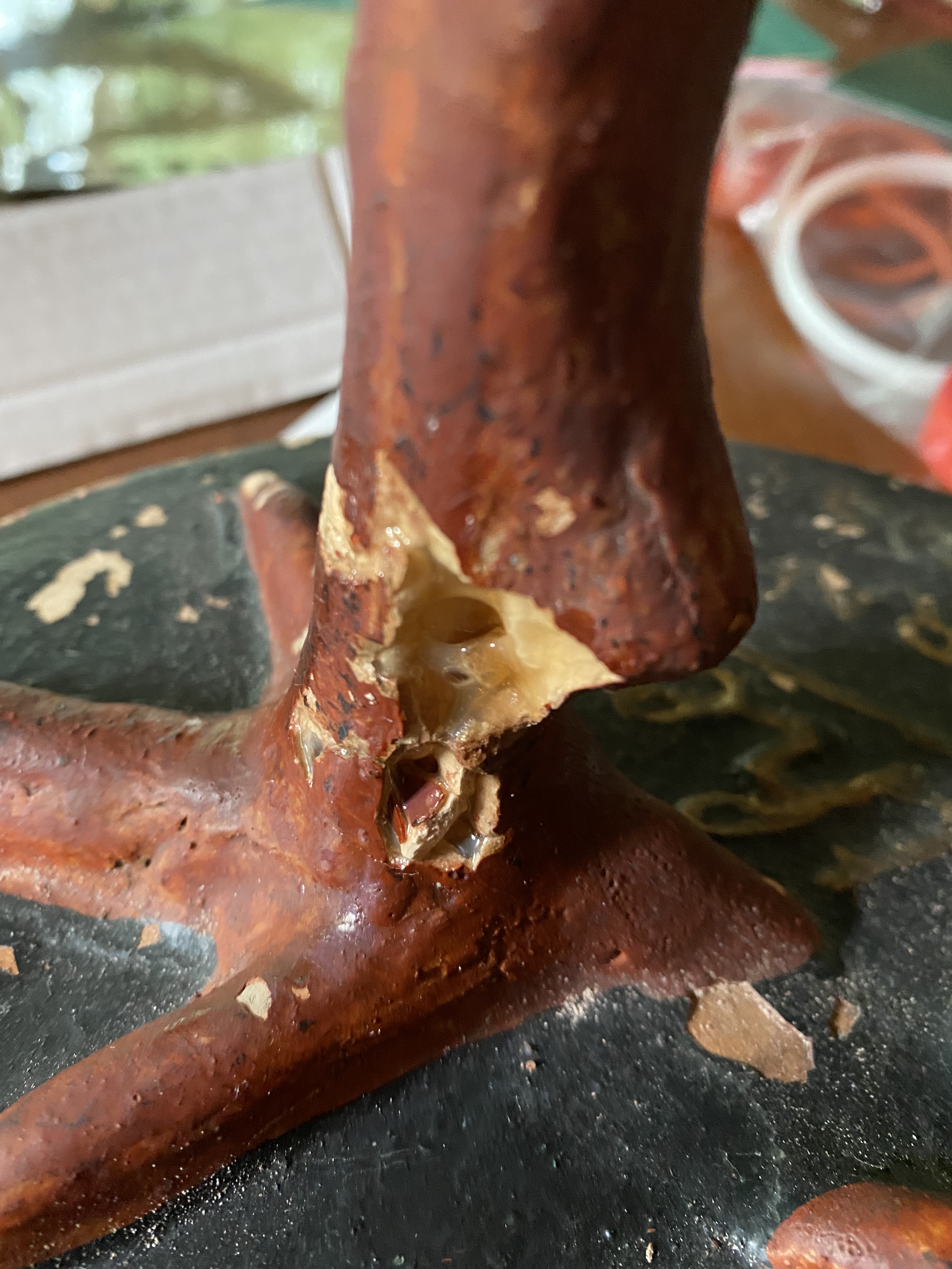

The rooster is physically in good condition, with the exception of a chipped beak, some small chips in the paint, several small holes and two larger holes, one in each leg. Since I have no idea what caused the damage on the legs, I didn't want raw or broken plaster in the holes, so I decided to stabilize the insides with a coating of wood glue to make sure the filler would have a good surface to adhere to. This proved to be successful and allowed me to fill the cavities with epoxy putty.

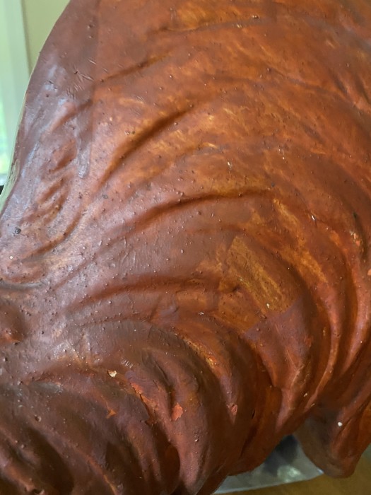

Regarding the paint, the original appeared to be a burnt orange base with brick red over the top, although I think the original paint just appears that way due to its translucent nature. I'm posting a close up of the original paint showing the effect I am referring to.

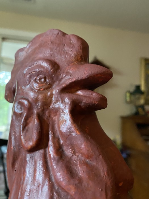

I decided the best way to match the paint was to apply a burnt orange undercoat with a sponge, then sponge brick red paint over the top. I started by fixing the beak and touching up the chips on the comb...
The following pics are the legs stabilized and then filled with epoxy...

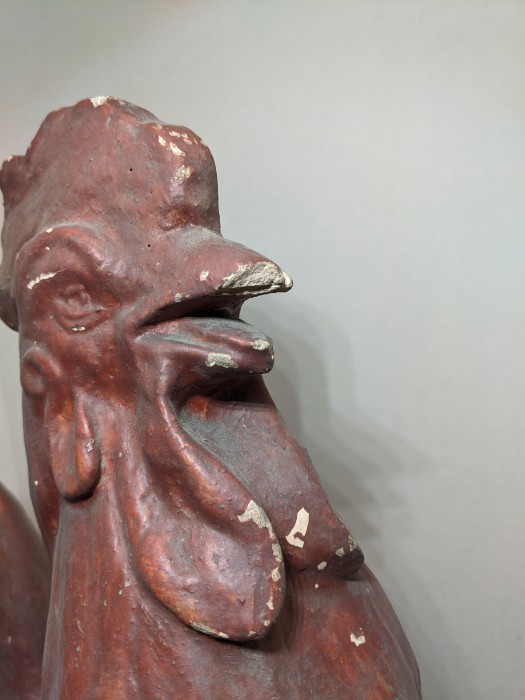

Here is what the beak and comb looked like - before touch up.

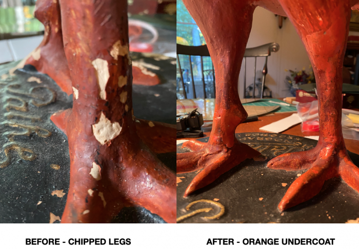

More pictures of restoration progress:
First pic, orange undercoat to cover the chipped paint and epoxy filler repairs.

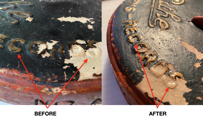

Second pic: restoring raised lettering on the base that was worn down or not molded with enough detail.
I traced over them with glue to give them more raised definition before painting...
