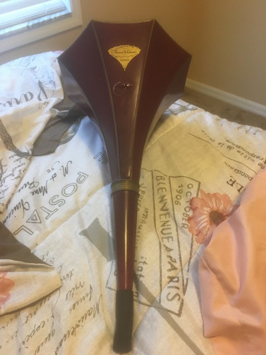

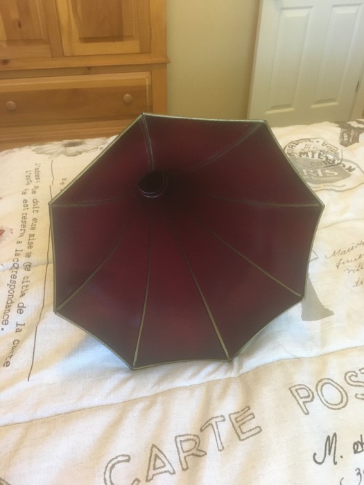

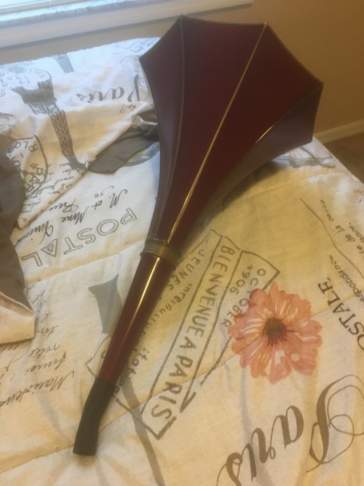

I’ve used this seller on eBay that custom makes any color you want if you supply the information. I’ve used him before on other projects.. I supplied him with this code and asked for single stage, “satin” 1 large spray can, with sipping is $35.Jerry B. wrote: Sun Nov 07, 2021 10:04 am How about having a paint shop tint some lacquer an appropriate color and put that in a rattle can?
1984 vw rabbit LS ,Mahogany Red, code, LE3K .
Here is the final result.
Would I rather have a horn with original paint? Yes! Absolutely!! But as we all know, there are horns that are so bad
a repaint is the only way.

Re: Red Fireside Horn Paint
I too share your feelings about original vs repainting. A couple of questions though, did you use a primer or undercoat? If so, was it black, silver or some other color?
I really like your results.
Mike
With some patience and google! you can learn a lot. I did a light primer, then painted it silver, then the top coat.cosmo666 wrote: Sun Nov 07, 2021 11:54 am I too share your feelings about original vs repainting. A couple of questions though, did you use a primer or undercoat? If so, was it black, silver or some other color?
Mike
Very, very simple. It came out so nice, in my opinion, that I sent out the Gem to have it gone through and the
“K” rebuilt. From what I found on the internet, silver is the best under red
That looks great! I would love to see it next to an original horn as a comparison. It looks to be an exact match to me.

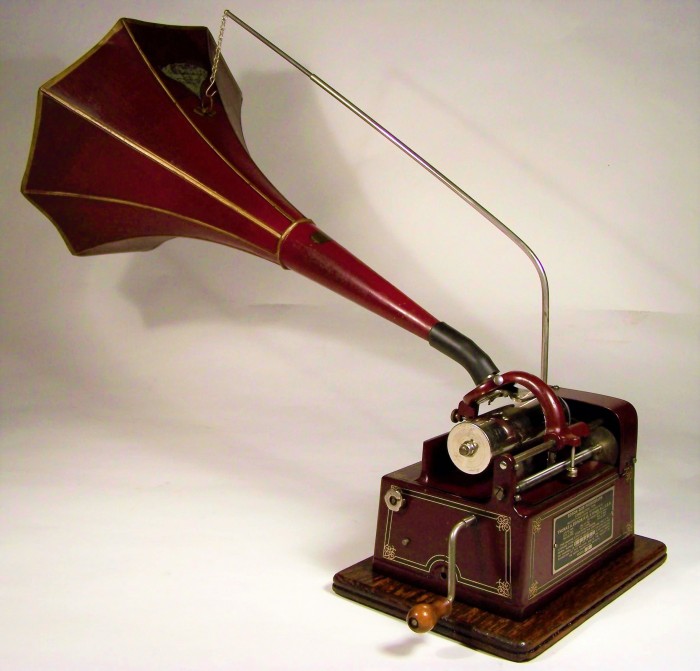

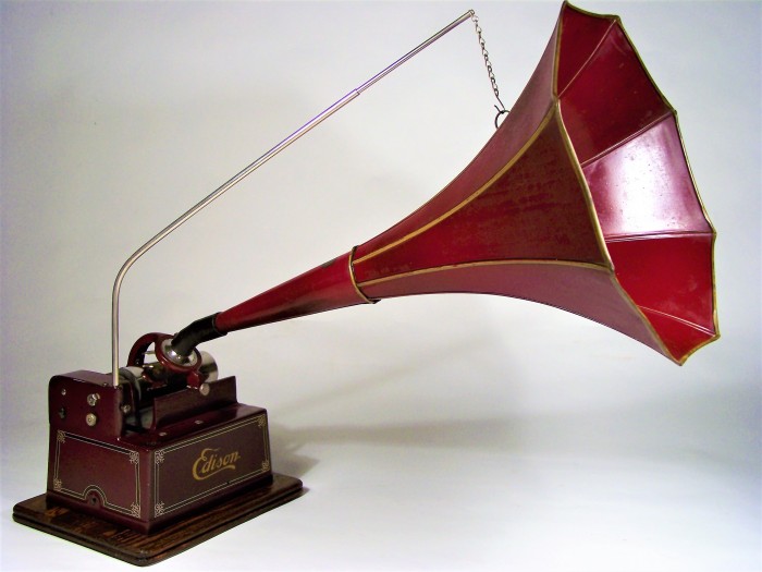

These Gem horns can be found with two original paint colors. The 2-piece horns are typically painted in a translucent red which is very attractive, but notoriously fragile. The 1-piece horns typically have an opaque maroon that tends to survive much better than the translucent red. Unfortunately, the 1-piece horns seem to be harder to find. These are found with a black undercoat, suggesting that black Gem horns already in inventory were repainted for use on the Model D/E Gems.
The 2-piece horn posted by Columbia1spring looks like a beautiful match for the opaque maroon usually found on the 1-piece horns. (That wouldn't bother me for an instant, as the color looks spot on.) For this opaque maroon, you don't need a silver base coat. In fact, the original base coat is black. The original color on the 2-piece horns is typically (I avoid the use of "always") the translucent red. When replicating that color, the silver base coat is what you want.
Below are pictures of a 1-piece horn with original maroon paint over a base coat of black (click twice on any image to zoom in):
The first step in painting a Gem D/E horn is deciding which color you want to replicate.
AZ,
I'm glad you finally found a good one. I was doing the same thing for years - - trying to find a maroon Gem with decent horn paint. One year at Union (probably around 2010) I found one, but it was $1300. The 2-piece horn was REALLY nice (as was the machine), but I balked at the price. The dealer wouldn't budge. By the next day I had decided to bite the bullet and pay the price before I looked at anything else. (Hadn't I learned that lesson decades ago?) But you know what happened - - someone else had already decided the same thing. It wasn't until 2016 that the Gem I posted above popped up in the Wayne NJ parking lot. This time I didn't hesitate (it helped that it was significantly cheaper than the one I missed out on!).
I still sometimes pine for that beautiful 2-piece horn on that Union Gem. When that translucent red is in nice shape, it's really stunning.
