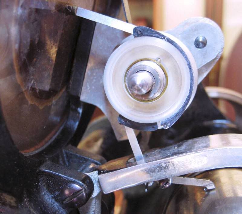

An impromptu, unplanned demo of two days ago.
It was made for non-collectors, and contains unintentional errors in my little speech.
Will do something better some other time when I get a better camera....
[youtubehq]http://www.youtube.com/watch?v=bPUoI32SGDM[/youtubehq]
Any questions? Such as how did I make the new shoe to fit the new friction wheel?

Please study the shape and mass of the articulated Higham shoes?
Notice, please, how carefully I made the shoes, as thin and low in mass as practical?
Note the duplication of the original shoes? Thinned down where in simple tension;
with bulbous ends to reinforce the link pin area against breakage. Just like original, for a reason.
Thinning and shaping of the shoe assembly was done to minimize the mass of the vibrating (reciprocating) friction shoe,
and the "Bondo" material is low in density, being a compound of polyester resin and talc, primarily.
The lower the mass of that friction shoe, the more closely it can "track", follow, the undulations of the recording groove,
less audio distortion. Obviously, the more mass in that assembly, the poorer the potential playback fidelity.

WOW, very clever work. Thanks for sharing it.

That's completely awesome, Mr. Welch! I have a question about the friction wheel: was it actually amber or was it more like the rosin that one would use on a violin's bow? In any case, your tenacity seems to have really paid off in this restoration. Thanks for sharing!
