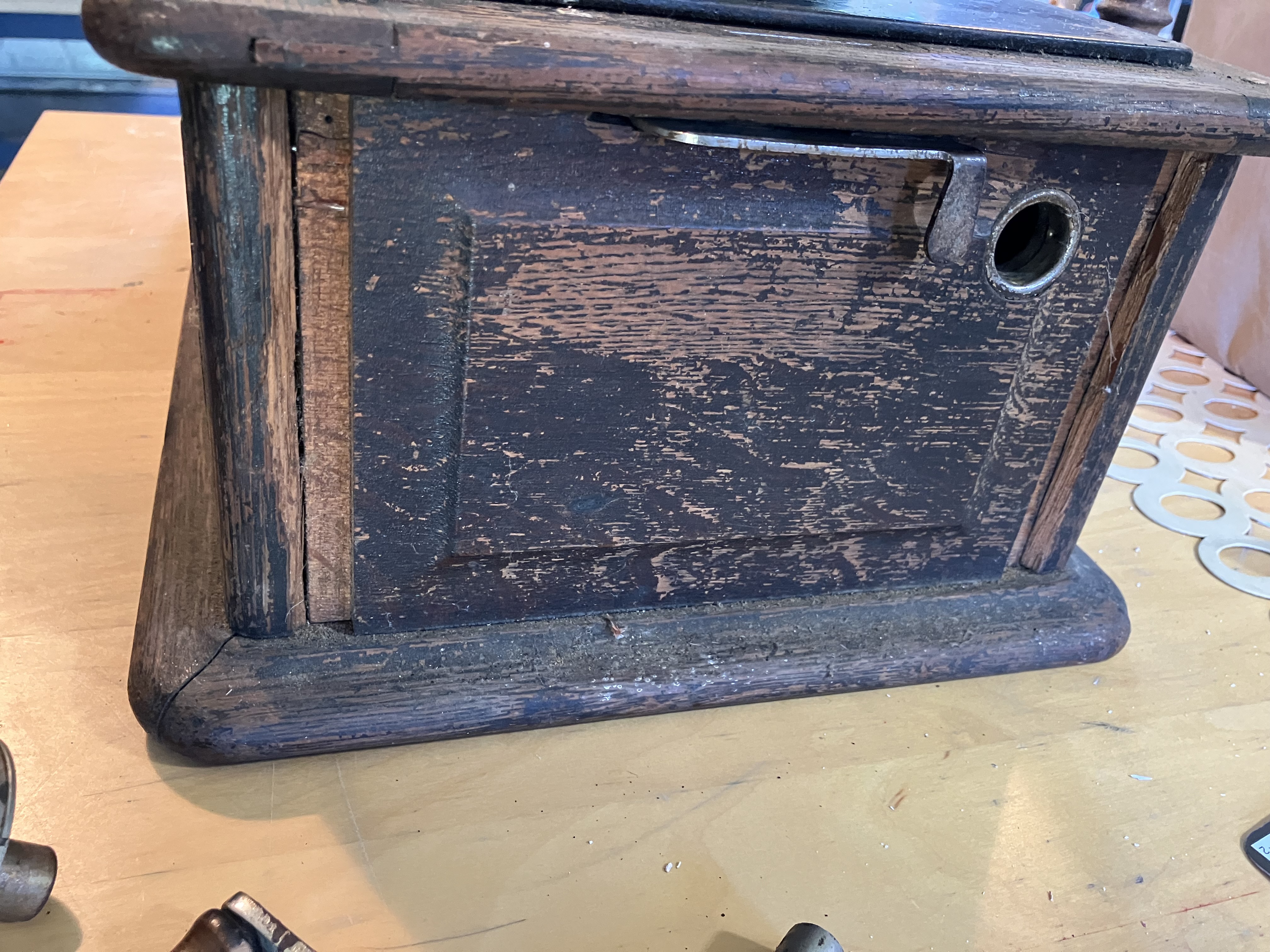

I don't know how part of a case could get torn away like this. Maybe it was yanked, and split, and missing bits discarded. Anyway, I don't have the bits. What do people suggest? Do I need a replacement base? In that case I am looking for a Triumph D2 base. Thanks for your suggestions.

To my thinking, you do not need a new base/cabinet. The problem is that the 2 corner pieces have sections missing. Those corners need to be neatly removed. At that point, you have 2 options. 1.) make replacement corners. 2.) repair the existing corners.
Number 2 option:
(Why go to the trouble? Because I like to save as much original material as possible.)
Number 2 option:

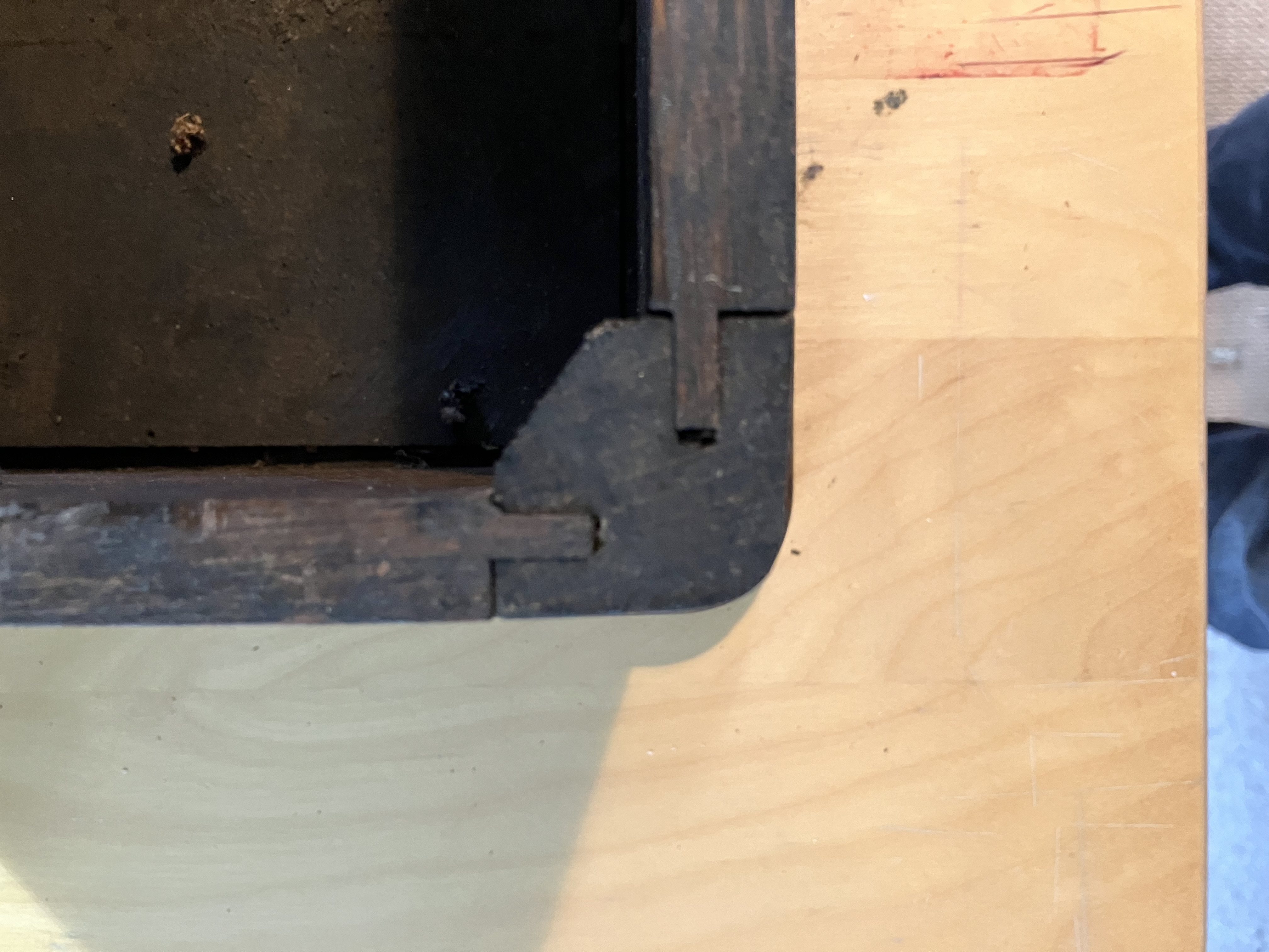

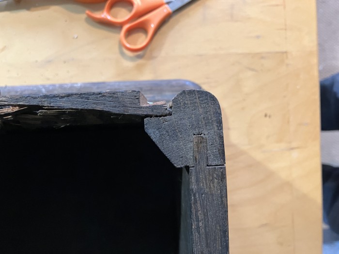

On the other hand, if someone just happened to have the remains of an old Triumph case, and it had three corners.... I think all corners are identical, some just turned upside down. One on the left has been screwed into, so that makes three damaged or with wood missing.
I may still go for the repair but am scouting options.
Pic attached here of what those corner pieces look like.

Agreed. Finding a donor case with good corners would the best option.

Anyone with a table saw and some dado blades can make that.
The dado grooves are cut first from a piece of square stock, and then shaped to fit the cabinet with a hand plane and "blocked" sand paper.
