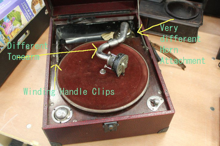

I saw your photographs and mine looks the same as yours except it is black and the winding handle clips are in a different position. The one major obvious difference is that mine has a very different tone arm which is very differently attached to the horn.
Therefore, I was thinking that mine might be a later and different model. This might have been confirmed if yours had an earlier motor and serial number. The motor is clearly the same. My serial number is 03190 so it is some-what later. How much later though, of course I don't know.
So, although my tone arm looks (to me) original maybe it was added later by an owner. It seems very well done though. Very solid. But maybe the original one was replaced for some reason or another.
Thank you so very much again.

Aha ! I revise entirely my previous opinion. I have just found a red portable with exactly the same tone arm and horn fitting as I have, which confirms that this was indeed an original fitting and design.
So Orchorsol did either 'up-grade' the tone-arm + fitting or maybe it was simply a different model.
Also, the winding handle retaining clips are in the same place as mine !
Thanks for your help and I am so very pleased to have reached this conclusion !

This last tonearm seems thicker... Is there a story behind, same as hmv 101 versus 102?

Inigo wrote: Fri Jun 04, 2021 12:10 pm This last tonearm seems thicker... Is there a story behind, same as hmv 101 versus 102?
That is a very interesting observation and question.
The 'new' tone arm is certainly very 'solid' and thick.
Interestingly, the first long segment of the tonearm (connecting to the horn) is heavily magnetic, so must be made of good quality iron. The second segment however, which connect the Orchorsol sound box is not magnetic, so must be 'pot metal'.
The 'new, horn / tone arm connection is far more 'solid' and robust than the usual one.
