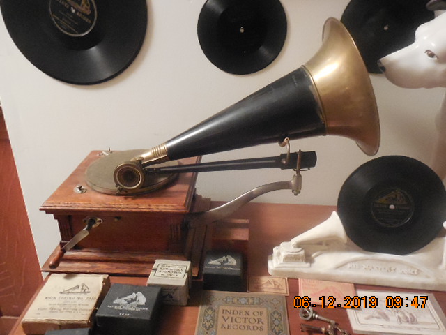

My Victor E (aka Monarch Jr.) has a metal traveling arm. I vaguely recall seeing a name for such an arm, but for the life of me I can't remember what that name was. Anybody here know? While I'm about it, would that type have been original equipment for this machine? The E machines I've seen in pictures, e.g. in Look for the Dog and the Victor Victrola Page site, have been equipped with wooden traveling arms, although the former shows a Monarch Special and a Royal with the metal arm--two ends of the price spectrum, so no help there. Thanks for any insights!
Victor Monarch Junior.JPG (75.75 KiB) Viewed 1044 times

Is the metal traveling arm known as a Gibson Arm? I believe these come after the oak arms.

Yes! Thank you! With the Gibson name, I did a Google search and quickly came up with an old Yankee Trader entry from this very forum that elucidated:
Lucius1958 wrote: Fri Oct 30, 2020 11:05 pm
Canuk Phonographs wrote:Nice machine Brad. Can someone please explain what the "Gibson Arm" refers to. I have the same arm on my Victor R and Victor P
Thanks
Blain
The "Gibson Arm" refers to the stamped metal traveling arm, which was supposedly lighter and less bulky than the earlier wooden arms.
On the Victors R and P, the Gibson Arm is apparently rather rare, compared to the E.
- Bill
Unfortunately, the photos from that old listing are long gone, but that quite readily settles the question of originality, too. Many thanks! :D
