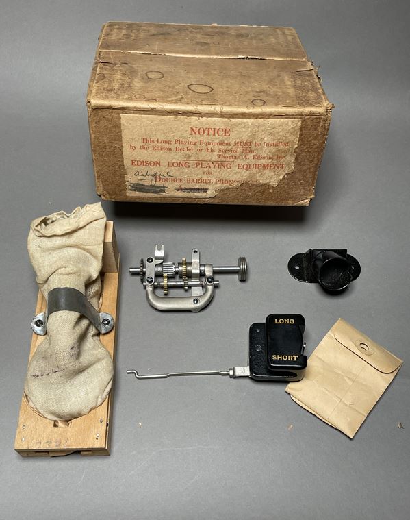

This photo shows what was included in the Kit, which included the LP reproducer fitted with a microscopic diamond tip -- FROM -- https://forum.antiquephono.org/uploads/ ... 601e13.JPG
(Original Source -- https://forum.antiquephono.org/classifi ... ew-in-box/ )

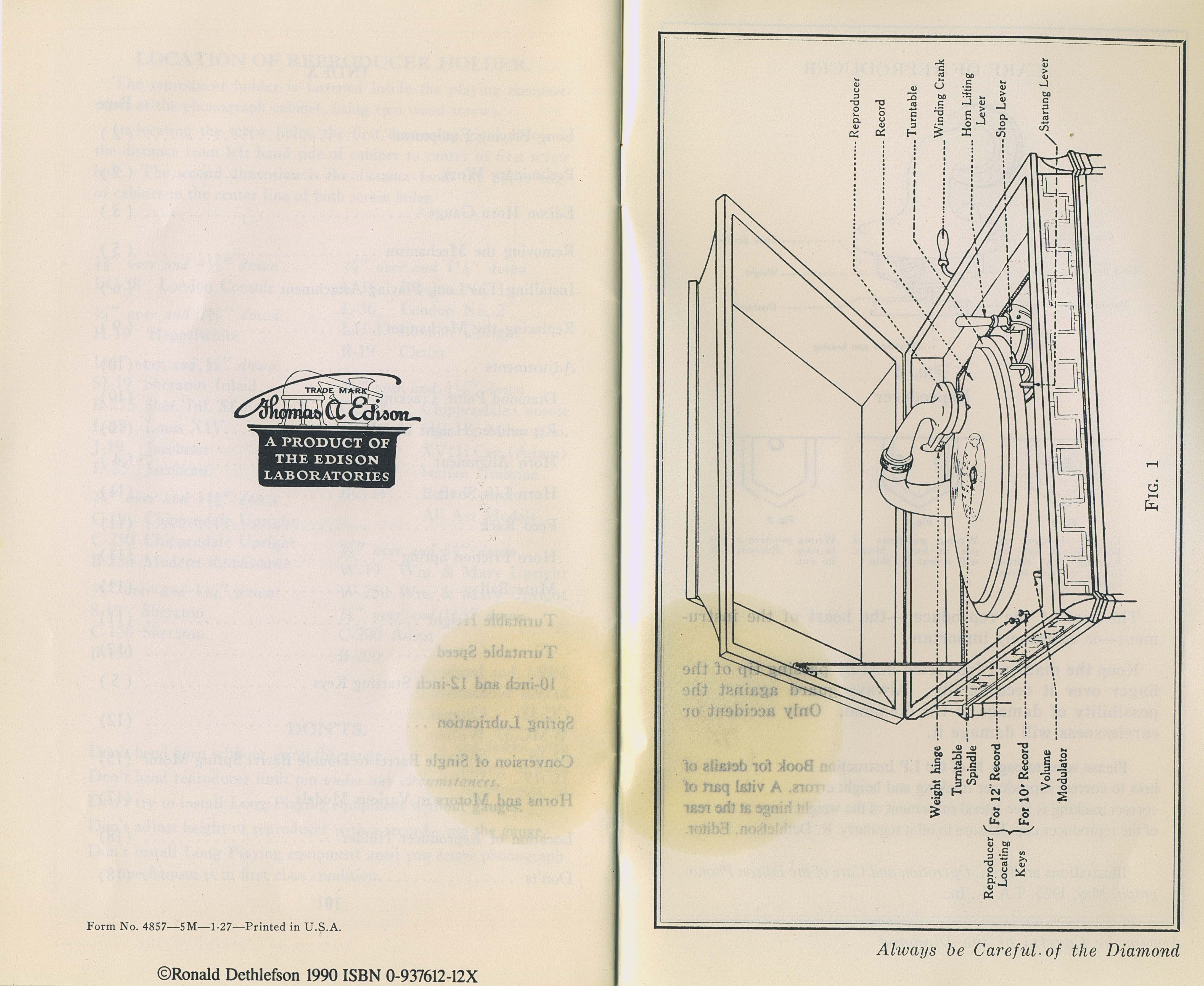

Here is a scan of the Dethlefson reprint. If there is an issue with not having permission to post it, please advise and I'll remove it. Converting the Schubert to 2-spring LP has been a project that hasn't yet made it to the top of my to-do list.
52089
- Posts: 3838
Re: Edison Long Play conversion instructions
Thanks for posting this. I will review my own installation to see that it matches everything shown here.
I will note as an addition to my comments above, that these instructions apply primarily when installing from a new LP kit. If you are re-installing a kit that had already been used on another machine, you may find that the adjustments to the rod mechanism have already been made and do not need to be reset.
As for copyright, this was published in 1927 without a copyright notice and therefore should be in the public domain. The only part of this that would be subject to copyright is Ron's text on the left page of the second image. (Usual disclaimer applies.)
