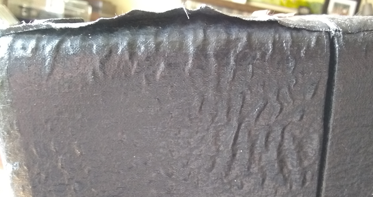

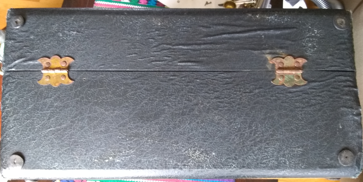

Conservation Question 2: Humidity Damage to Case Fabric
The machine has no water damage, but I suspect that it was once stored on a basement or garage concrete floor where the damp-wicking of the concrete greatly increased the humidity next to the floor. The bottom of the case (with the case closed and the handle and latches top side and the back and hinges down) has its fabric blistering. The fabric on one side has come loose.
The hinges, as noted above are rusty. This storage is probably why the horn flange is rusty - it is very close to the back/bottom of the case. So too with the retainer strip for the horn.
If this were a guitar or amp case, I would carefully make a small slit in the blisters with a razor knife, inject a small amount of a good quality white glue, work it around, squeeze out any surplus, clean it up with damp rags and cotton swabs, and then press and hold it until an initial bond is set (if it can't be clamped). The blistering could also just be left (stewed in its own juices rather than restored). However, the fabric which has come loose needs to be addressed. It could easily catch and tear. I would probably use a good white glue spread with flat toothpicks, work the glue around, clean up excess, tape the fabric down with painters tape, and then apply gentle pressure with a bar clamp.
Any thoughts here?

Re: My New RCA Victor Portable
Post by HMVDevotee »
I had a similar problem, though not as severe, on an HMV 102 portable. I found that "white glues" that are water-based, dried very hard and were not compliant with the wood case as it expanded and contracted with humidity. That bond worked loose over time. I then turned to an old fashioned rubber cement (contact glue) applied with a syringe and worked under each "bubble." I finally put a compliant layer of cotton terrycloth material over the surface, followed by a board that was then clamped in place. The results held well with no areas coming loose. Contact cements typically set best when applied to both surfaces and let to partially air-dry before making "contact" between the two surfaces. My use made that impossible, and the drying time was much longer. I used a natural fiber pad (the terrycloth) over the rexine in order to allow some evaporation of the solvent of the glue assuming the rexine was even the slightest bit permeable.
There may be many products similar to "rubber cement" that you might try. Hope this helps.

HMVDevotee wrote: Thu Apr 07, 2022 6:05 pm I had a similar problem, though not as severe, on an HMV 102 portable. I found that "white glues" that are water-based, dried very hard and were not compliant with the wood case as it expanded and contracted with humidity. That bond worked loose over time. I then turned to an old fashioned rubber cement (contact glue) applied with a syringe and worked under each "bubble." I finally put a compliant layer of cotton terrycloth material over the surface, followed by a board that was then clamped in place. The results held well with no areas coming loose. Contact cements typically set best when applied to both surfaces and let to partially air-dry before making "contact" between the two surfaces. My use made that impossible, and the drying time was much longer. I used a natural fiber pad (the terrycloth) over the rexine in order to allow some evaporation of the solvent of the glue assuming the rexine was even the slightest bit permeable.
Gavelcrack
Thanks for the suggestion.
Doing a bit of research, I found another suggestion that I might try. Someone suggested that if hide glue was initially used, gently ironing it with a piece of cloth between it and the iron might reset the hide glue and reattach the fabric.

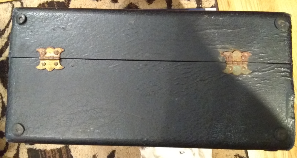

For bettor or worse, I tried the ironing method.
I laid a rag over the area I wanted to work on and then ironed heavily with a dry iron setting for cotton, fairly high.
The smell of the old glue was gross, but I was able to get the blisters out of the fabric and get it reattached to the case. I am left with a few wrinkles, though.
I am going to have to use glue for some of the edges.
I am also going to have buy my wife a new iron. ;) Good thing she loves me.
Before and after pics. Not perfect but better.

Lah Ca wrote: Sat Apr 09, 2022 8:31 pm For bettor or worse, I tried the ironing method.
Looks fairly decent, after the ironing. Not perfect, as you say, but pretty presentable. A new iron is a small price for domestic tranquility. ;)
