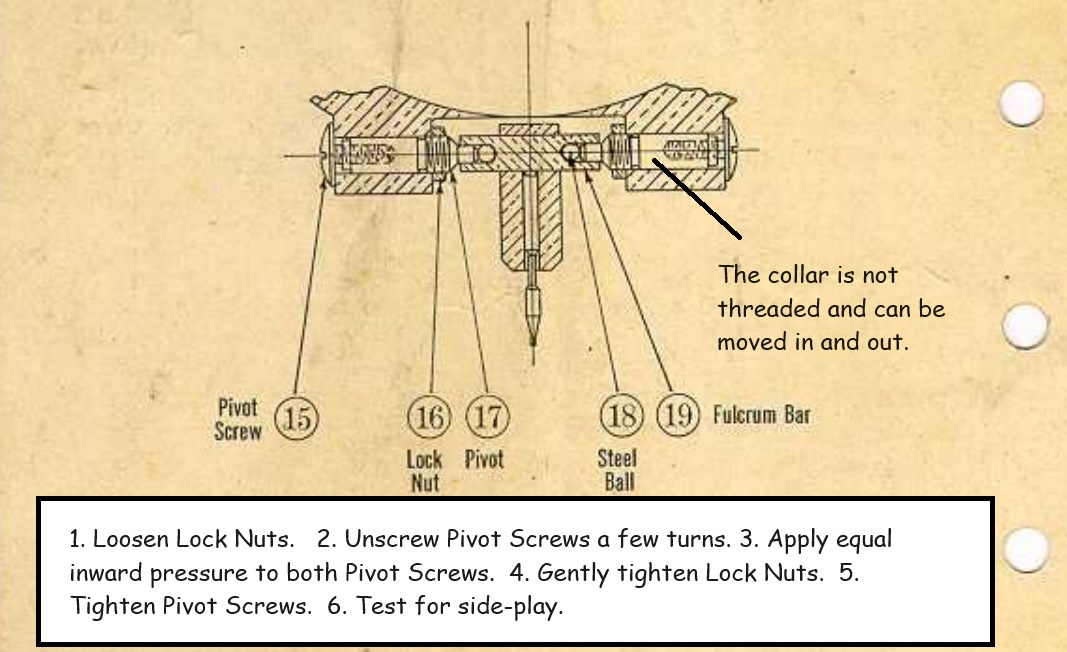

When making the adjustments to the needle bar pivot, this is a good guide: https://www.nipperhead.com/old/vic4sb.htm It's identical to the HMV #4 sound box.
Here are the basic/easy steps explained to me several years ago.
Keep in mind the collar is not threaded and moves in and out. If it seems frozen, apply some penetrating oil to the area. To test for side play, try moving the needle bar in the direction of the pivot screws. If you feel a sideways movement, repeat the above steps, since side play can cause buzzing or blasting. The needle bar should only move in the direction required to track the record's groove.

OrthoFan wrote: Sat Oct 28, 2023 12:36 pm When making the adjustments to the needle bar pivot, this is a good guide: https://www.nipperhead.com/old/vic4sb.htm It's identical to the HMV #4 sound box.
HTH,
OrthoFan
Very interesting and helpful.
Thank you OrthoFan.
