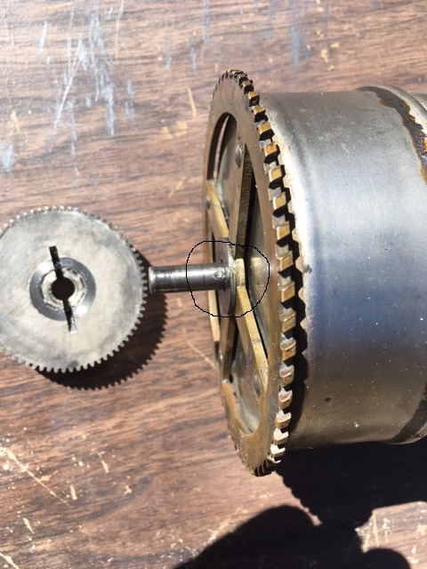

After finally getting into the motor of the Victor X table model, I sadly saw where the encircled pin was sheared off at some point. Would anyone have said pin or even an entire shaft for sale? Please & thank you!

CharliePhono wrote: Fri May 21, 2021 1:16 pm After finally getting into the motor of the Victor X table model, I sadly saw where the encircled pin was sheared off at some point. Would anyone have said pin or even an entire shaft for sale? Please & thank you!
Charlie- BTDT- tap it out with a hammer and small punch and use an appropriate diameter nail trimmed down.
What Greorg said...
Or, take the remaining bit to a hobby shop where they'll have steel rods of various diameters and lengths. Match up the diameter, buy one of those, cut to length, presto!
What Greorg said...
Thank you, George and Jerry!
