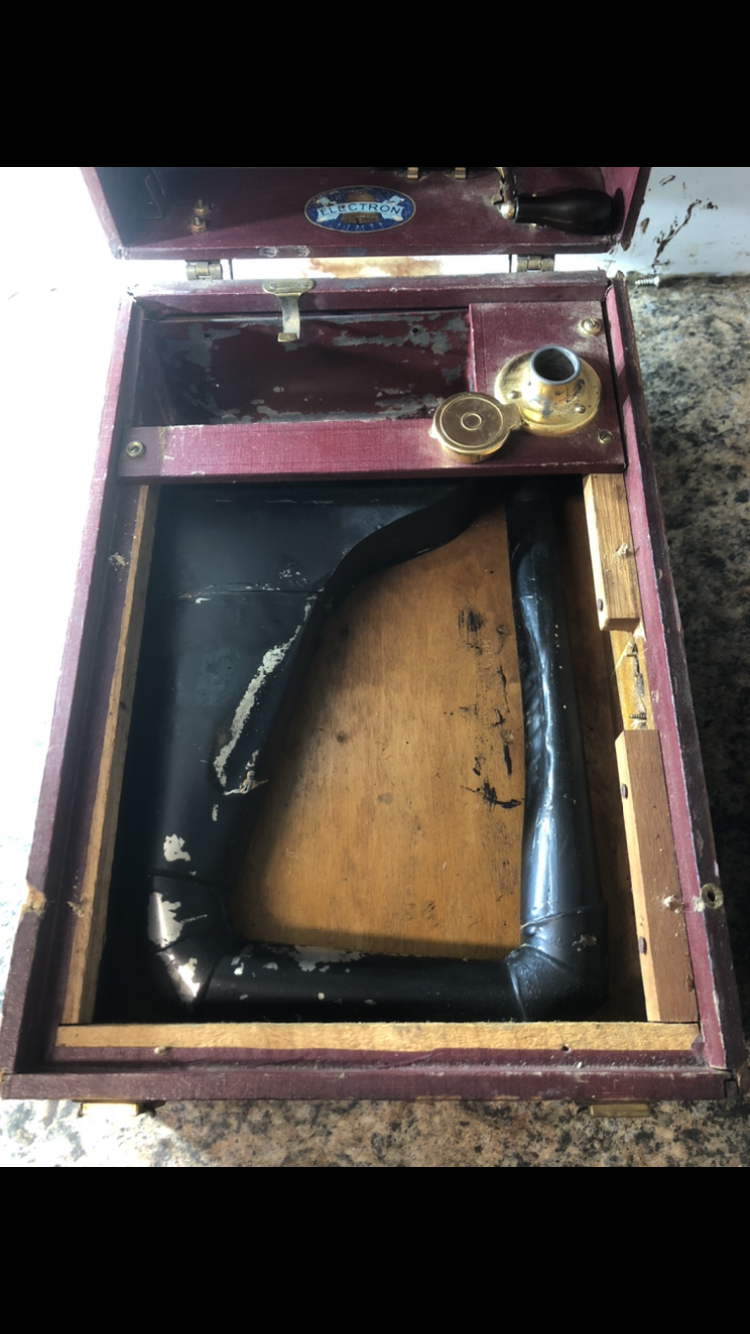

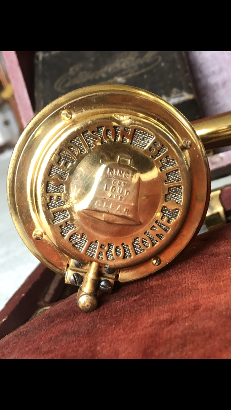

I saw it on Facebook and just really loved the way it looks. Granted the outside of the cabinet is in pretty sad shape.
So my first question is… what can you guys tell me about this portable? Is it an uncommon machine in Europe? I can only assume it’s a pretty hard machine to find in the US (I live in Tennessee).

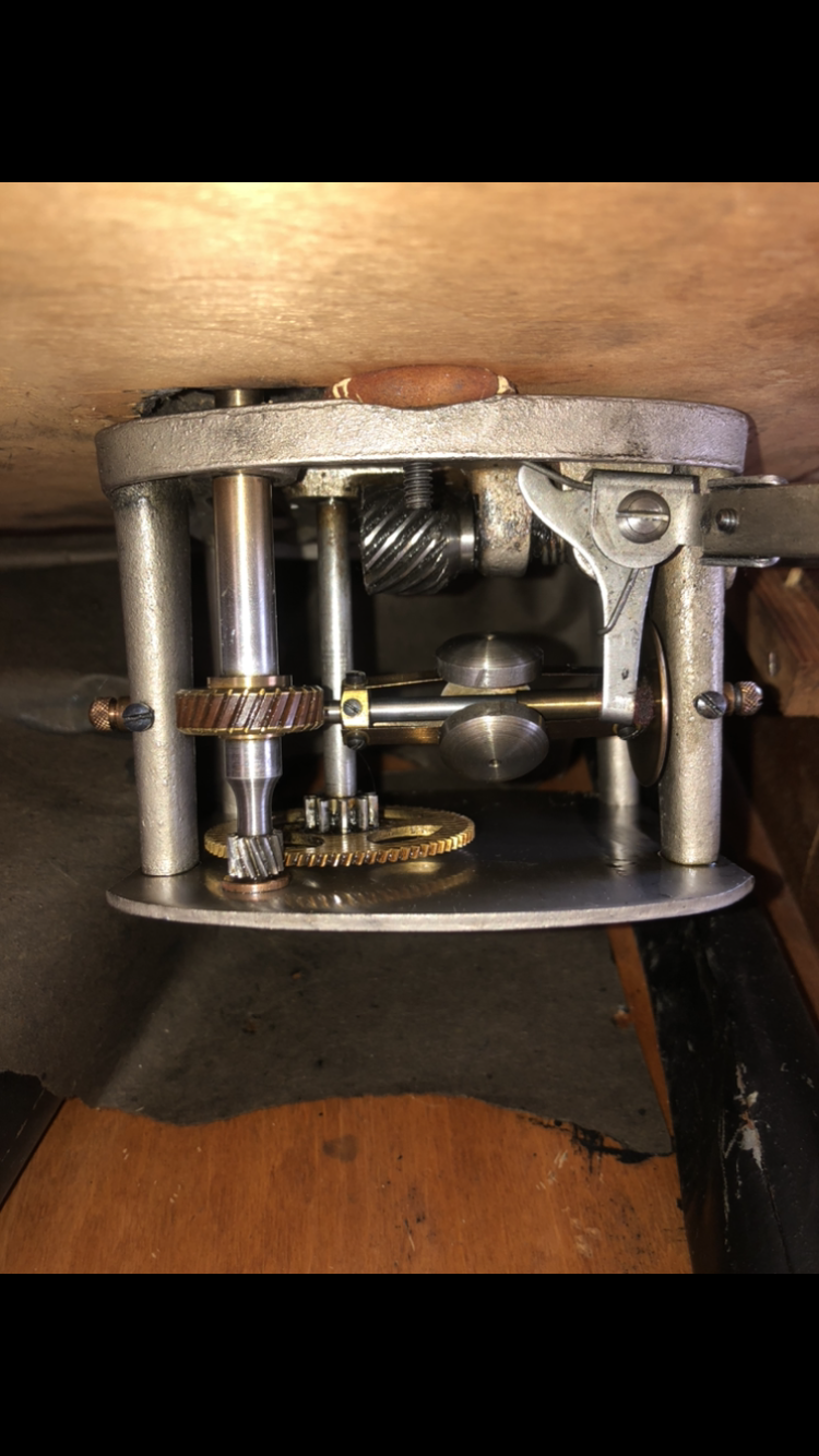

The main reason for this post though, is the bottom spring is broken. I was really hopping the outside of the spring was broken because that’s repairable. But turns out the center of the spring broke. I haven’t ever seen a spring like this before. It has pear holes on both ends… but the inside has a “clip” connected to the pear hole. Is it possible to get a replacement for this spring? The rest of the motor was pretty straight forward.
Would this be a correct material to re-cover the outside with? https://ratchford.co.uk/product/red-41-leathercloth/
If I can find a spring I’ll send the reproducer to Wyatt M for a full rebuild.
Here’s some pictures. The picture of the motor put back together was taken after I cleaned the motor.

Here is a pre digital photo of an Edison Bell 345G which I sold some years ago. This was their top of the range portable costing £7 in 1930. An automatic brake was an optional extra costing 2s.6d.
It had an Edison Bell No.45 double spring motor and, unusually for a portable, a 12 inch turntable. With the 12 inch record album removed it would play with the lid closed, the 3 foot long horn emerging at the front of the case, which measured 9 inches high by 14 inches wide and 16 inches deep. It weighed 20 pounds.
It's weak point was the complex pot metal tonearm, which had broken beneath the motor board where it joined the horn.
I had the motor professionally serviced, and the repairer remarked on the unusually thick and strong springs.

Wow that's a really nice portable! What is the main difference in the 44 and 45 motor? The springs on this machine and pretty small.

I never saw the 45 motor in pieces, but when I collected it from the late great Philip Knighton he said that the springs were as thick as (cylinder) phonograph springs. He had the scars to prove it, and asked me never to bring him another one to fix!
