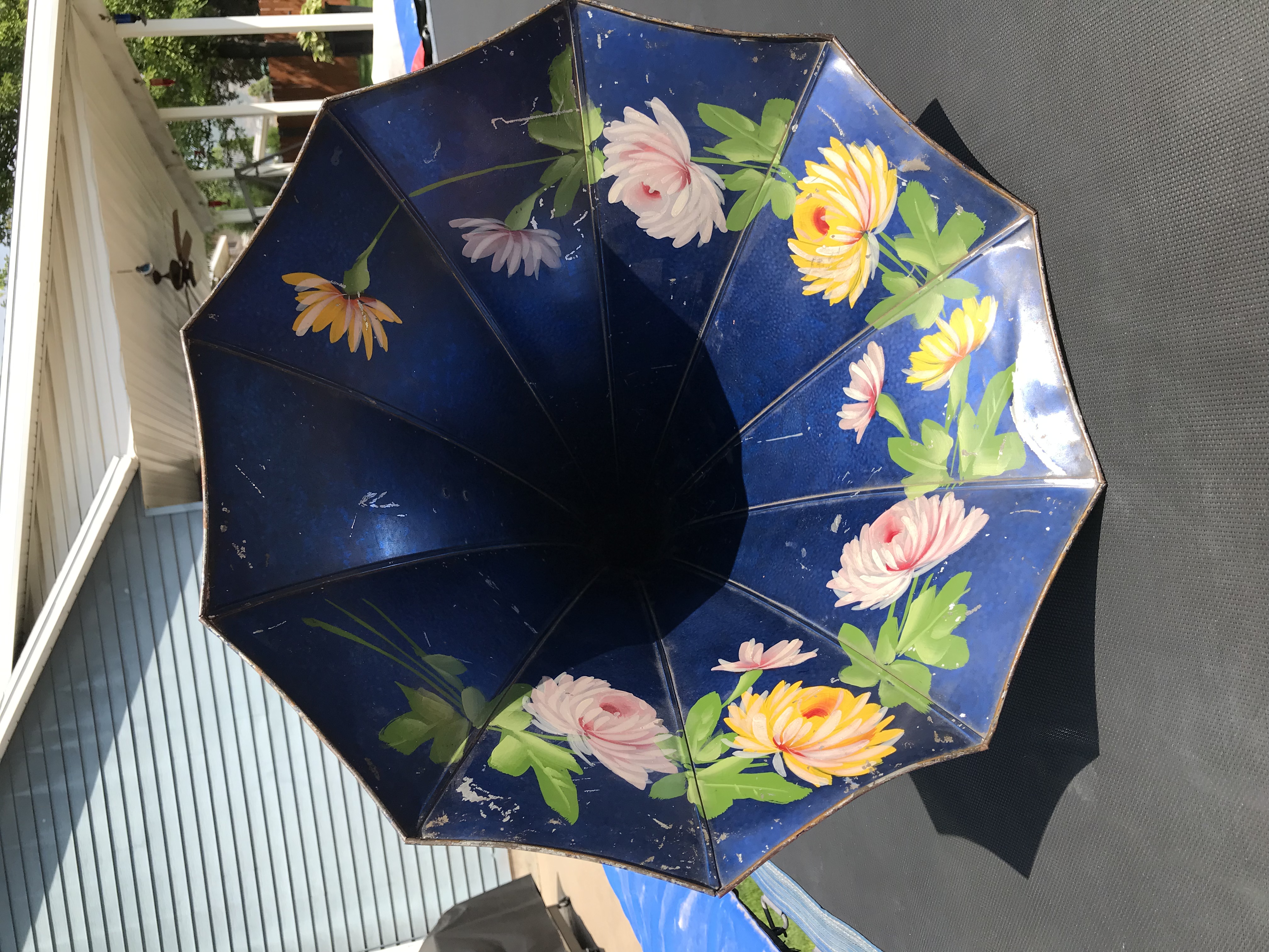

I just bought an Edison Standard model E. It came with a blue Edison morning glory horn with floral design and it’s crane. It also came with a cylinder cabinet. I paid $500, so hopefully that wasn’t bad. Anyway, the odd thing is, is it has a chord and a motor? I’m not super familiar with these and was hoping you guys might could tell me more about it… he said his grandpa was the original owner and that the motor and switch were an upgrade for it? I’ve attached some pictures, let me know what you think. The motor and everything fits so perfectly I wonder if it is legit? I’ve read about the ekonowatt motor but that’s not what this has. So maybe it was just something his grandpa threw together.

His grandpa did an interesting job converting it to electric.
I'd leave it as is if it works.
Looks like an old radio knob was used for the switch.
James.
PS: lets see the cabinet.
James.
