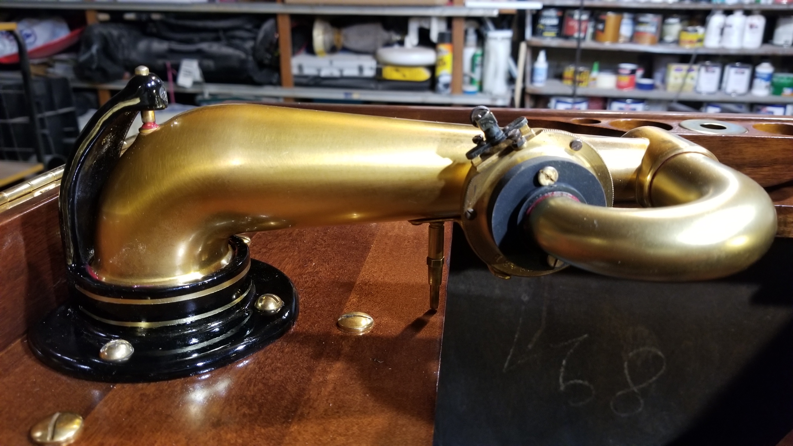

Rebuilt tone arm, mount and exhibition reproducer. Also restored the horn, all ready to install. I use synthetic grease and new bearings on the arm. The horn got disassembled, metal cleaned and painted and wood got cleaned and tinted-sealed to match rest of unit. Assembled both using GE clear silicone sealant glue and the original screws.

I just finished this 1917 walnut Victrola XVI, turned out stunnung. I used Amsoil synthetic heavy duty racing grease for the motor rebuild, it really makes a difference,

Looks great, Jon! :D I'm a Redline guy myself... I mix their synthetic ATF with their synthetic grease until it is a flowable grease, then pour it in the spring barrels and onto the gearing (a bit thicker consistency on the gears, unless they are fibre gears). The grease in the barrels flows all around the springs and really sticks to the gear mating surfaces. These old spring motors really seem to love friction reduction!
