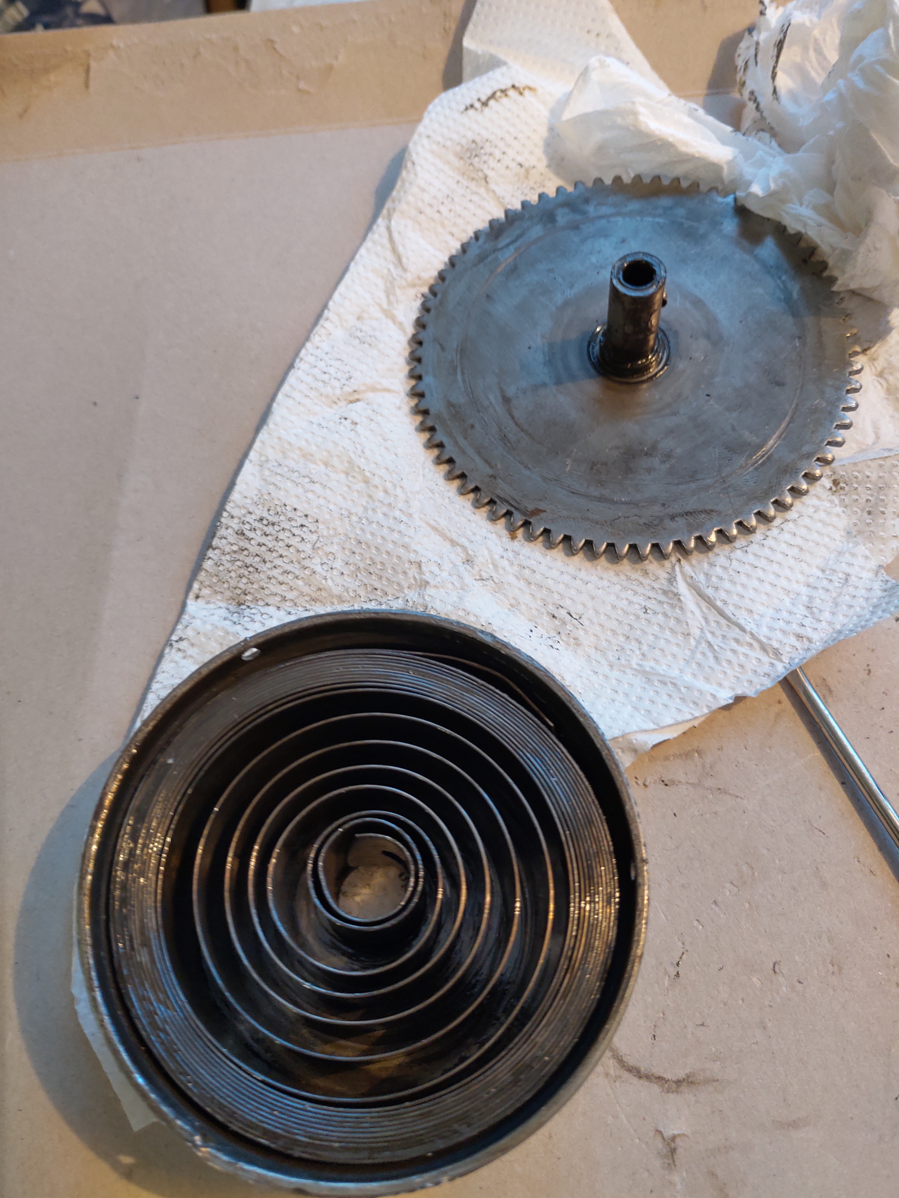

"I have spent 2 hours trying to adust the governor, the main drive spins on top of the governor worm gear, it was like this when I started to service it. Paillard has this special way of adjusting the governor bushing ( if that is what it is called), a pin hole where the governor shaft is fastened, and they can be adjusted at both ends while turning the bushing 24 hour clockwise ( or anti clockwise), that will change the angle of the worm gear. I remember having some small problems with this on my Paillard portable, but nothing like this, so probably the main drive gear are somewhat destroyed.
Right now, there there seems to be only two different results.
1. The main gear spins on the worm gear
2. The governor halts completely."
That may be some critical info I was lacking in working with my little single spring Paillard motor!
I had no idea the governor could be adjusted this way and experienced the 'spinning on worm and halting completely' with my homemade fiber gears ... one or both may actually work with this new info. Thanks for this!
Your fiber gear looks somewhat chewed as well at the top. Mine had some non chewed sections and I tried to 'adjust' where the worm engaged the gear with a washer between the spindle and the plate .. but not enough decent teeth left .. yours however looks to have a good lower section and a washer might raise it up enough to catch the good real estate.

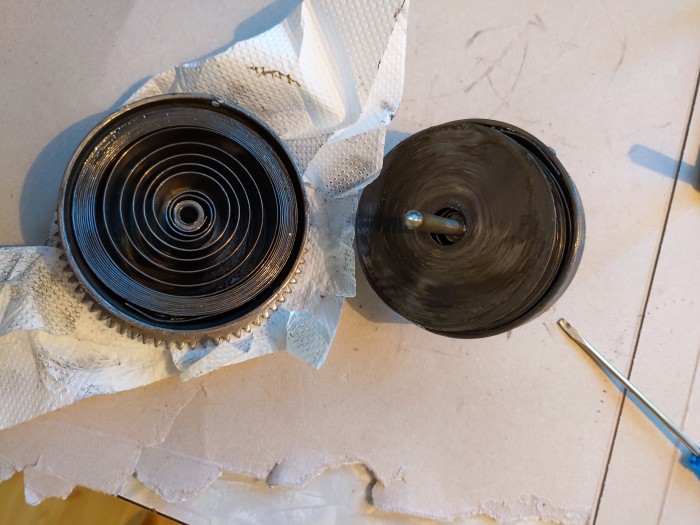

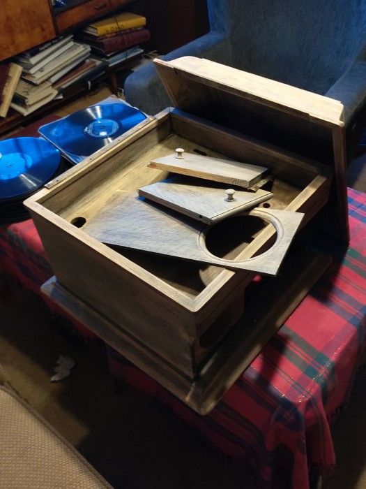

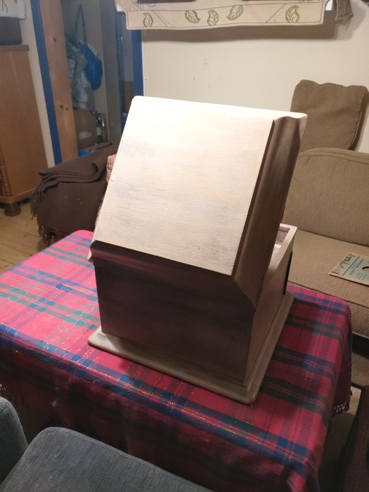

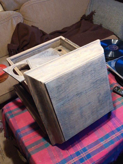

"burke", I will be very happy if you will be able to make your Paillard running from the information given about the governor positioning adjustments.
I was able to make the motor run yesterday evening, after winding it up, but don't know yet if it will keep the correct speed when playing a record.
Adding an optional washer was an excellent idea, I will keep that in mind, if I get problems after re installing the motor in the cabinet.

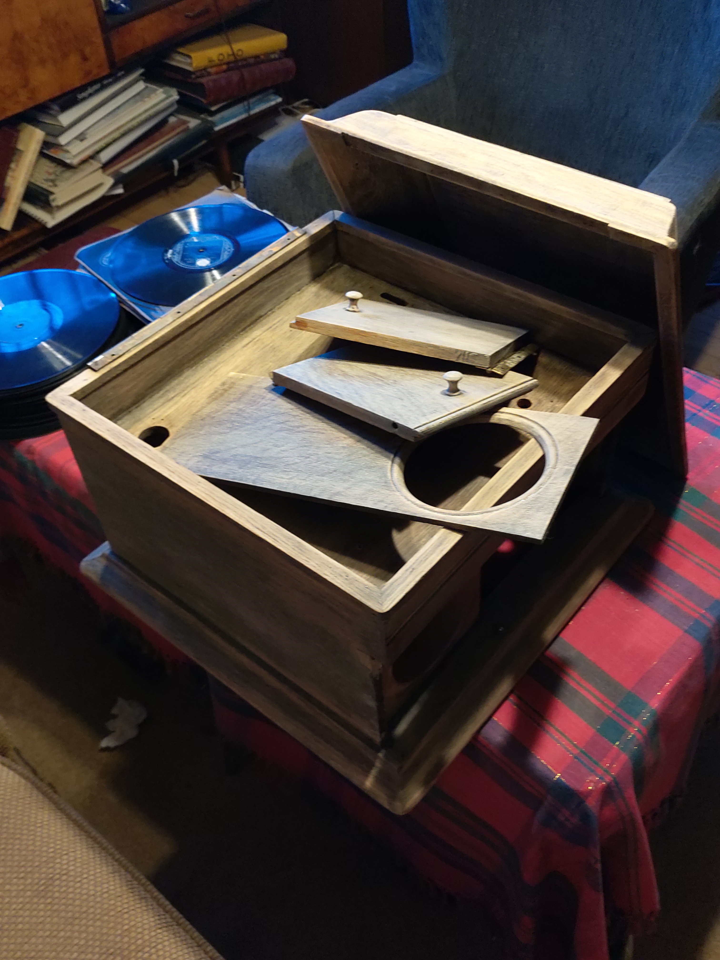

I have worked on the off brand cabinet yesterday, after acknowledging and having confirmed that this was not a Paillard cabinet, the decision was even easier. For sure I did not want this cabinet as it was looking when I received it, as you said Inigo..it looked like one of the hundreds of off brand cabinets found regularly on Ebay etc. It also feels better to know Paillard never made this cabinet, since their other machines are of so high quality. I still have not seen a Paillard table top though...
I just upload some photos of the process of this unimperssive tabletop, with a good ( but right now a bit troublesome) motor. Maybe you will not be so angry after all, when we now know this is an off brand cabinet.
The other option was the fireplace, and well...this solution is hopefully a bit better. As we can see the motor board is not good at all...
I also upload two photos of the spring barrell interior, so we can see how it looks inside. There was no spring issues here, I removed and cleaned one of them, but it was absolutely unneccessary, so I just added grease to the second one. The problem with this machine, were not the springs. This machine is maybe not the most exciting one to show here, but if it can help someone now or in the future to repair a similar machine, it is well worth the effort as I see it.

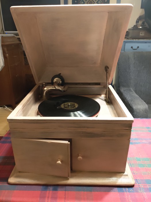

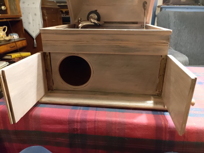

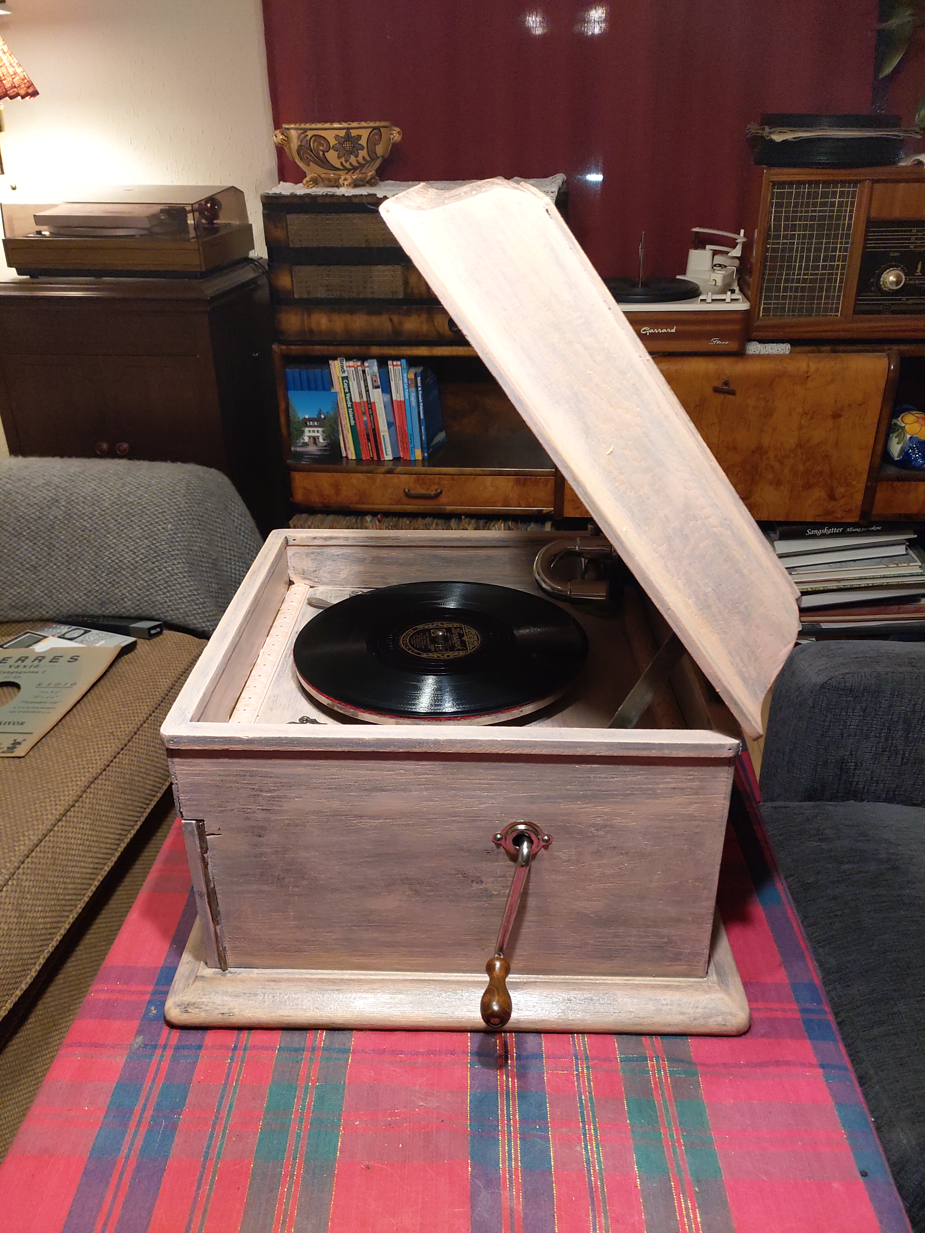

So, here is the end result! Let me present, not the Pink Panther, but the Pink Tabletop Project
I was able to make the motor run, and now it runs without any problems really. After sanding the cabinet down totally, two layers of "old pink" wood stain, and three layers of shellac politure were added during the last two days. Hate it or love it, it really doesn't matter to me, so feel free to bash or smash it if you want.
I kinda like it myself, for sure it looks different, and well and to me it looks far better now than on the photos taken of the machine at the start of this thread. If a machine like this had been made today, I believe pink versions would be found. Maybe...it also can bring someone new to the hobby too, who knows, because it will be sold, when a suitable owner sooner or later is found.
