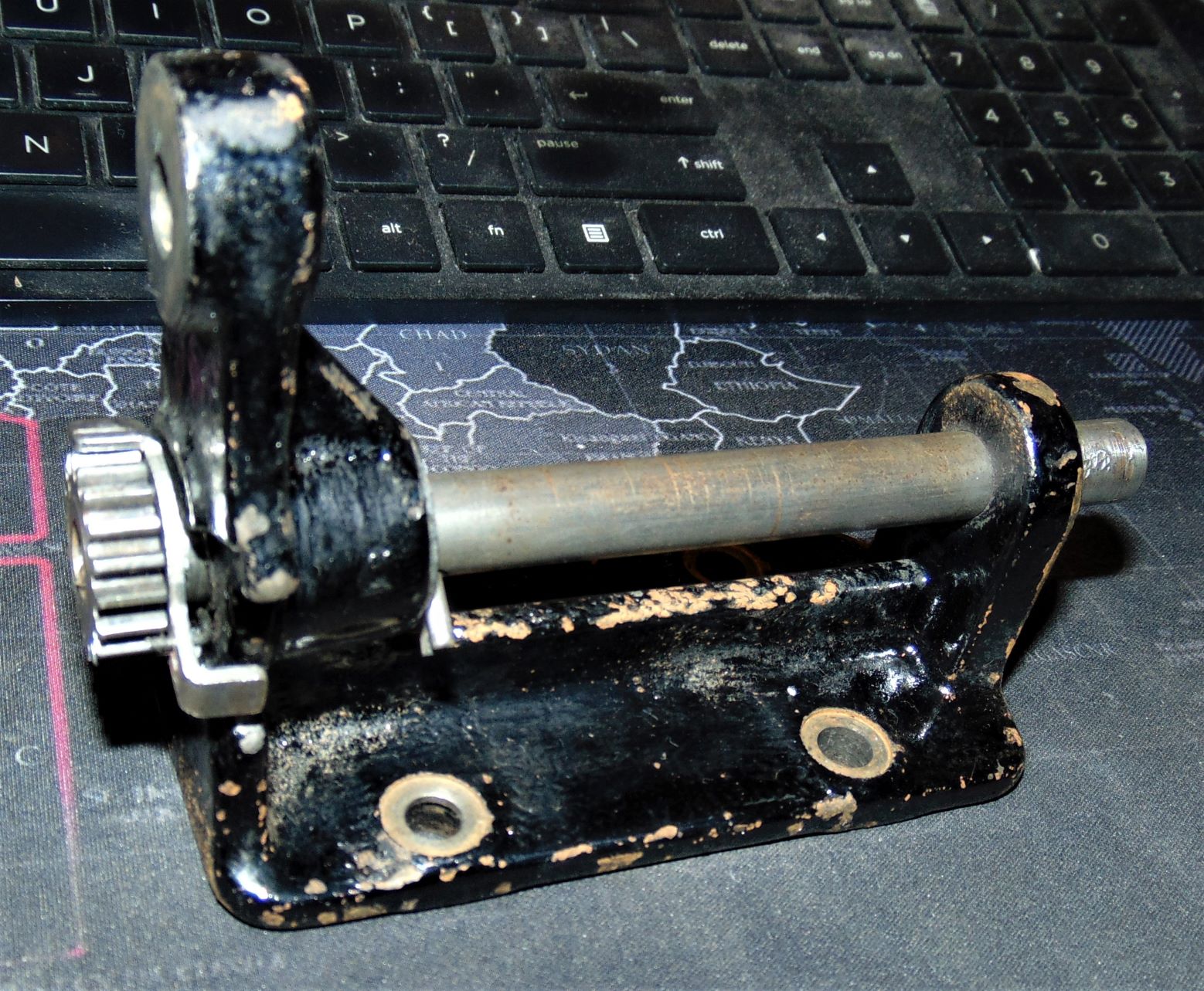

Does this look like the part you need? It does work, I took it off a working motor tonight, but I have no use for it. The spring on the winding pawl is good and it turns smoothly, but could stand oiling. I just washed it off some with a little bit of lye and if you are going through the whole thing, it could stand a coat of paint as you can see... Anyway, let me know what you think. Regards, Earl.
AmberolaAndy
Posts: 2423
Re: WANTED: Winding pawl for Edison B19
Post by AmberolaAndy »
EarlH wrote: Wed Nov 17, 2021 8:32 pm Does this look like the part you need? It does work, I took it off a working motor tonight, but I have no use for it. The spring on the winding pawl is good and it turns smoothly, but could stand oiling. I just washed it off some with a little bit of lye and if you are going through the whole thing, it could stand a coat of paint as you can see... Anyway, let me know what you think. Regards, Earl.
Why yes it is sir! That’s what I need.
