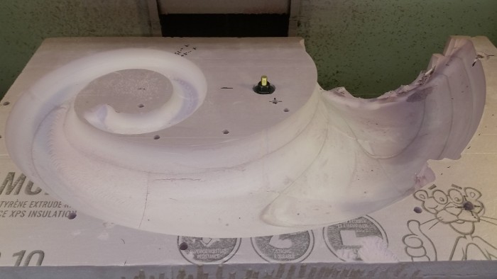

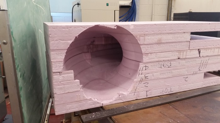

One half of the oyster is milled, though with flaws. This is a learning project, a significant challenge. There are flaws, though given the material is imperfect insulation foam, and this project requires unusual demands on software and the Haas, it still seems promising.
One interesting and possibly troublesome characteristic of the 8" thick block is an unexpected low frequency resonance. I'd never have suspected 8" of this foam could "sing", nonetheless is does when bumped or rubbed a certain way.

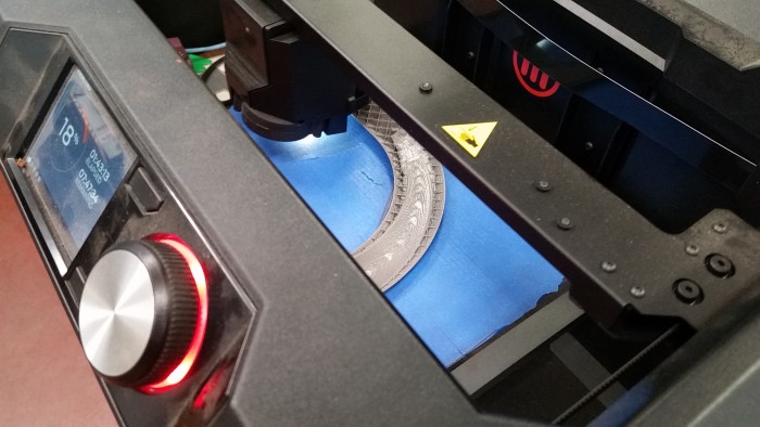

More progress, the second half is started, and one of the throat pieces is shown being printed. The vertical surfaces intersecting the horn opening will be trimmed later.

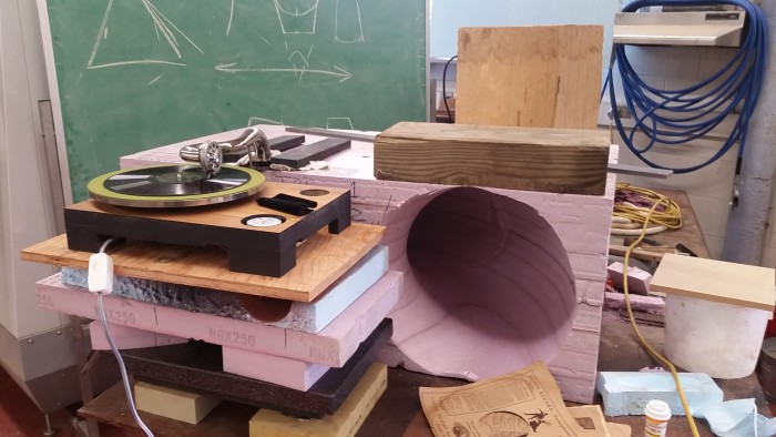

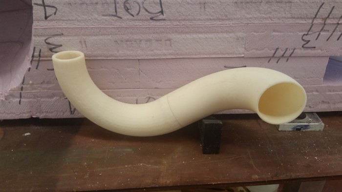

The throat sections are printed and fitted to the foam spiral. The weight on top was to try press the 2 halves together in order to listen to the phone through the horn. While the bass increased, it was not impressive. The phone has insufficient volume to provide any sense of the horn's efficacy.
In designing the throat section I should have reversed the direction of the exit toward the exterior top or bottom of the horn, rather than toward the center. I could print an alternative section to connect to the tonearm, but as the parts are already fitted, I'll probably continue with the existing design. This will require cutting more of the lower block away to mount the tonearm, but that's a quick job compared to printing another section. Each of the present sections required more than 8 hours print time, and the two together required 10 to dissolve the support material. They were printed entirely "entombed" to provide adequate support to maintain dimensional stability.
I'll probably epoxy the throat sections to the block, then spray foam around the sections to fill the rough cavity I carved. There are overcuts and flaws in the horn contour that need filling, then it can be painted to harden the surface somewhat. I may trim some of the excess off the exterior of the blocks before gluing the two halves together. It's all quite rough at present, but will suffice for testing, making it more presentable makes sense. Unfortunately my band saw throat opens to only 14", so I can't trim the halves once assembled, but it can be rough cut and then easily sanded and ground into a more attractive shape.
I think they will need to be glued in order to adequately seal the horn volume.
I'm still thinking of ways to assemble the platter and tonearm to the blocks. This may require a short straight section between the tonearm base and the receiving end of the printed throat section.

It looks nice. I'm sure a tonearm with gramophone soundbox will produce much more air pressure than the phone, and the volume should be quite considerable. For increasing the bass you'll need the external flare you're planning to make. The bass capacity of the horn depends greatly on that. A common rule is to end the flare so that its perimeter is at least 80% of the maximum wavelength you want to transmit. Of course the length of the horn goes together with this final size through the exponential law. You will also increase it.
End demi-angle of the flare to the axis is also recommended to be no less than 41 degrees (Wilson). Be ready to make a HUGE final external section with the flare.... For 150 Hz it should have a diameter of 24" at the mouth, kind of EMG IX or Expert Junior?

I cobbled it together today with an Orthphonic tonearm and a platter I "motorized" a few months ago. There are losely connected joints in the sound path, and daylight in places between the halves. Nonetheless, the sound is good enough to warrant continuing with the project. This will require filling a few areas in the spiral, cutting down part of one block to shorten the straight section between the tonearm pivotting flange and the 3D printed sections, then painting the spiral contour, and at last gluing the halves together to eliminate leaks. I continue to puzzle over the exterior. It goes without saying it can be made more attractive.
I recorded the cobbled assembly playing various records, but have had difficulty posting the video to YouTube. I live in an area with poor internet service, my slow connection all but stalled uploading the video. I'll try again when I have access to a faster connection, and provide a link. Listening was informative.
The current mouth is ~16" in diameter. No doubt the 24" x 31" dia. extention might make a significant difference. I'll decide whether to make it after hearing the current asembly completed.
