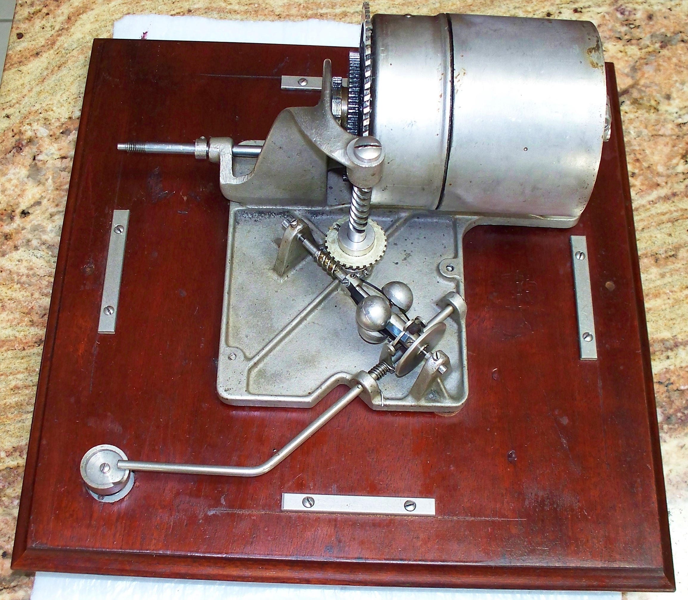

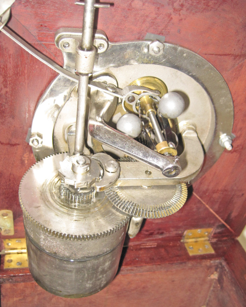

Blizz,
To answer your question, yes. There are two types (see attached) of all nickel plated motors used during the Victor 6/VI production. Also, the early "spur" gear motor uses a ball bearing race under the table. The later "spiral" gear motor uses a spindle cup under the table. Unfortunately, the YouTube video is inaccurate.
Early Victor 6 Motor.jpg (250.12 KiB) Viewed 1125 times

Wow great stuff... thanks for the information... I now see that one motor has a slotted crank and the other appears to be a ¼" threaded crank.

fmblizz wrote: Wed Nov 24, 2021 2:29 pm Wow great stuff... thanks for the information... I now see that one motor has a slotted crank and the other appears to be a ¼" threaded crank.
I appreciate all this information.
Blizz
That is correct regarding the crank connection change.
