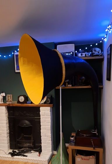

Introducing Maurice the giant horn. Maurice is so big, you can get a couple Edison Gems in a stable orbit around him :D
Maurice is my first attempt at building a horn. He is built to Wilson's exponential horn formula, measuring just over 35" (~90cm) in diameter, with a total length of 7' (~2.1m).
It is an experimental project which has been bubbling away in my head for some time. The whole process from research & planning to the actual build has been incredibly rewarding, with a lot of learning throughout.
You will notice it is made up of two sections so it can be taken apart to pass through doors/get in the car. As for details of the build, I shall stick to my story that it was propagated from spores :geek: :lol:

Very nice! what is the material it is made of?

Yes, please tell us some more.

Cheers. It is a composite, but that's all I'm happy to share publicly at the moment :)
