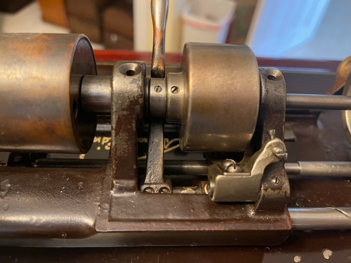

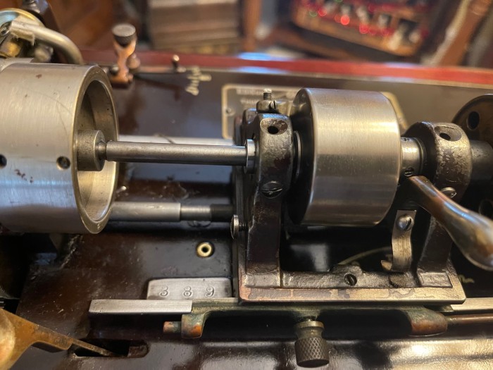

This Edison Opera, SN. 339, has a problem I've never encountered before. It works just fine until it gets about 85% of the way through a cylinder, and then stops traveling. A little pressure on the half-nut, or on the engagement lever, will allow it to finish the cylinder.
With the machine off, and the engagement lever down, it will still allow the half-nut to move over the feed screw in this range; once it gets further along it "locks on" the way it should.
My first instinct was to increase the pressure on the half-nut they way one would do on, say, a Triumph. But the whole arrangement is different, and I'm unsure how to attack this problem. Rather than adjust first and ask questions later, I thought perhaps the experts here can offer some advice.

I read your question with interest. Could it be that the feed screw has "dirt" in it at that point? I would check this first. Maybe the ½ nut is worn. also.

Thanks, but I've cleaned and examined the feed screw, and it looks just fine to me. If the half-nut is bad, why would this only occur at one end of the feed screw? And it’s not just one spot on the feed screw, it’s the last 15-20%.
Also, the normal adjustment screw for half-nut tension is fully backed off and there is no way to easily increase half-nut pressure.

I'm shooting in the dark here, certainly not speaking from actual knowledge, but a thought occurs: could the problem be that the feed screw isn't quite perfectly parallel with the rest of the mechanism, say because of a misadjusted or worn bearing somewhere? If it slopes slightly down from start to finish, the half nut eventually might stop making sufficient contact. One other thought is that a opera's mandrel moves while the reproducer is stationary; could something in the mandrel end of things be binding?
I wish I could be more definitive than speculative, but I hope these ideas may be useful.

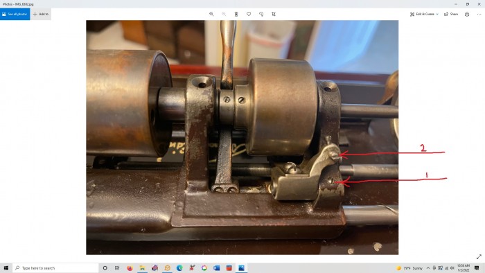

Problem apparently solved. The set screw #2 apparently is used to relieve pressure of the half-nut on the feed screw. I noticed that there was no contact between this set screw and the casting; thus it was at it's maximum position and could not be backed off any further, thus no further pressure could be exerted on the half-nut. Just below this set screw is yet another set screw, #1, that controls the positioning of the entire piece on a shaft running through it. I backed off on it, and tapped the assembly so that it would reposition itself on the shaft. Seems to have worked, have played a cylinder all the way through several times and it's not skipping.
