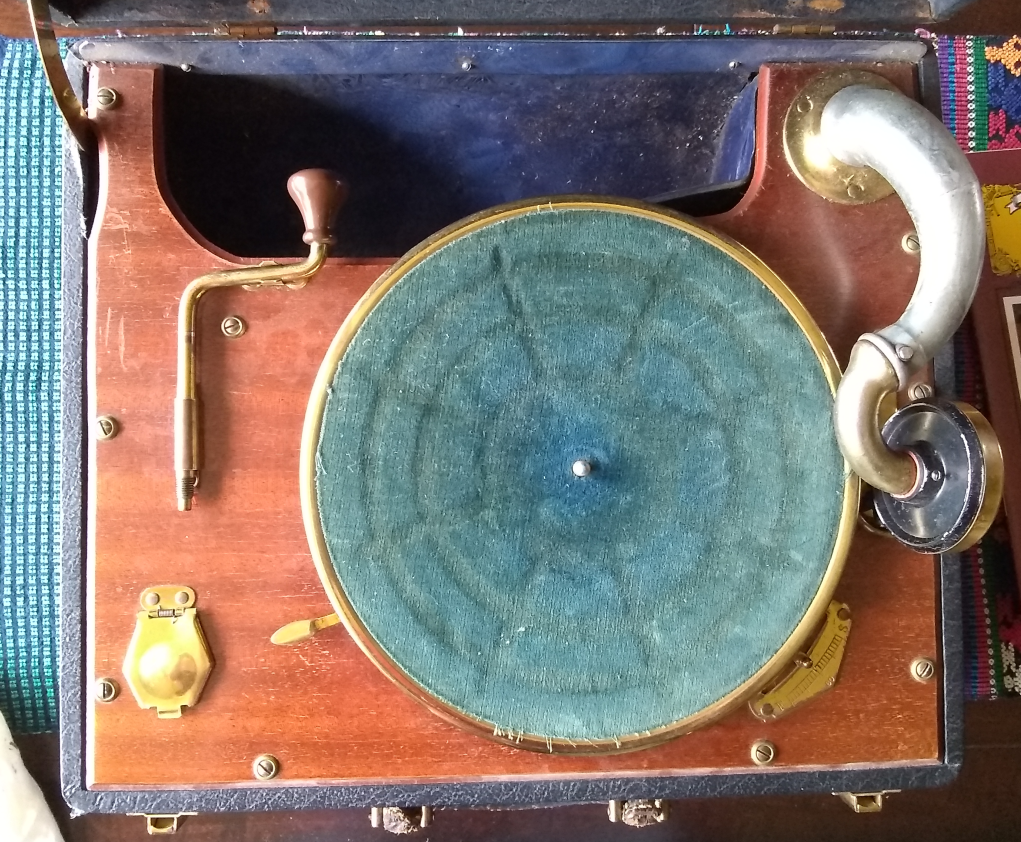

Motorboard and Details
There is an RCA Victor, Montreal, label with a serial number pasted to the motorboard. There are two sets of paint stencilled numbers, one near the RCA Victor label and another single digit beside the aperture for the speed control. I am wondering if the stencilled numbers might be date coding 012041 4 - December 4, 1941? Only speculation ...

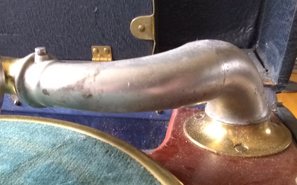

Tone Arm and Reproducer/Soundbox
The front piece of the tone arm, the gold plated part, rotates at the joint with the bare pot metal part, up for play, down for storage in the retainer. The reproducer rotates slightly, but I think this is only because its set screw needs tightening a little. Changing needles is a little awkward. The rubber gasket/bushing in the socket of the reproducers is old and flaky. The base of the tone arm appears to be riveted to the motorboard, which might make servicing awkward.

Re: My New RCA Victor Portable
Platter and Crank
The cloth on the platter appears to be entirely original and is excellent condition. The crank is threaded and must be screwed into the winding shaft for the motor and then unscrewed to remove it. The stamping on the bottom of the platter was mentioned above.
