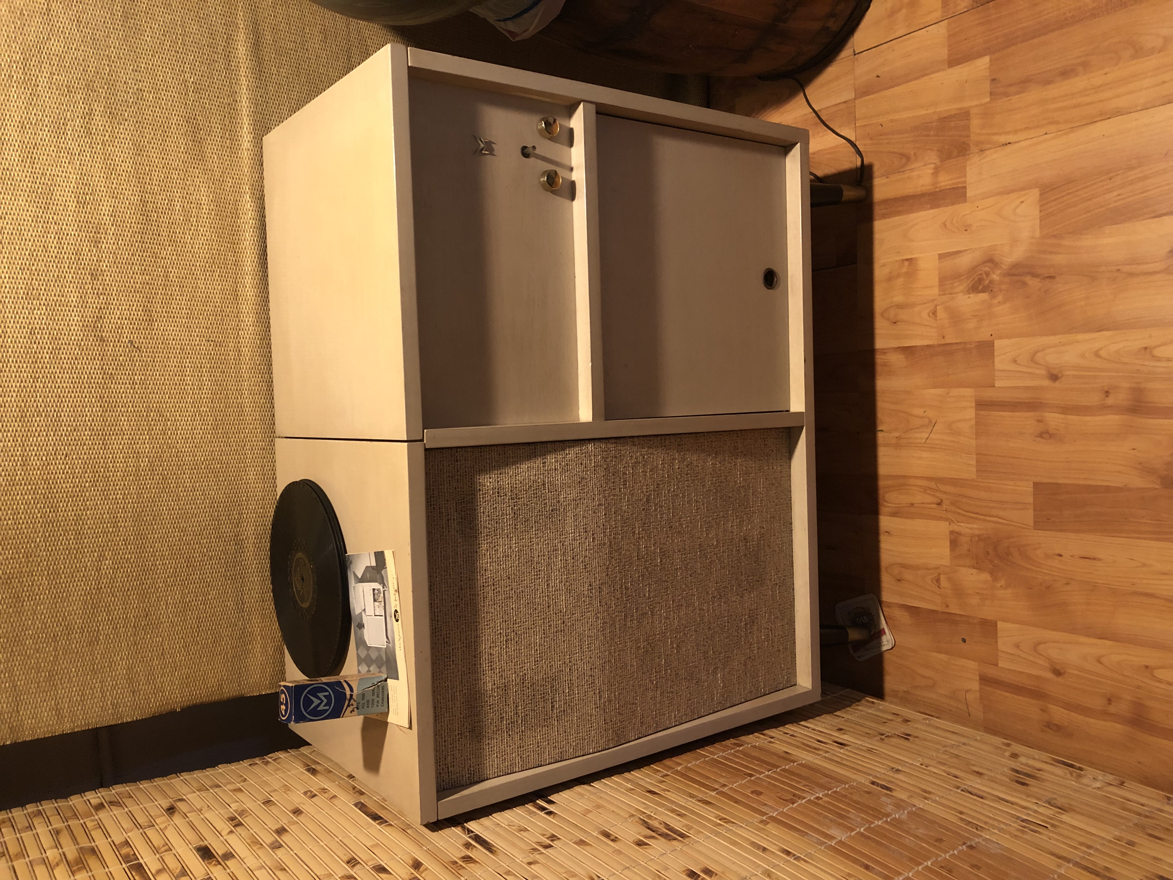

A bit OT: We have a huge 1958 Telefunken console in the living/ "rumpus room". Maggies from the 50s- 60s are wonderful as well. I just picked up a 1954 Voice of Music 565A "Fidelis" mini console "Hi Fi" in Blonde that sounds just wonderful after a little work. The original 1200a changer functions 100% after cleaning and lubricating, as well as detailing/ polishing. The kicker is that this one has a flocked turntable- and the flocking looks brand new! In fact, I haven't had a really good flocking like this in decades.AmberolaAndy wrote: Sun May 29, 2022 11:53 am For 1945 I’d stick with my console radio/turntable combos like I do with all my records made after 1935. I love my Magnavox and Admiral record changers. I’d like to get my Monkey Wards chairside and Zenith console with the cobra turntable a goin someday. It’s always great to have a vintage console radio with a turntable to enjoy later or more rarer stuff worth money on!
I've been re- learning tube type electronics repair on this and several really nice midcentury portables with changers I will likely put up for sale soon. The V-M is a keeper, though, I think.
