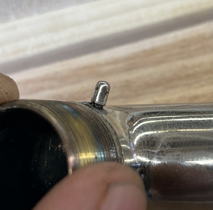

Two more repairs, first one being the pin that keeps the soundbox from flopping back too far when changing the needle. I first peened the surface around the loose pin to help close up the slightly enlarged hole. A piece of steel rod held in a vise was the anvil, and I used a tiny round punch, working carefully around the pin to push the metal back in place. I then used the same silver solder from the inside to re-attach the pin and got the result in the picture.
To fix, I used a piece of wood under the pin, and held the arm section with a rag, and heated again from the inside with the soldering iron, pushing the pin back flush with the surface of the arm tube. Final repair looks good, but I forgot to take a picture of it.

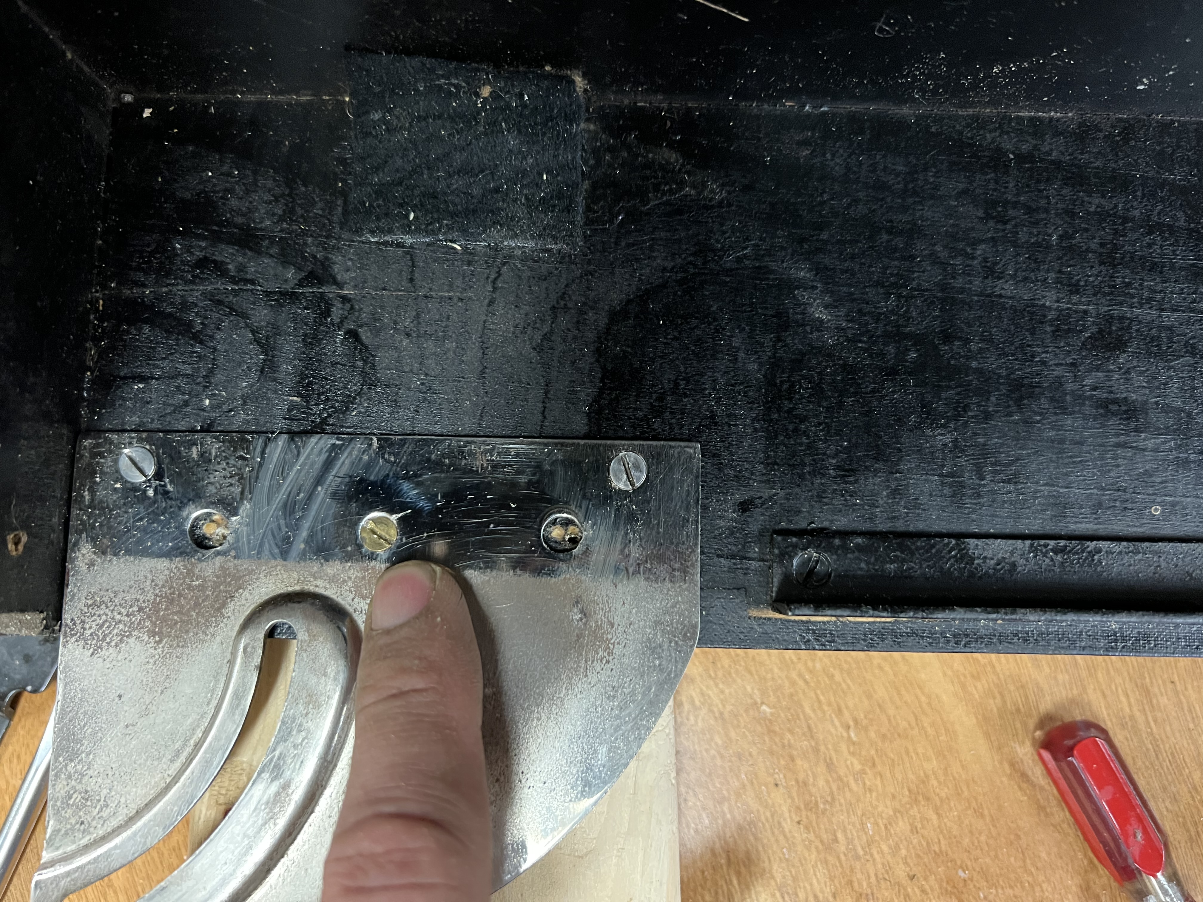

The last thing I did while installing the hardware on the case, was re-drill holes that were loose, after plugging the old holes earlier in the morning. I dripped some thin easily flowing super glue down in the holes I did not re-drill in order to reinforce them. For some reason the third screw that holds the plates was not originally used, so after finding a suitable replacement in a box of random hardware I rescued some years ago, I drilled a pilot hole and added the third screw to the plate. This plate helps focus the sound, but most importantly it is used to support the lid when it is opened and the tone arm when it rises up with the lid. I figured the extra screw could only help keep this part of the case stable and sturdy.
The 112a is now back together and working beautifully, after sitting for almost two years waiting on a replacement hinge. There are a few more minor issues to deal with, but those can wait for now.
