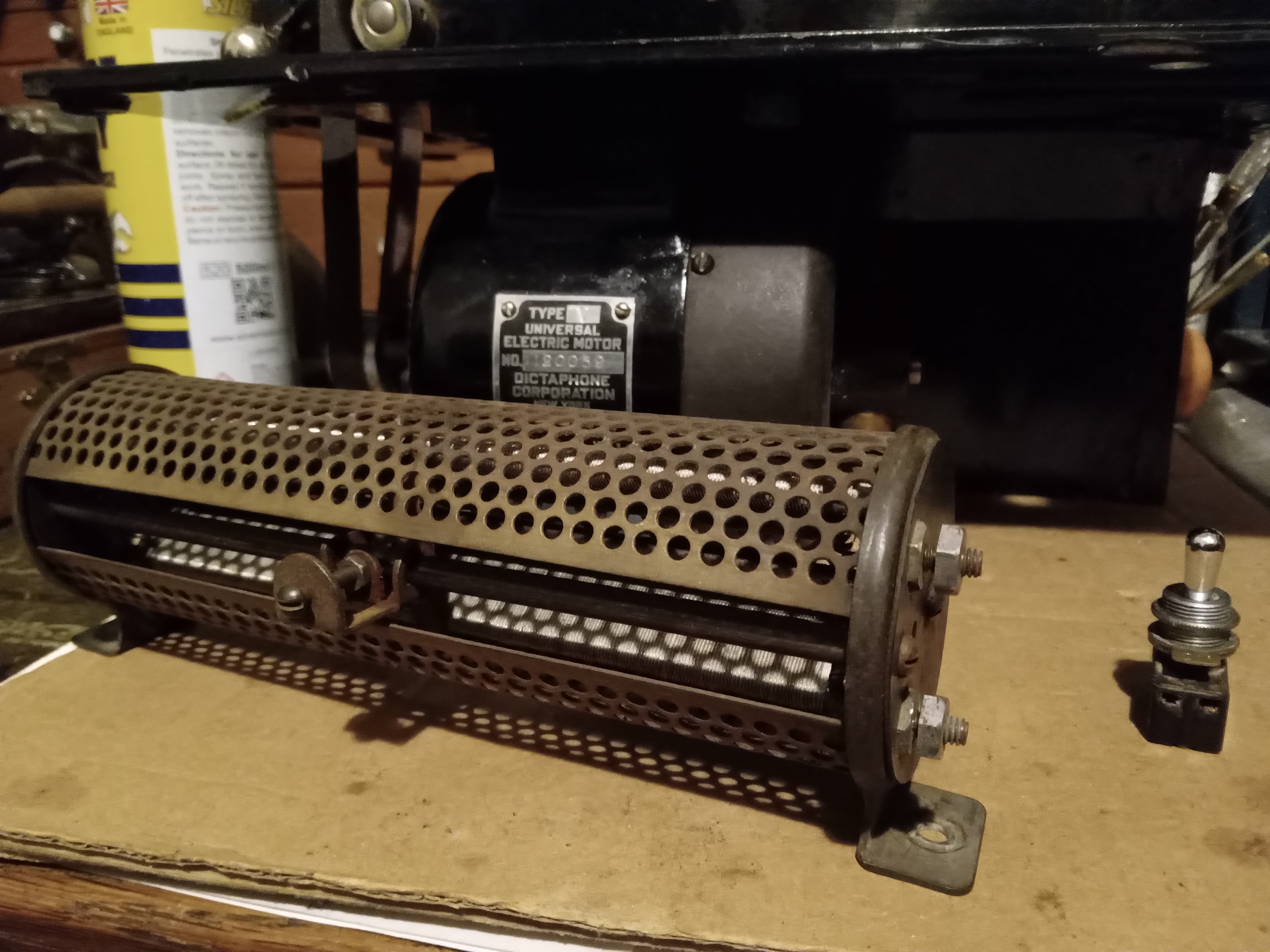

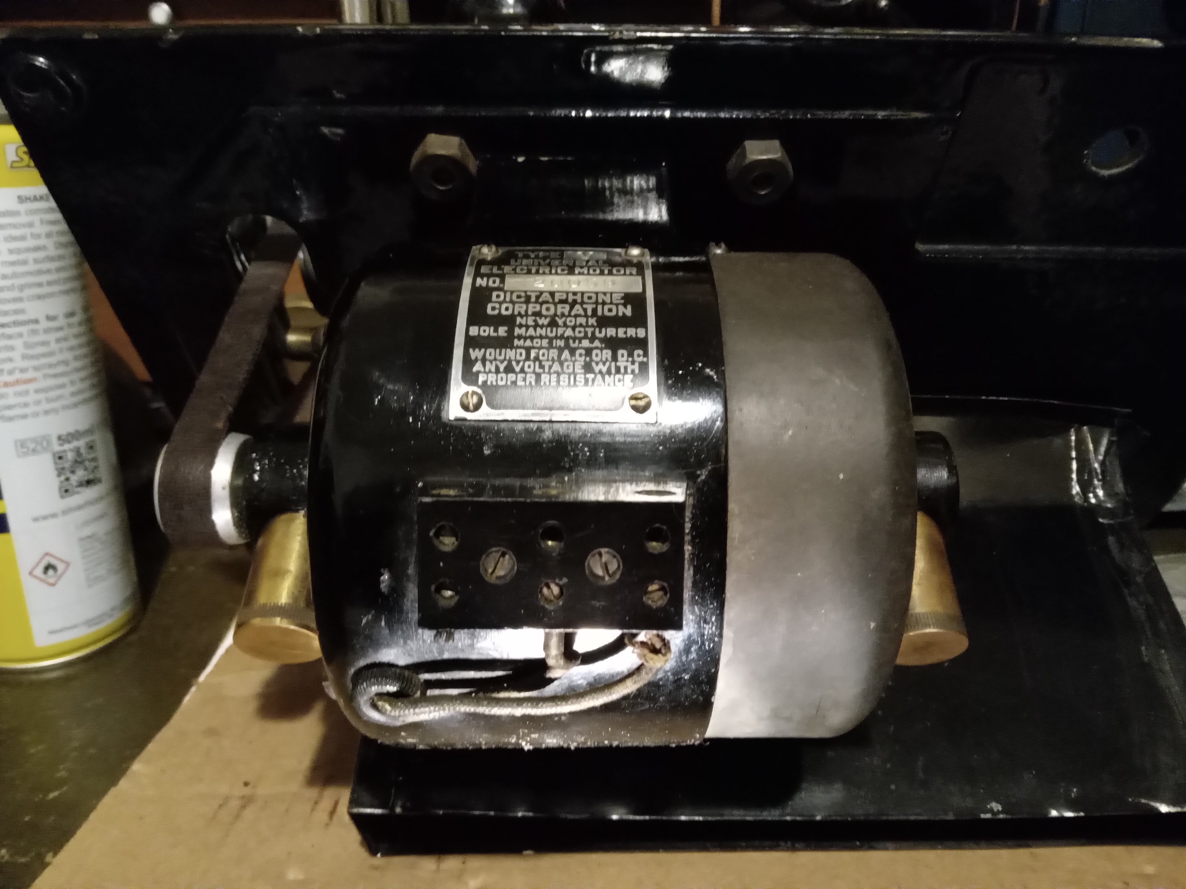

I attach pictures of the 'Resistor' (which has continuity) and motor.
There is no spec plate on the motor just what is visible.
I am guessing that the setup is for 240v as I purchased the shaver in the UK.
OnlineJerryVan
- Posts: 6825
Re: Edison Universal Motor: Model 7 Shaver
The resistance appears to be adjustable. I would hook everything up, except for the motor itself. With the shaver plugged in and turned on, use a voltmeter to see what voltage you've got at the motor leads. I would hope to see 32V, which should be safe bet for that motor. If not at 32V, I would adjust the resistor, (with the power off!), until I see 32V, (when the power is on). Then, hook up the motor and see how, or if, it runs.
Needless to say, be careful!
