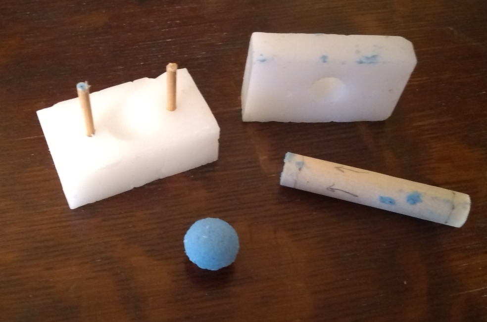

This is my first and botched attempt at fabricating a OoGoo foot for my HMV 102.
The mould is made using paraffin wax. It is -6 C here and my workshop is unheated. It was a bit challenging cutting the paraffin as it was quite brittle.
What went wrong?
1.
I used an inappropriate silicone. All tutorials say that clear Silicone I (100% silicone) is absolutely necessary. I could not find this in stores near me. I used something that said it was Pure Silicone. It was also white. It sort of worked but not all that well. It had a very slow curing time, and the result is a bit too crumbly.
Also with a white base, it was hard to get a darker colour density.
I used acrylic paint. Some tutorials say you cannot use acrylic paint, only enamel. Others say it is OK. Others say to use food colouring. The acrylic paint, if it was a problem, was the least of my problems here.
2.
Also in my haste and uncertainty, I put the top of the mould on upside down. The top is made from the first cut I took off the paraffin block. Its base and sides are roughly square with each other. Its top which is the factory end of the block is not. Putting the top on upside down resulted in the shank of the foot being out of alignment/centre.
Conclusion
Anyway ... this serves well enough for a proof of concept exercise. Next time ....
